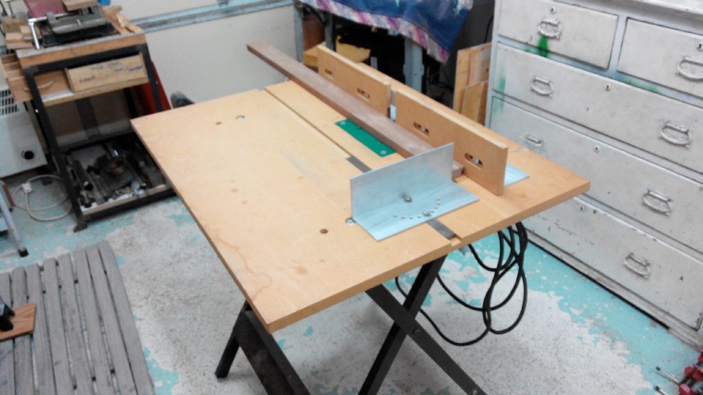

                            I made this one some 20 years back. It folds up to fit in the back of a car as I was using it to work on my boat at the marina. It takes up very little space when folded. The base is from an "el cheapo" Workmate. It probably took less time to build than converting a table saw. If I was doing it again I would use marine ply rather than MDF but I didn't expect it to have such a long working life.
                            Russell
