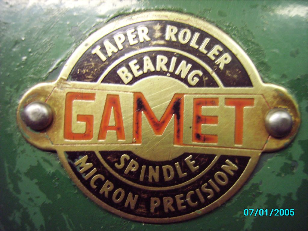

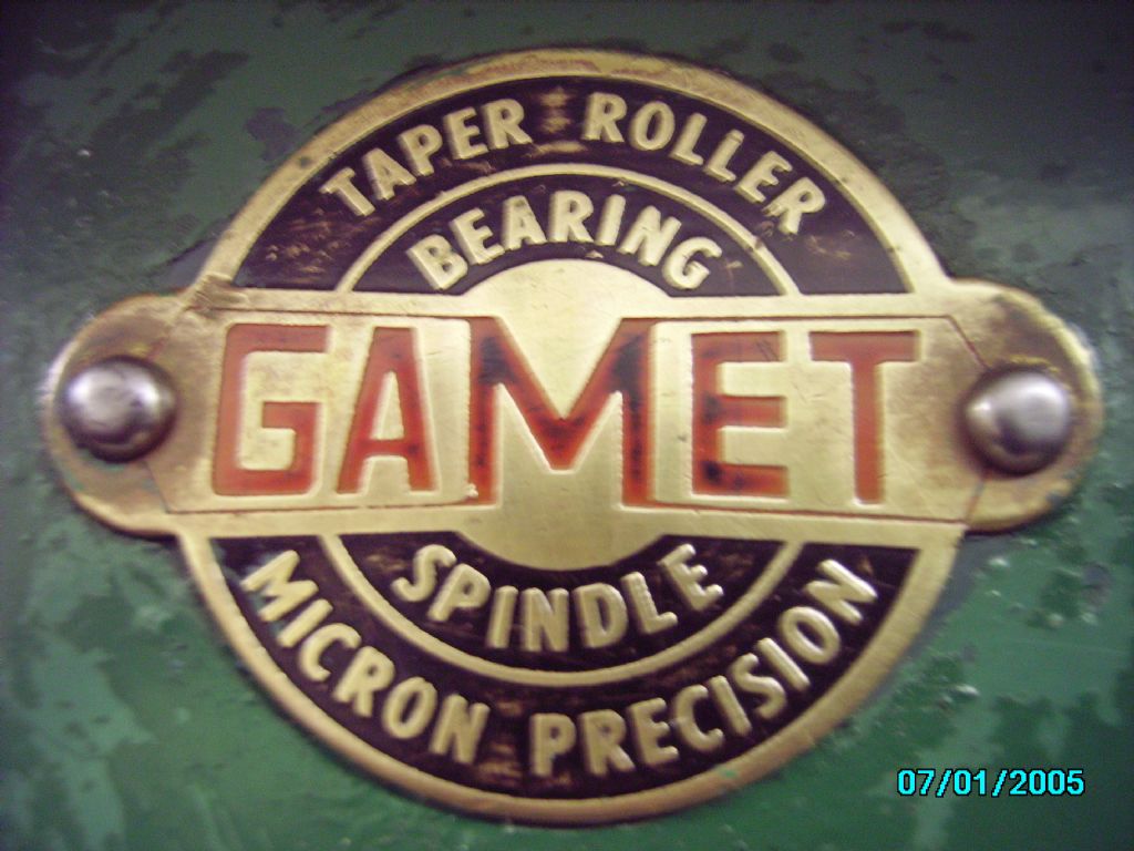

                      I will remember that we like pics on here and I must take some talking about pics I dont know if your lathe has the original "Gamet Bearing" brass plate on the headstock, mine is missing and I have been looking around to see a pic of it but as yet none, mine has the holes for it and the outline of where it has been, I could probably get a copy made up if anyone has a close up pic of it.wink

                        Hi Richard, Will get you a close up pic if the Gamet badge today as I am going to the workshop.

                          Hi Richard, I will post the pics you wanted here, but if you send me a pm with your email address I can post them straight to you if you need the files. I did three because I didnt know if you were going to photo etch and needed a good likeness, anyway, here they are.
