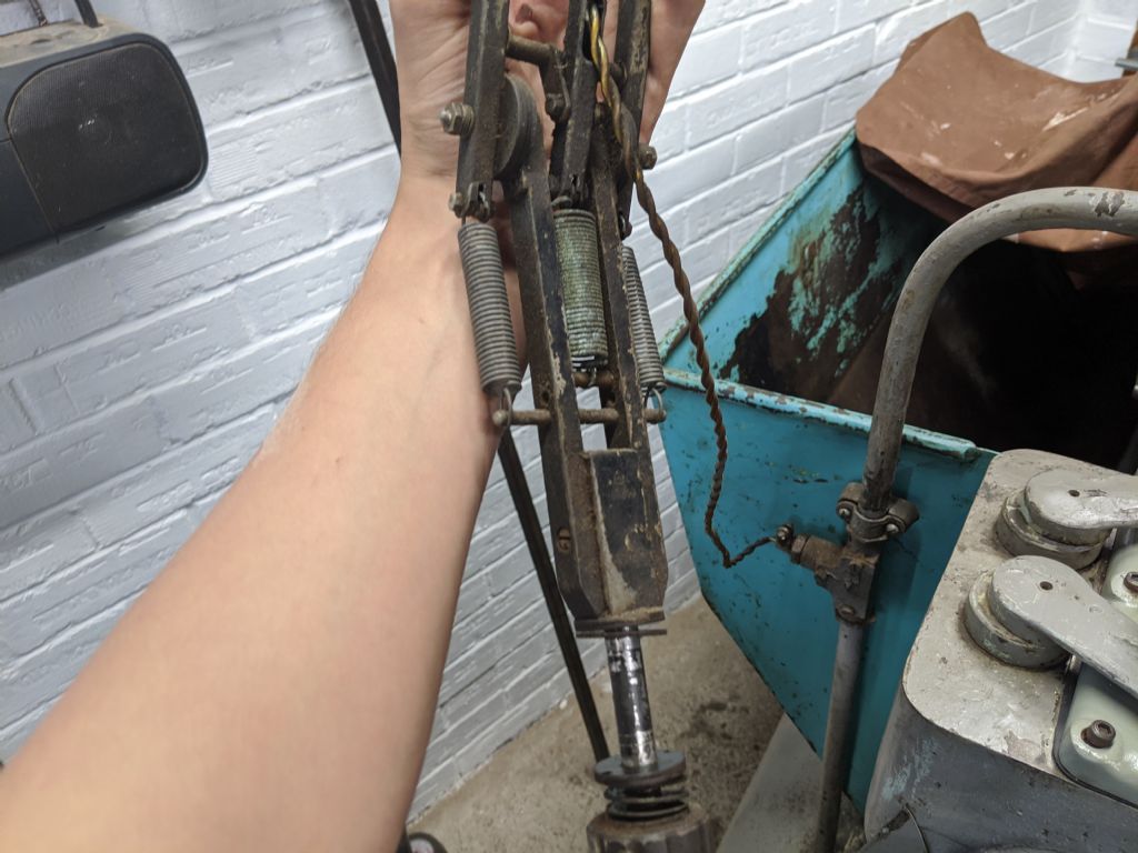

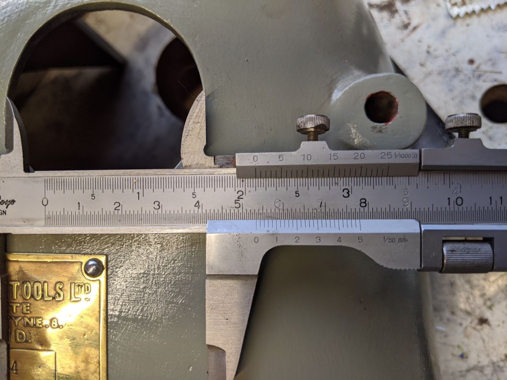

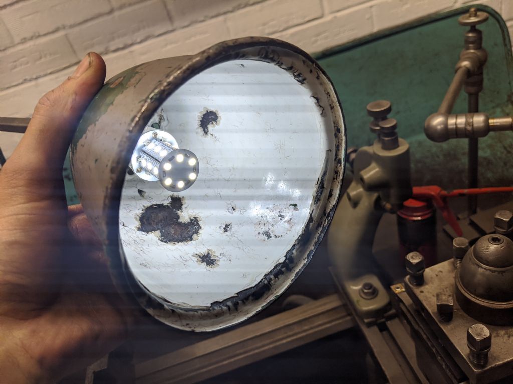

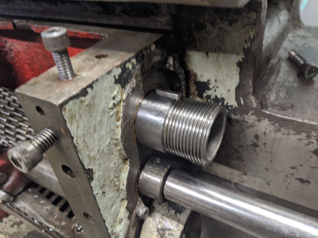

      There are some pictures, I'll get the others tomorrow

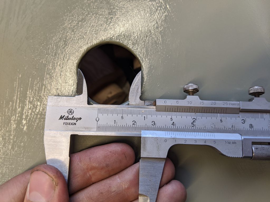

      My hole is not oval, but this means the oiler that pokes through it is not centralised. So perhaps it's just an aesthetic modification to make it look a bit nicer

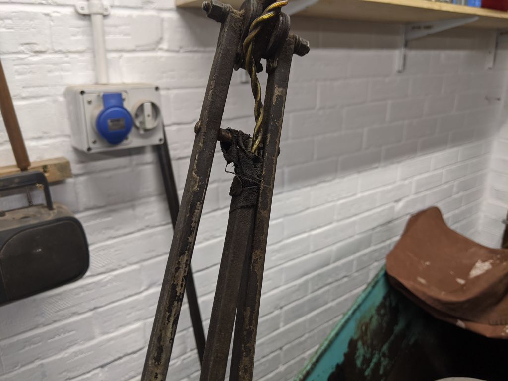

      I'm not sure the lamp is original, but it works for me

        Thanks Richard. I think Phil said your lamp is the genuine Colchester lamp.
        #492457
        Phil Whitley
          @philwhitley94135
          Looking at the springs, and small box section steel construction of Richards lamp, I think it is made by the Anglepoise company, Probably by the Terry spring co who made them under licence The lower part of the lamp is the same as other anglepoise lamps I have, which fit into a cast iron base for desk use. https://www.anglepoise.com/about#product-timeline. Early pictures of the Student Mk1 shows them with this light fitted.  Mine has the later MEM "Memlite", made by Midlands Electrical Manufacturing in Birmingham. the Memlite does not have the advantage of the anglepoise, which moves easily into any position, and stays there!
          MEM Memlite
          Edited By Phil Whitley on 25/08/2020 10:23:39
          #492476
          Herman van der Merwe
            @hermanvandermerwe76509
            Aha Phil, so the Memlite I was given is the time correct lamp for the Student Mk1 I have. Good to know!

                So is my light the original one? I'm not bothered if it isn't. But it's interesting to know.
                My light actually has a section broken, so it could do with fixing. But I don't have time for that right now!

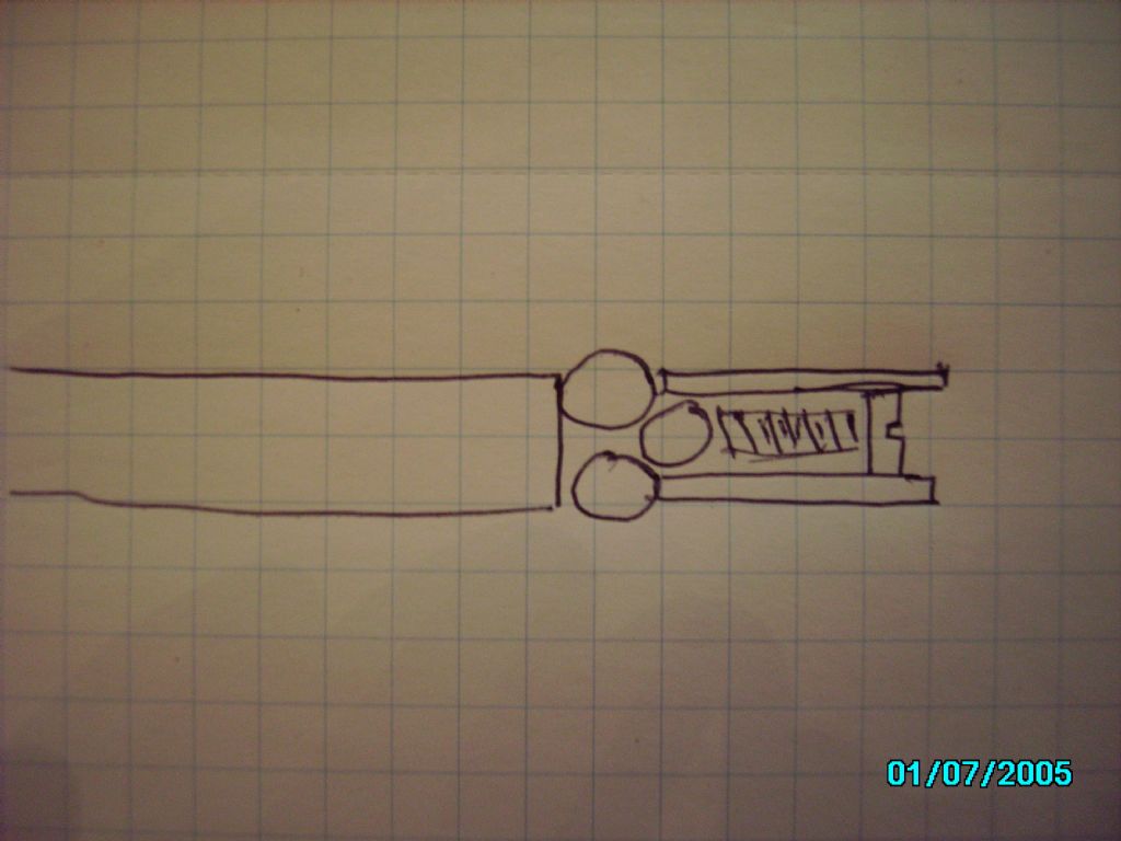

                  #494937
                  Richard Kirkman 1
                    @richardkirkman1

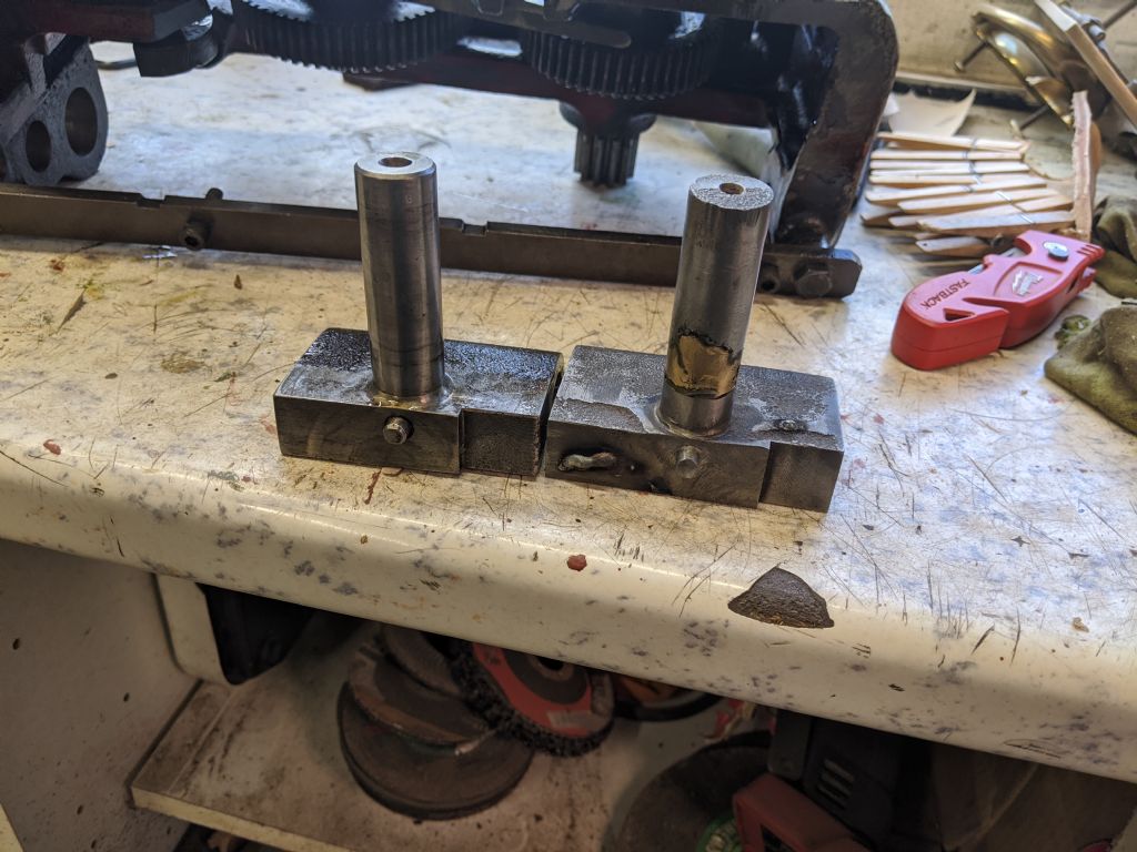

                    Good news, the half nut arrived this afternoon/evening
                    So I'm now in reassemble mode. Problematic since I'm heading back to Hull early tomorrow morning and the grandparents are round tonight, so very minimal time.
                    Half nut came surprisingly quickly, 6 days from France. Better than most Royal Mail services…
                    I can't thank Clive enough. He only charged me for the postage, so it's incredible.

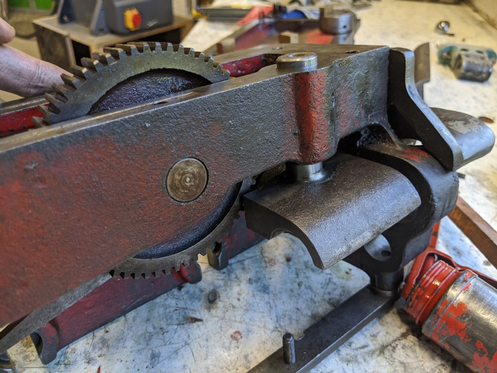

                    It fits. It took me a while to figure out how it went in, since the other one was broken and very easy to remove.
                    Then I put the apron back on, then started to feed in the feed shaft, not forgetting the worm box

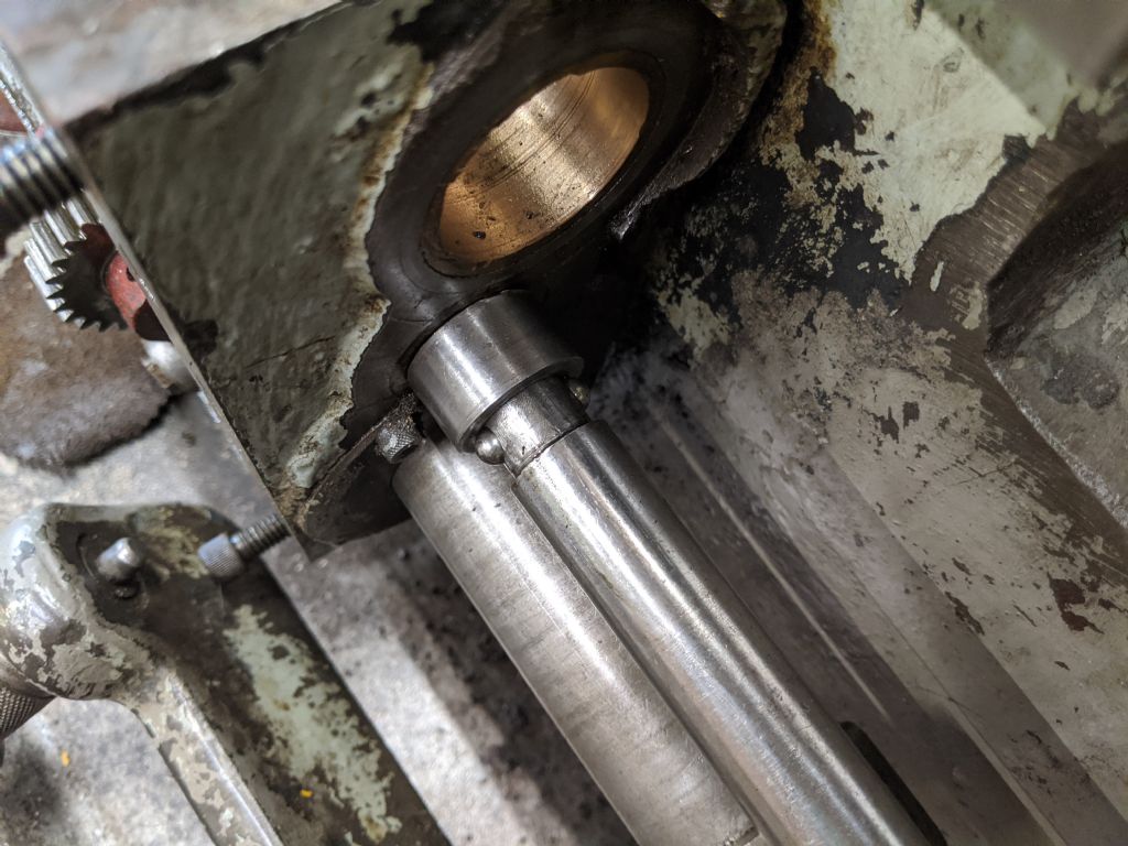

                    And now we have trouble. I've spent about an hour trying to get these balls squeezed and pushed in. I don't have time to get stuck now, so here I am. I fear I'm at a standstill. Does anybody have any ideas how to get these squeezed and pushed. I've tried all sorts. How did Colchester manage? I can't even squeeze them in with my fingers. The spring is strong.
                    I'm aware of the screw in the end to change the tension, but the tension hasn't been changed and it cannot be changed once it's fitted so I'd like to leave that alone.
                    Suggestions would be incredibly useful, but obviously I'm on a bit of a countdown. It may have to wait till I get back another time.
                    The real issue is the shoulder, since I don't have any pliers thin enough to allow the balls to slide in and then have space for the pliers. They just hit the shoulder. Absolute nightmare. Not how I wanted this to go.
                    My long thin pliers won't budge the balls as I can't put enough pressure on.
                    #494957
                    Phil Whitley
                      @philwhitley94135
                      Something is wrong there Richard, I have had my feed shaft clutch in and out quite a few times and have never had any trouble with my balls (fnaar fnaar) There should be three balls, two of which project from the holes in the feed shaft, and a third which presses on the first two, and then you fit the spring and the screwed plug. The amount that you screw the plug in provides the clutch adjustment. If when under load the tool digs in and the feed shaft stops, the balls are forced back into the shaft, allowing the boss to rotate, but not the shaft, thus not mangling any gears. If there is no screwed plug on yours, and a longer spring has been fitted to get over this, you may need to cut the spring down. Is there a thread inside the shaft wwhere the balls and spring fit in?
                      Edited By Phil Whitley on 09/09/2020 19:59:59
                      #494958
                      Phil Whitley
                        @philwhitley94135
                        Please excuse the crap drawing, but like this!
                        #494962
                        Phil Whitley
                          @philwhitley94135
                          Your balls look to be sticking to far outwink If you have only put two balls in and then the spring, the spring may have been forced betwen the balls, hence they wont push back into the shaft as they should!
                          Edited By Phil Whitley on 09/09/2020 20:26:30
                          #494963
                          Richard Kirkman 1
                            @richardkirkman1
                            Yes Phil mine is exactly like that,
                            I managed to get it back in with the help of my brother and a bit of effort. I'd been trying for another hour or so and he came out to tell me it was tea time. It's going back together tonight so there will be assembly pictures later
                            #494965
                            Phil Whitley
                              @philwhitley94135
                              Ok good to hear! the tighter you put the screw in the harder the clutch is set, and the more you risk damage if you get a jam (OBVS!!)
                              #494974
                                Posted by Phil Whitley on 09/09/2020 20:21:37:
                                Yes, this is my first impression as well!

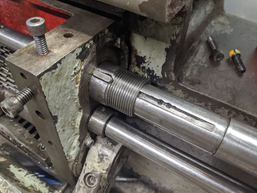

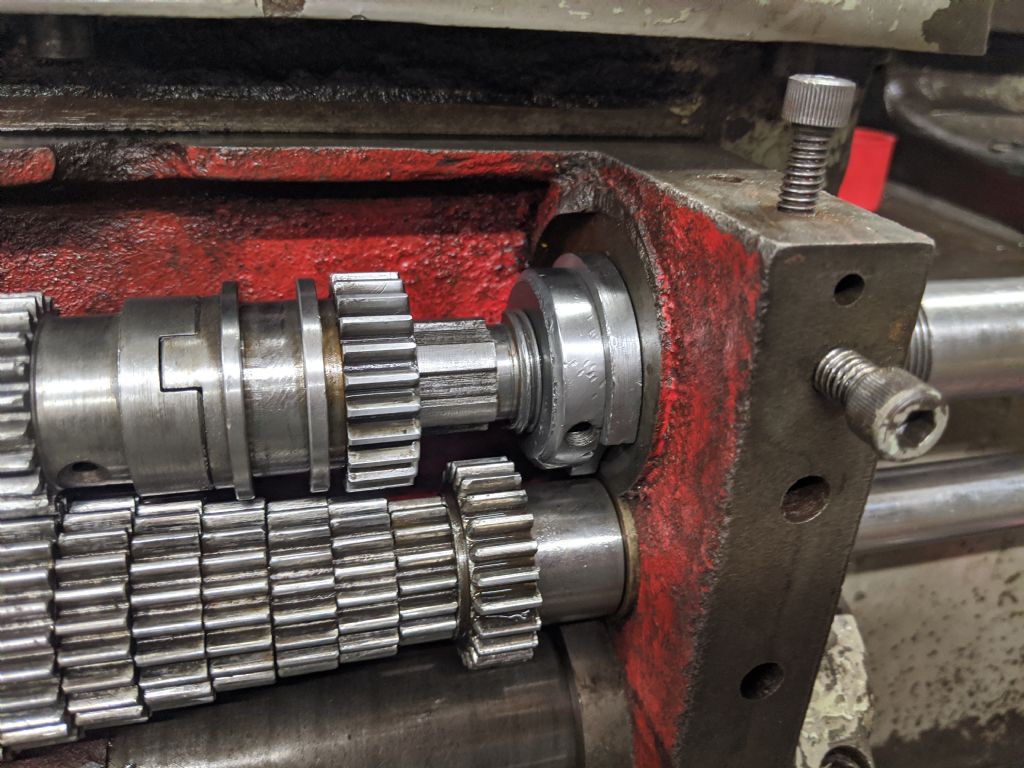

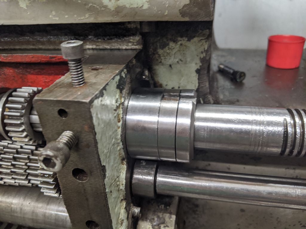

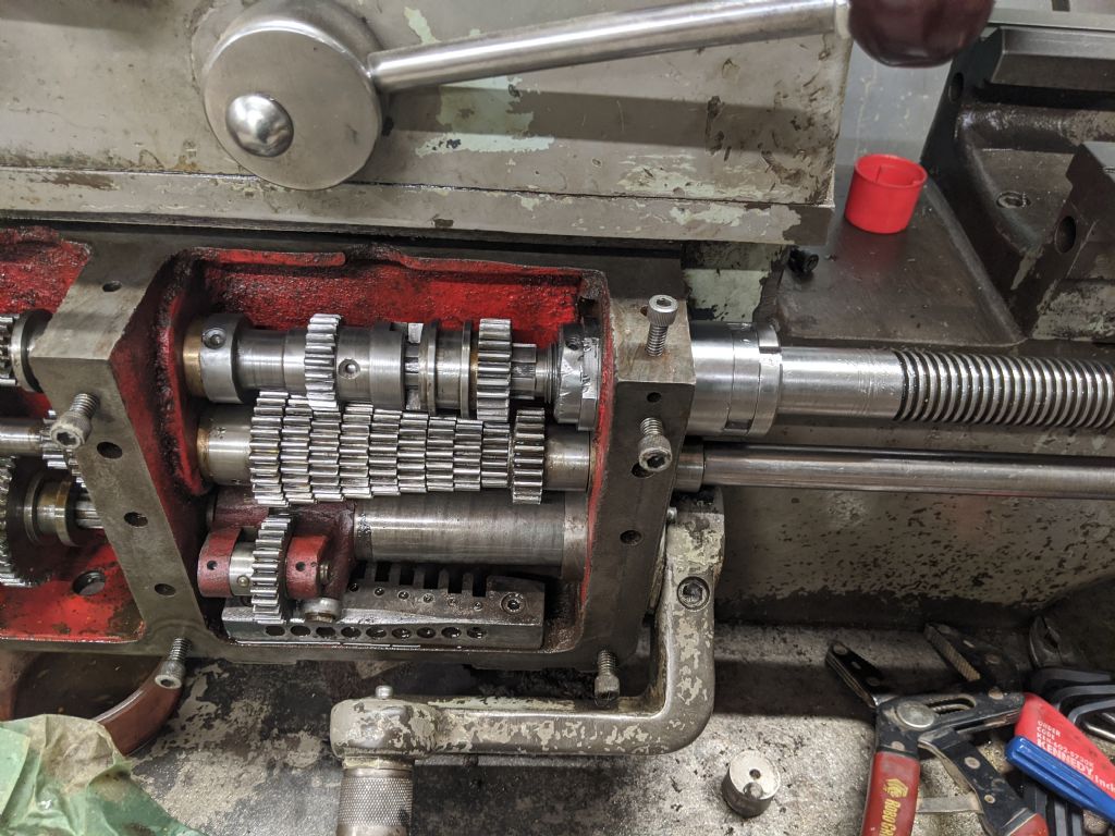

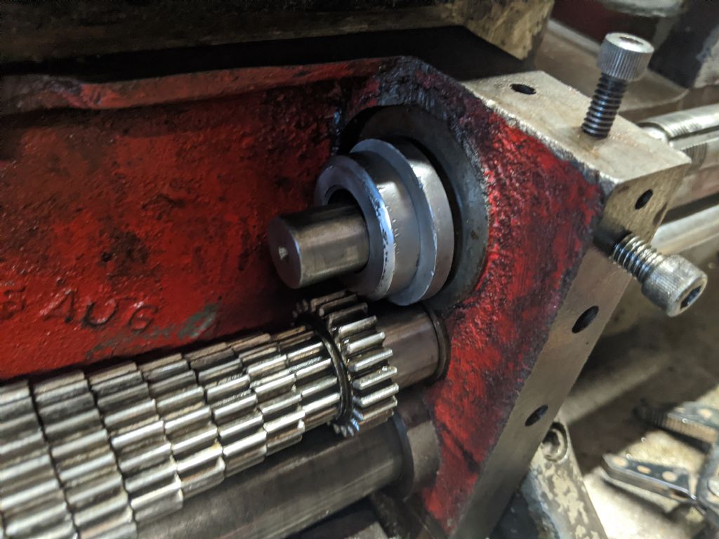

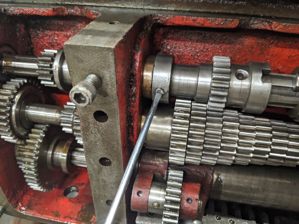

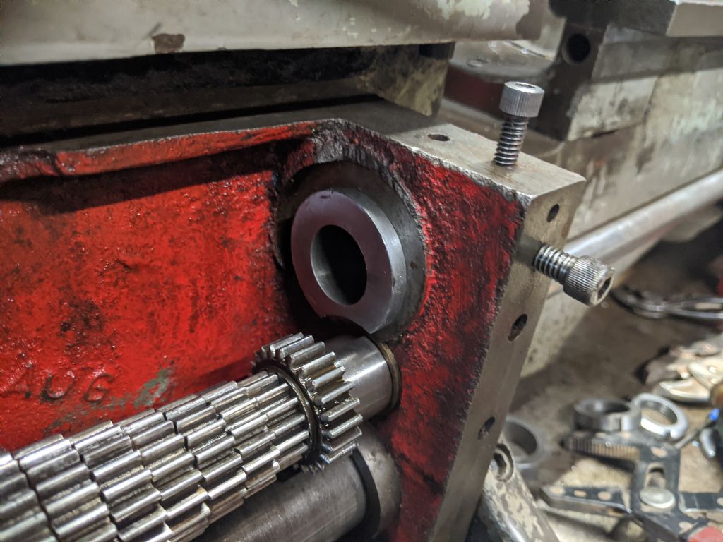

                                  So, very productive. After I sorted out my balls it was smooth sailing(almost)

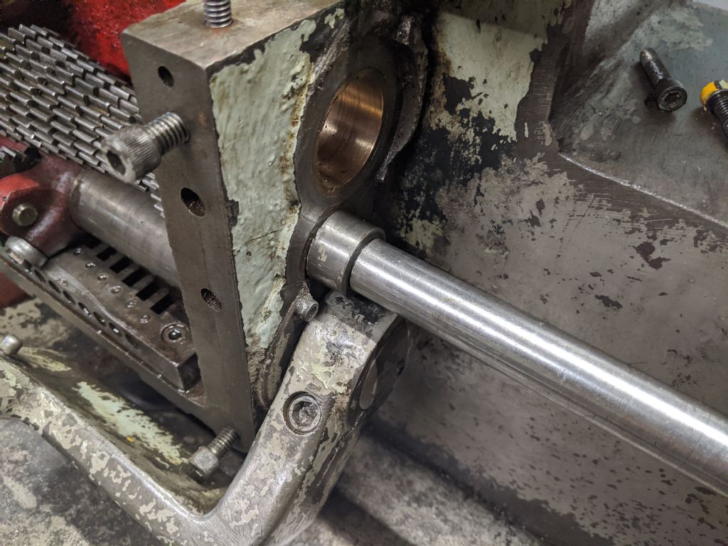

                                  Lots of pictures, in case anyone else needs more detail in the future
                                  Popped this bit in first, then slid the shaft through. Making sure to have the three rings on the shaft once it was through the apron
                                  As the leadscrew was pushed through I put the gears on the end as it goes through

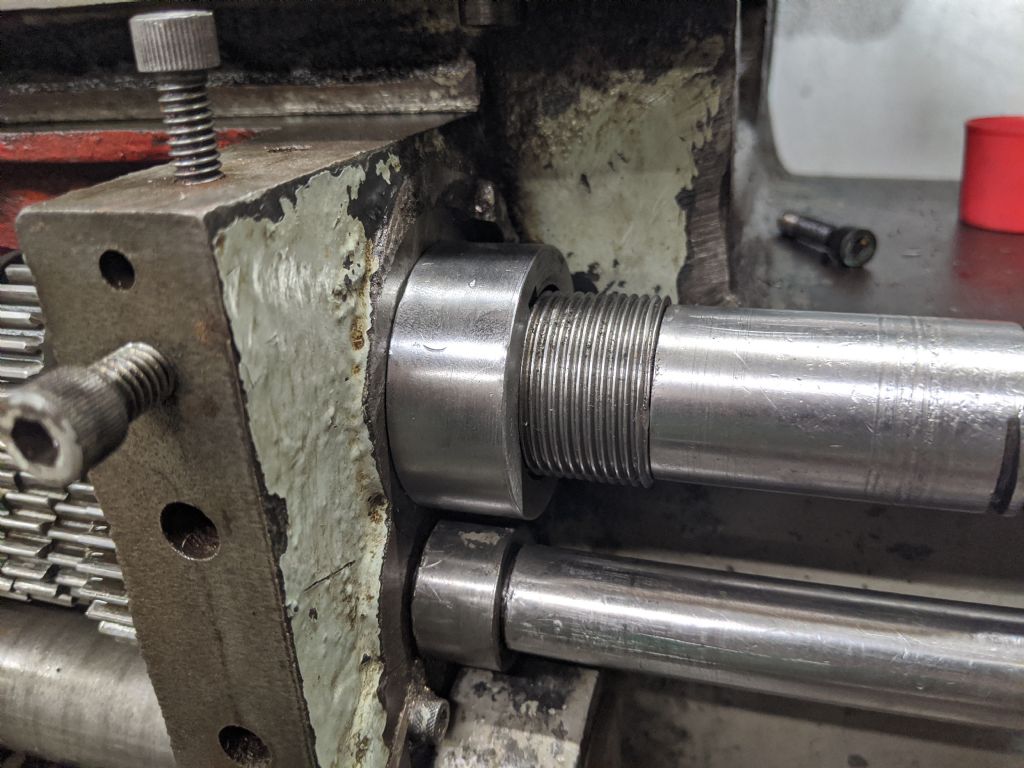

                                  Then as it goes the last few cm, I threaded the collar on while pushing it in every few turns
                                  Then I slid the collar on the other side
                                  And I screwed on the two locking rings. I struggled a bit getting these tight but not too tight as it caused too much friction, significantly. So it took a little bit to figure it out. All sorted now
                                  Then I found the spot that this screw had been tightened onto and fitted it back where it was
                                  All done. They're not as scary as I thought they initially were, but still interesting mechanisms

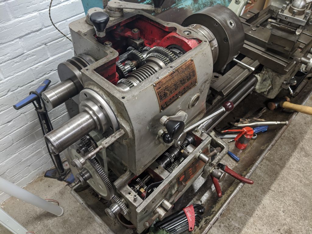

                                  All looking good!

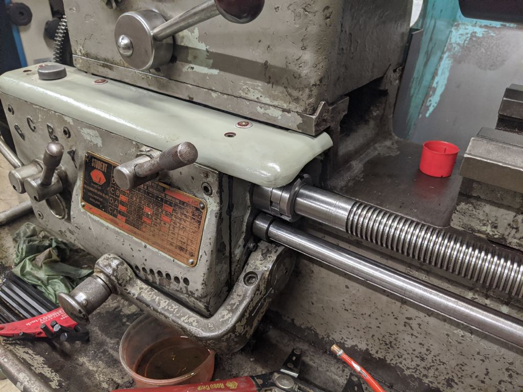

                                  The cover looks a lot better since I filled the corners down. Thanks for the suggestion Phil
                                  Fully reassembled. Different grey on the repainted parts, but I like it. The patchwork is only temporary
                                  As for powering up, the light came on immediately. A good sign. I hadn't tested the new switch yet so I was happy to see that it worked

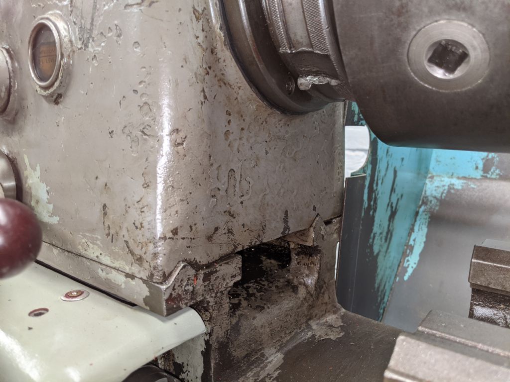

                                          I put mine back together but I'm leaking .. from directly underneath the spindle nose .. I replaced the gasket twice already and still leaking .. wondering if you have any pointers for that area?

                                            Unfortunately seems like I'm also leaking (pictures inbound when I get around to it), so there are hours of fun still to be had. I think I might cut some new gaskets too!
                                            As for leaking from the spindle nose, I only had my gasket leak there when I didn't tighten the bolts enough.
                                            What material are you using for the gasket?

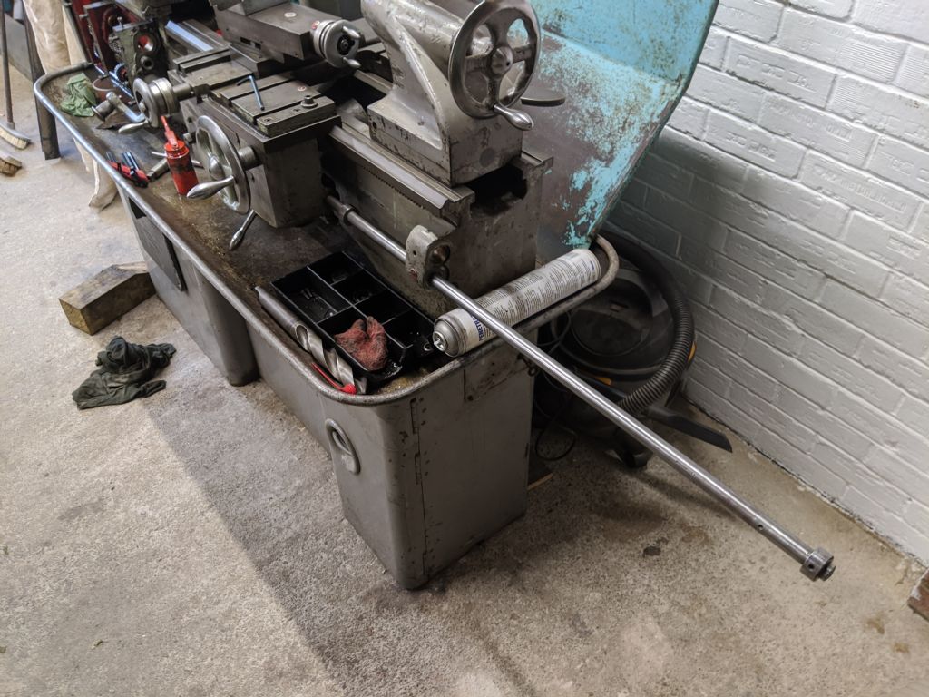

                                                      Looking at the leaks, I'm still not quite sure where mine is coming from. The headstock and gearbox still seem to be as full as I left them!
                                                      Although they are both above the level so I think it may be leaking out of the end of the spindle. Hopefully this will stop when the level reduces.

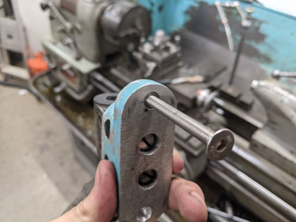

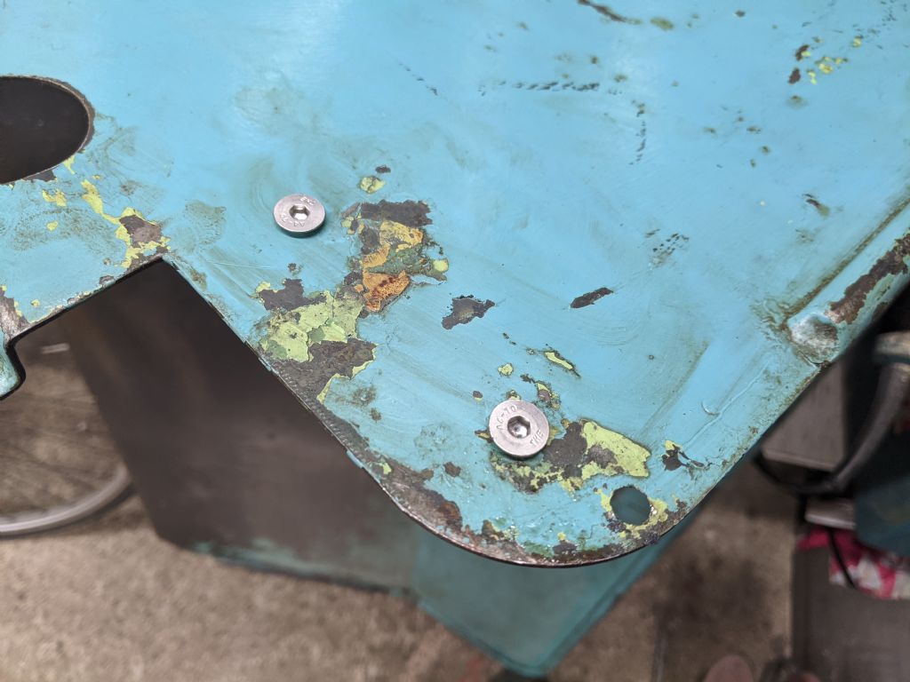

                                                      And then I decided to make the mounts for the light to mount to the backsplash.
                                                      I enlarged the holes in the mount so that the mount can use a m6 thread and still have enough meat in it
                                                      Turned some steel plugs with thick heads so I can cut slots in
                                                      Tapped to M6 so it can use the countersunk head bolts I have
                                                      The long M6 bolts, which have been cut down now.
                                                      These will go through the other side of the backsplash, so the holes will be countersunk until the bolt heads are flush, so the backsplash can still be mounted nicely.
                                                      I'll finish mounting it tomorrow
