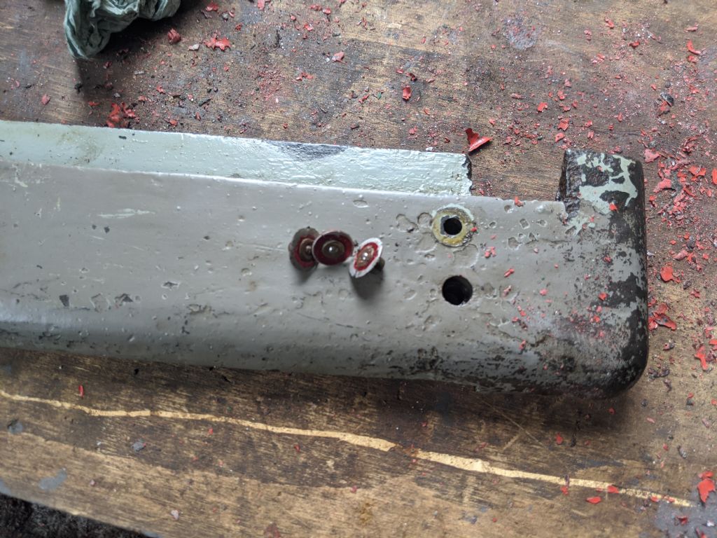

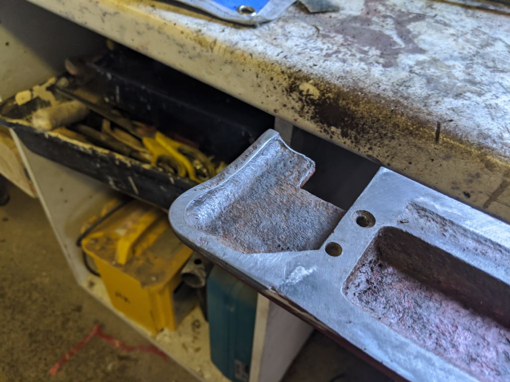

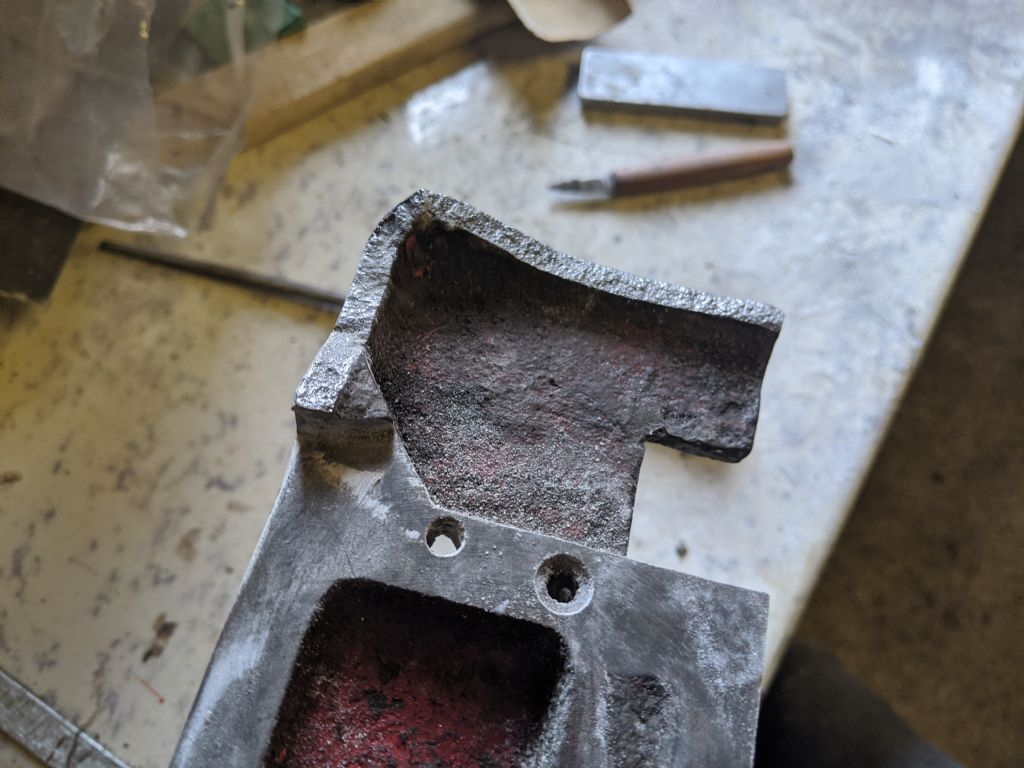

                        I stripped the threading gearbox lid today. My one is broken, but I don't plan on replacing it. Unless I find someone breaking the exact same model at some point in the future, since these lids vary in shape.
                        Removing the oilers was quite easy. I have some that are broken, not on this part. Is there a place to buy the oilers with the red aluminium discs too? Or should I just remove all the discs, they're looking quite tatty and worn.

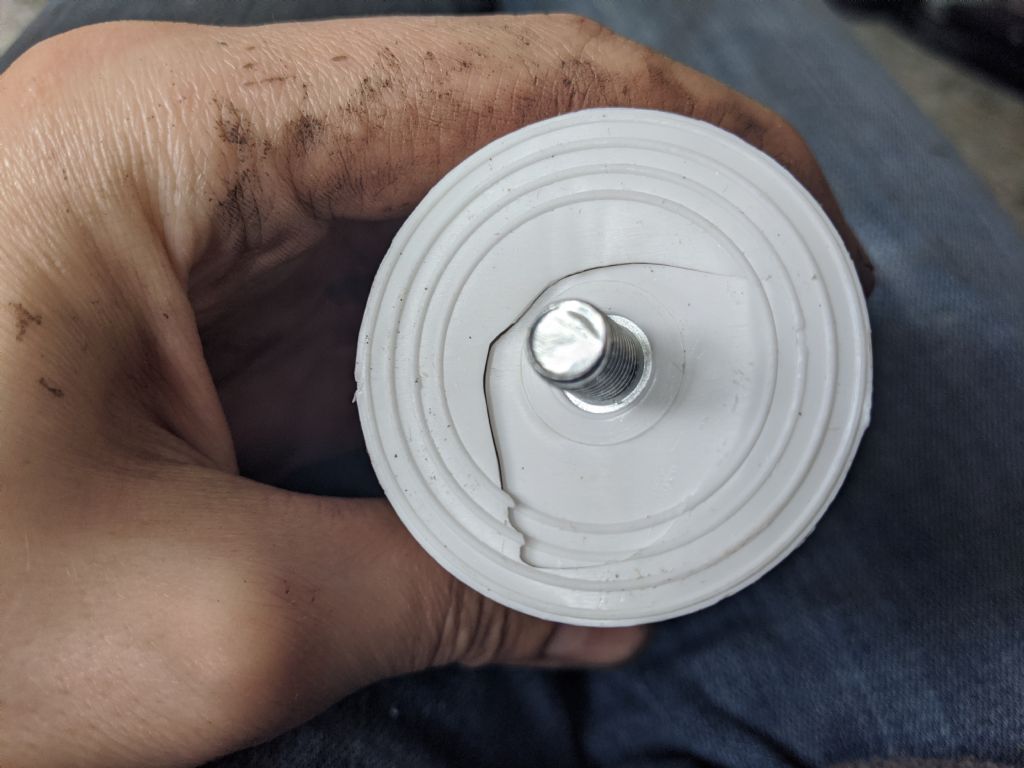

                        Also, capacitors finally arrived. I had to get them to send me some more since the originals were lost!
                        However, one is cracked. Will this be an issue?
                        Also, the numbers are slightly, instead of the 25/85/21 on the front, it says 25/70/21. From my understanding this means they are only rated to max of 70 degrees. Will this be an issue? Or should I send them back for being mislabeled?

                        Herman van der Merwe
                          @hermanvandermerwe76509
                          Posted by Richard Kirkman 1 on 22/06/2020 15:12:38:
                          You can buy these at any machine part supplier. I can even obtain it over here in SA! You can make your own as well.
                          What is wrong with your lid? The square gap? Just braze a piece of cast iron in there and paint it over.
                            Cracked is bad news.
                            Yes you need a rating of around 90C in the hot environment inside the steel case.
                            I would send these back …

                              It's just the corner has been broken off, but it doesn't bother me so i'll leave it
                              Plus I don't have the facilities to braze.
                              I've asked to send back all the capacitors. The old ones still work within tolerance so I think I'll just leave it, especially since I found that the light issue was the switch. (then again I still haven't tested the new switch)
                              #481569
                              Phil Whitley
                                @philwhitley94135
                                File or grind the cracked area into two straight lines and it will be much less noticable. The bench centres hade a small piece missing at the extreme end of one of the slots, I cut it square with a cutting disk then filed it up and painted it up the the ground edge, it now looks like it was made like that!
                                Phil.
                                #482076
                                Richard Kirkman 1
                                  @richardkirkman1
                                  Good advice Phil, it blends a little better now

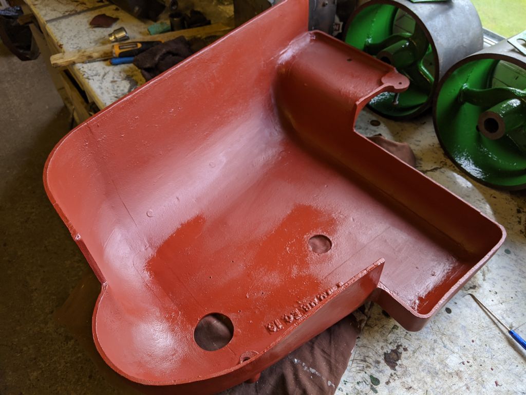

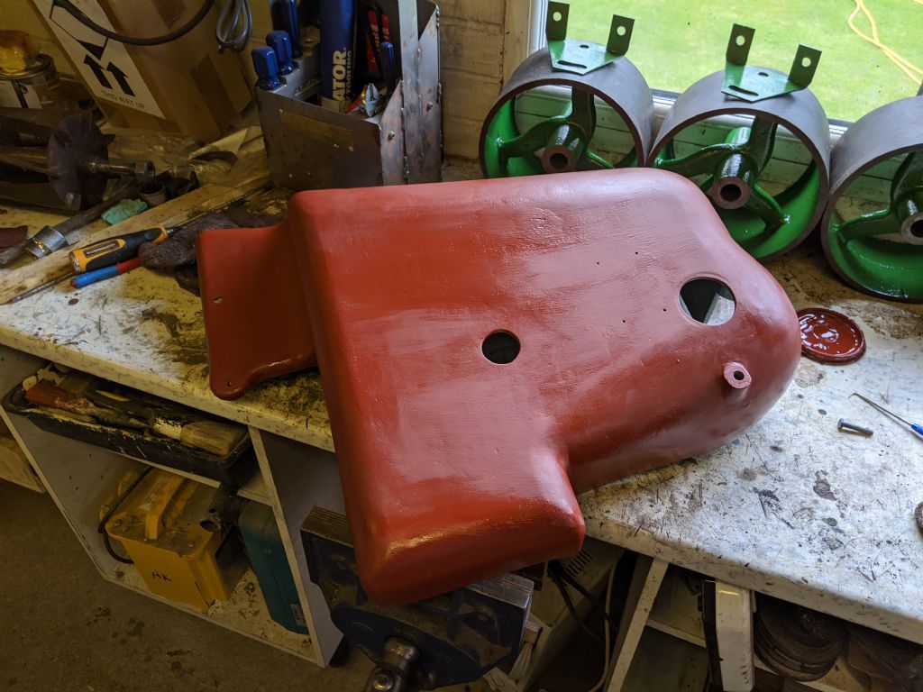

                                        Actually Howard, this time it turned out to be quite simple. I just had to take it to pieces, sharpen the mower, and adjust it to make it work better. Although I did have to make new rollers for the front as well. But, it was still more work than described as usual!
                                        I've had a fun day. I decided it was time to finish removing all of the red oxide primer from the aluminium, then I thought I'd do a test patch to see how thinly I could paint on the self-etching primer.
                                        I found the self-etching primer to be quite easy to brush on thinly. The picture makes it look thicker than it is. I was very careful. It was meant to be grey, but almost had a sort of blue tinge to it
                                        Then I let it dry for a couple of hours as instructed by the datasheet
                                        Then painted with the red oxide primer!
                                        I also gave the green wheels their final coat of paint today, so they can now be reassembled and put somewhere else. More space for lathe disassembly!
                                        The G plan table is arriving tomorrow for refinishing, so that will be a priority, It might take me a day or two, I'll have spare time while the varnish is drying. However, once the primer is dry I will sand it down and repaint. I'm still going to paint the inside of the cover red/orange, I honestly cannot wait to get it painted to see how it looks.
                                        Apart from that, other parts on the lathe are looking very tempting to take off and strip
                                        I've managed to get myself a well used interchangeable Pryor steel type, so I'll be able to fancy up the forward-reverse sign!
                                        If anyone wants to see some proper painting, Hermans thread is getting even more interesting
