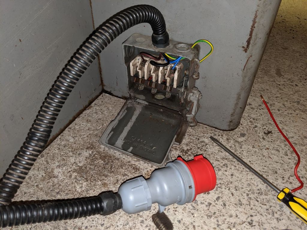

                Thats the isolator box i had to wire a plug to when I first received the lathe, not too relevant I don't think, but just covering all bases, as there could be issues anywhere
                And that's how i wired it, I think it was 2.5mm 4 core. So as you said that should be earthed?

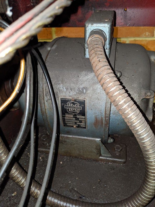

                Looking closer at the motor plate it says its from 1955, so quite old. It also says if i read it properly that the motor is 1.5hp. perhaps the earlier models had smaller motors. I will double check this when i'm home as the picture isn't the best. However, if it is 1.5hp then perhaps a 3.5hp static converter will be enough to power it for now (especially if Mal said his powered it for a few years)

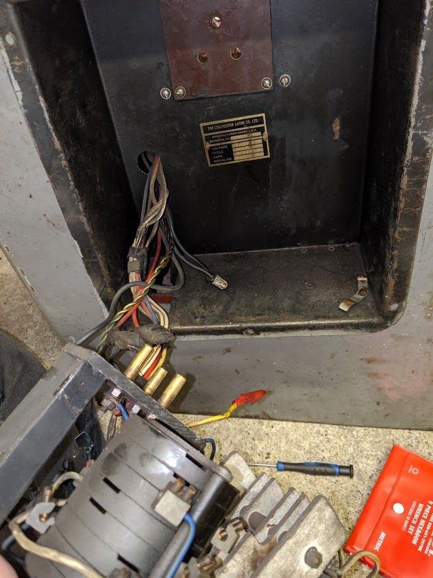

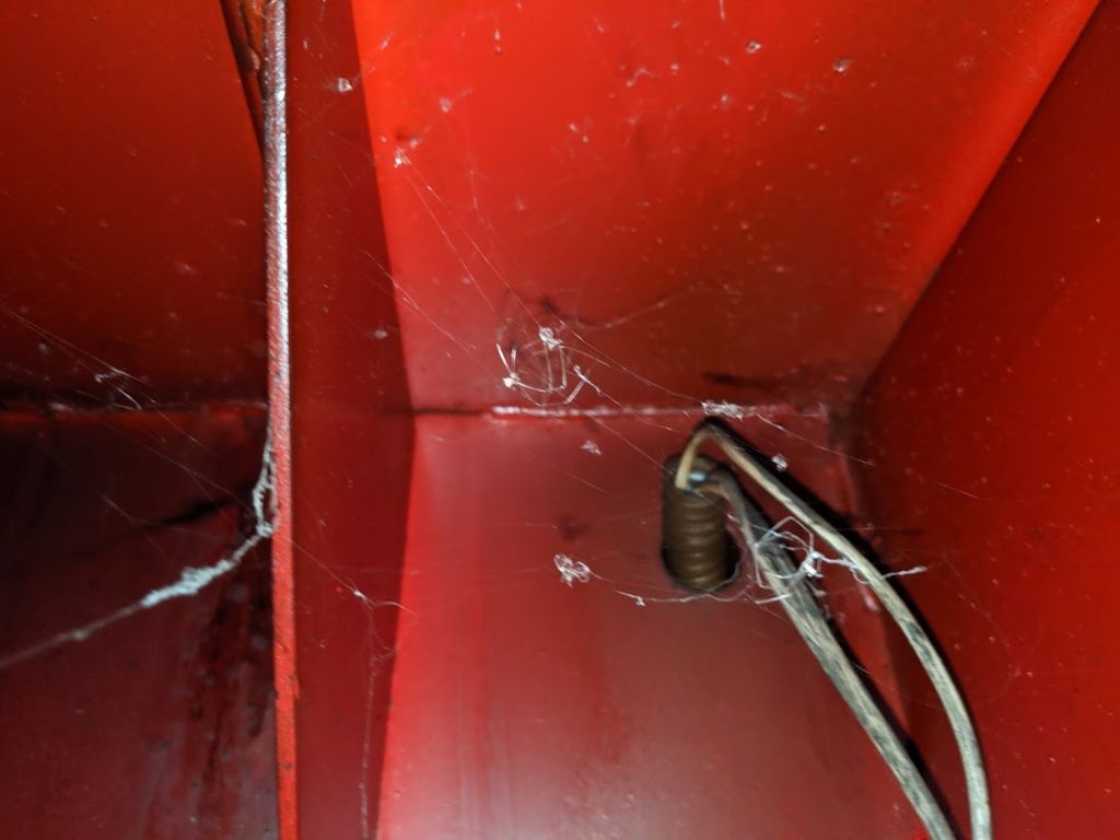

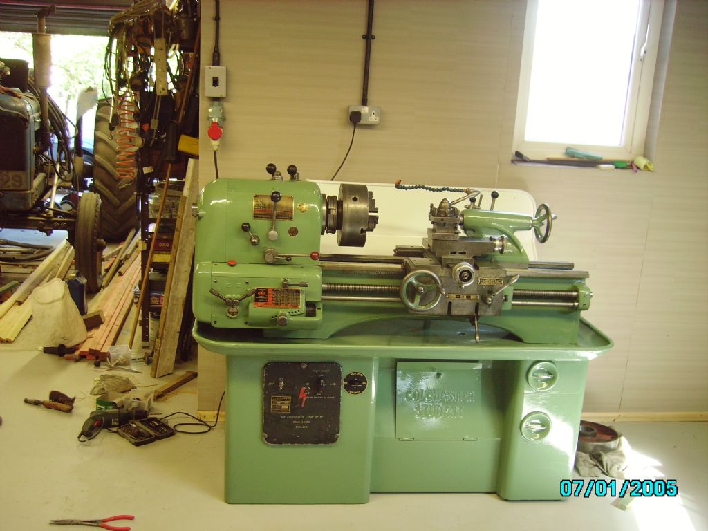

                This is where the wires leave the control board and lead through the casing to the coolant pump, just the 3 white wires
                Another random picture, doubt it's of any use, but the more the better

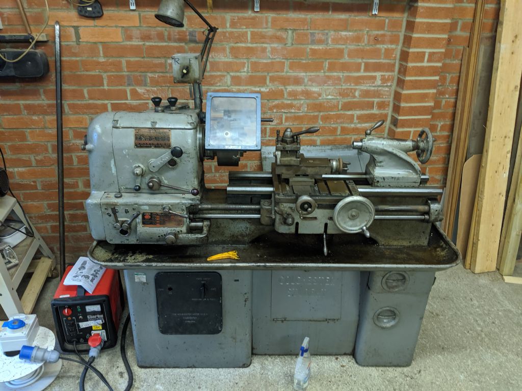

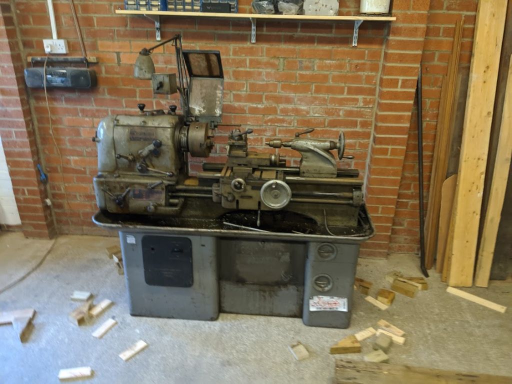

                Was this the sort of straight on picture you wanted?
                That's the lathe itself, still has a lot of cleaning to be done, but need it working first. As you can see, my forward reverse switch is not original like on your lathe Phil.
                I'll be able to get more pictures and even videos when i'm back

                  Well, I see the nice new cable with its plug going into the big switch box. What I don't see are any wires coming from the output contact set of that switch and into the lathe itself. Are they routed through the backplate of that switch? There is a hole for the wires to come out but nothing visible.
                  #439108
                  Richard Kirkman 1
                    @richardkirkman1
                    Posted by Swarf Maker on 27/11/2019 20:32:39:
                    Yeah they go out the back into the casing, don't have any pictures of where they go. Not too sure if I even know where they go, but it shall be investigated

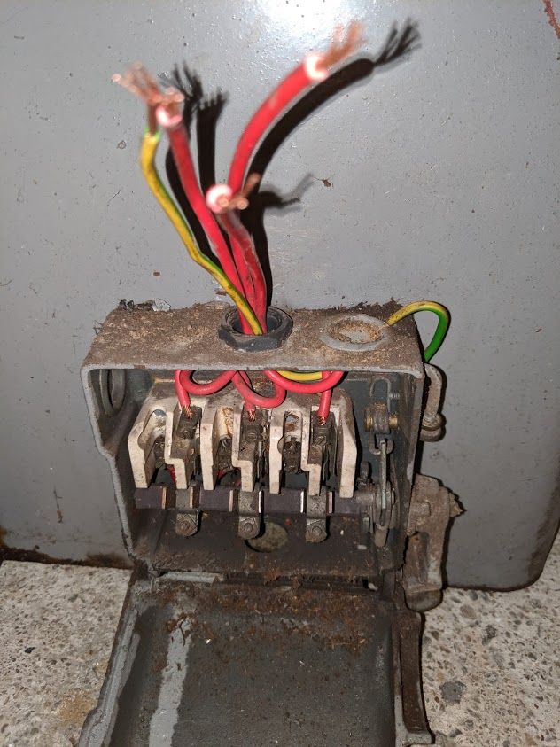

                        Right, there are several areas of the contactor I am not happy with, mainly, as everyone else has noted, the middle of the three contacts appears to be missing, but I can't be sure of that, it may have been modified so that it still works. When I first saw these pics at the top of the post, I thought they were examples of a different lathe, not your actual machine, I see from the ones you have just posted that they are yours. I will pull my control panel tomorrow, and have a look, but I think mine has the later contactor (Crabtree?) fitted. Below the plug in pins on the board, you see three coils, these are the overload tripping coils. the long straight bit of paxolin that goes across the top of all three appears to be a manual reset, you could try pushing it up from the bottom end, where the long arm sticks down, and see if it clicks and closes the overload contacts, may have tripped out if the phase convertor cannot produce enough power for starting. There are various areas on the whole panel that look to be overheating, or have been in the past, and TBH, rather than try to repair it, it would be easier and quicker to take the old contactor off the panel, and replace it with a modern one, keeping all the outside controls as original, but putting new guts inside! having said all this, if two phases are getting to the motor, it should growl and try to turn, and if the contactor is not pulling in, the overloads are irrelevant, as they come after the contactor in the circuit, and the way you have described it, the main contactor is not pulling in anyway. they are LOUD!!
                        Phil

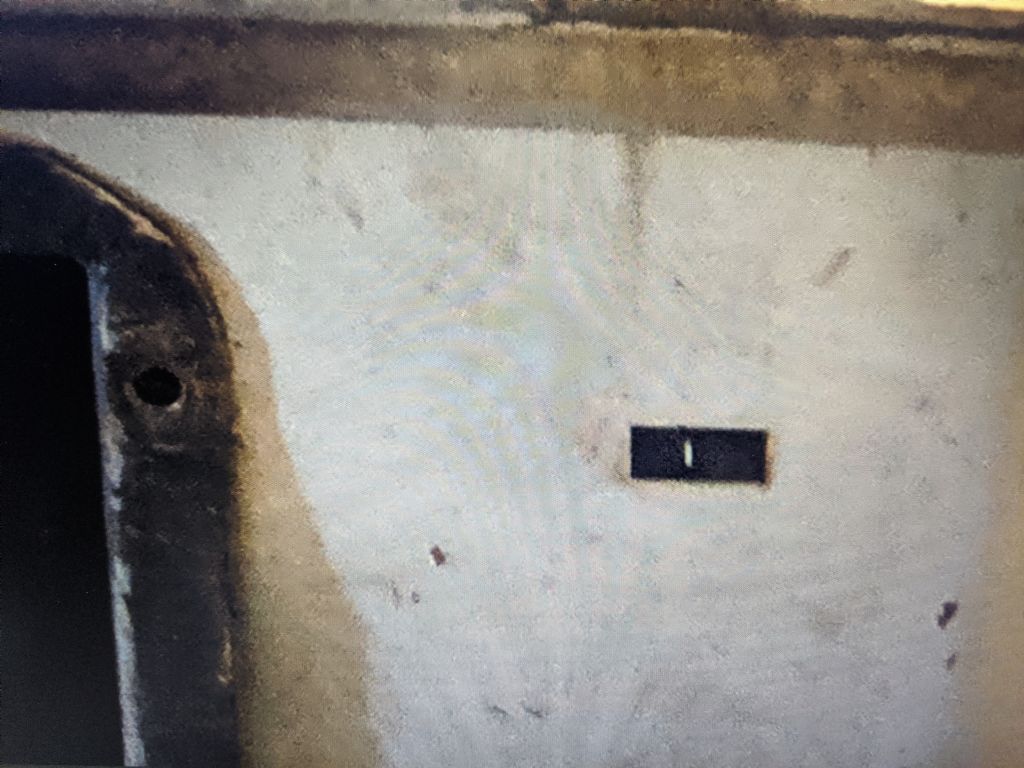

                          The picture of the lathe appears to show a hole, but its just a small sticker that has a 1 on it
                          So I'm pretty certain that it has never ever been dual speed. The motor is definitely original too, so I don't think its a possibility.

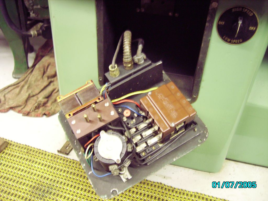

                            well richard here is the internals of mine, for what its worth !(not a lot as it is different), the start stop lever does work as I said earlier, if you put power on to the lathe with the start lever in the up position, the pump will run, but the main motor will not, until you press the handle down then lift it up again.
                            Looking at the pics of your contactor,The three black wires connected to the terminals to the right of the three pin plug, on the overload coils, go to the motor, the three blue wires connected to the other side of the overload coils are the feed from the contactor. You should, with a multimeter, be able to test three seperate phase wires from the isolator switch (check the action of the switch to make sure all three blades are going in to the contacts properly) on the back, through to the three pin socket in the back of the control box, then test from the pinsof the "plug" part to the rotaty switch , out of the switch to the contactor, from the other side of the contactor to the overloads, and then on to the motor, via the reversing switch. The missing contact on the contactor is irrelevant for now, as the contactor is not even pulling in, and it should do this even if it only ends up sending two phases to the motor because of the missing contact. When you have established that three phases are getting to the input side of the contactor, check that you have continuity through the contactors operating coil, and then you will see that one side of the coil is connected directly to a phase and the other end of the coil goes off to the safety switches on the gearbox end cover, and then to the "limit" switch on the back of the headstock, which completes the circuit to pull in the main contactor. Looking at the oily state of the limit switch that could be full of muck and oil, and not making contact, take the lid off and check it, I am going to try to post up the wiring diagram from my lathe, although the contactors are different, they are electrically identical, and this diagram is somewhat easier to read and understand.
                            Phil

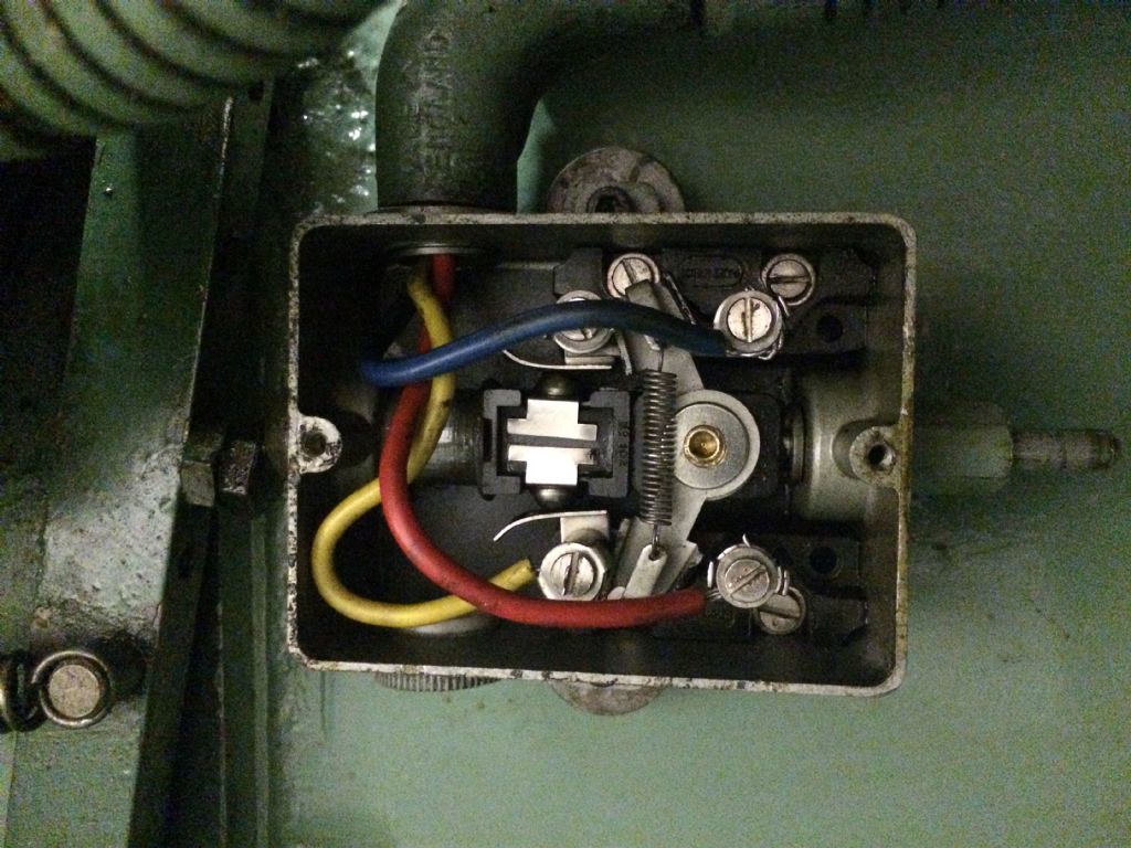

                              #440288
                              Phil Whitley
                                @philwhitley94135

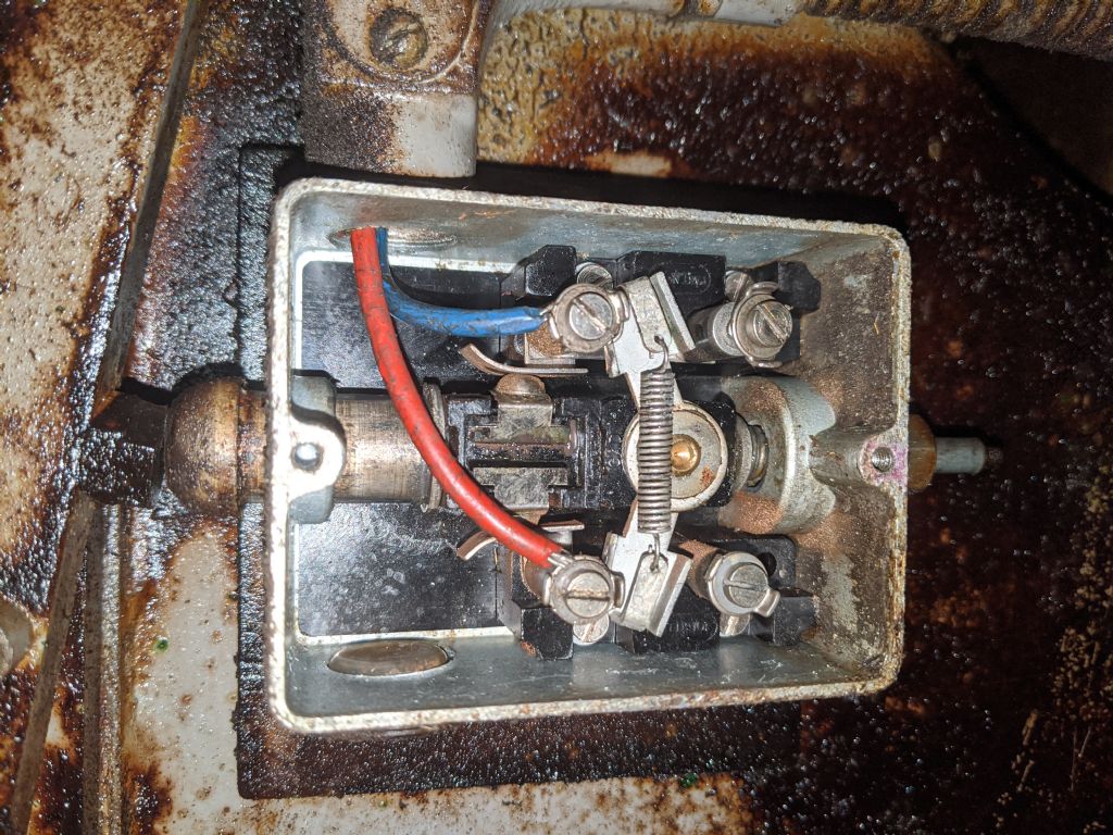

                                Moderators! can you move these pics 90 deg to the right please!
                                some pics of the inside of the "limit" switch which is used as the start/stop switch on the student.
                                First in the OFF position
                                And in the ON position
                                Off connects the red to the blue, and on connects the yellow to the blue, both contacts on the blue side of the switch are linked. the problem we have here is trying to reproduce the wiring diagram, as ALL the manuals I have looked at so far have small diagrams that will not enlarge without loss of print quality, and also some badly printed with wires that fade out to nothing! Making it work is easy for a sparky, but I want to reproduce a wiring diagram that shows the factory wiring, as this is what Richard has to deal with, I will soldier on, but if anyone has a copy of the wiring diagram without printing flaws, and of a reasonable readable size, post it up!! The basic contactor/switching arrangement is all there, but the safety/NVR circuit has bits missing on all the diagrams I can find

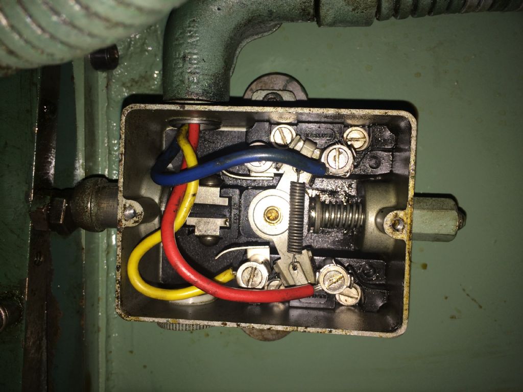

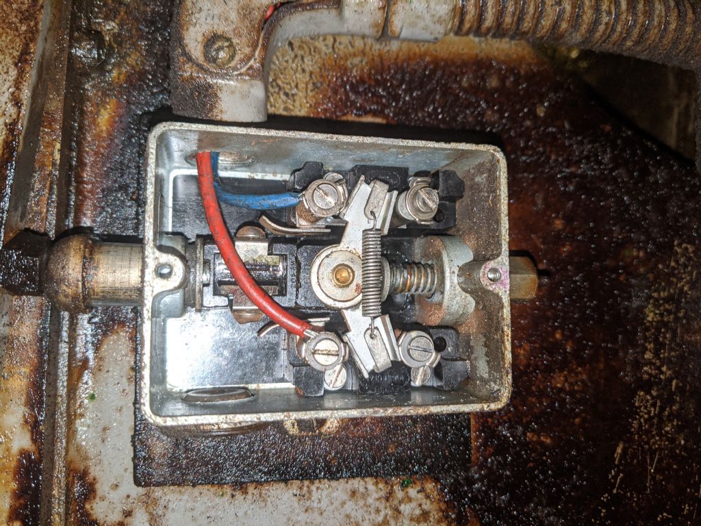

                                          Been back to have a play today, had a look inside the "limit switch" and it doesn't look the same as Phils.
                                          Thoughts?(apart from it being filthy)
                                          #441407
                                          Phil Whitley
                                            @philwhitley94135
                                            Hi Richard, all the wiring diagrams using this type of switch use three wires to the switch, the yellow is missing, and it is the yellow wire that takes the "live" through the end cover switch and the key switch to the C&D switch! the red is connected to the terminal where the yellow should be, see if you can trace the red back to the starter and see where it goes. even if it has been wired in some way to make it start, the NVR cannot work unless tyhere are three wires at the C&D switch.
                                            Phil
                                            #441411
                                            Phil Whitley
                                              @philwhitley94135
                                              Take the red tape off the yellow wire in the starter area, leave the end cover on, remove the panel round the key switch and see if you can test from the yellow wire in the starter to the key switch to see if you can find out where the yellow wire goes to. It should start at C1 on the contactor, go through the end cover switch, through the key switch, and to terminal one on the C&D switch.
                                              Phil
                                              #441418
                                              Phil Whitley
                                                @philwhitley94135
                                                Richard, the switch mechanism seems to be working correctly, but I would guess it is lacking the correct live feed, I am going to reproduce the wiring diagram out of your original manual in a more readable format, with the errors taken out, but I am working tomorrow, so will do it at the weekend. in the meantime, see if you can find any other disconnected wire ends, especially yellow ones!
                                                Phil

                                                  The lathe is alive. I spent quite a while using a multimeter testing for continuity in the circuitry, however I couldn't find anything wrong except from the way someone has changed the wiring. They have changed it so it no longer has the safety features, so the key switch, switch in the left of the headstock for the gear cupboard and others don't affect it. No longer has a no volt release either.
                                                  So I had a play with the wires in the isolator, swapped two of the phases round and it worked. Someone suggested this a while ago.

                                                    I'm not sure what condition the motor is in, Its the original from 1955 so it could be knackered?
