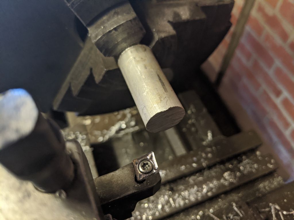

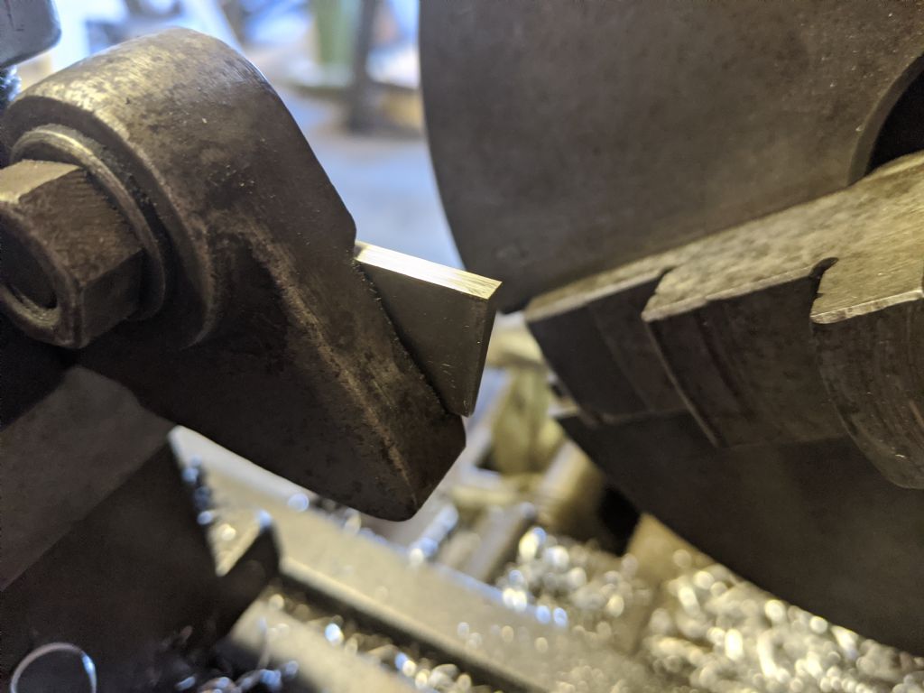

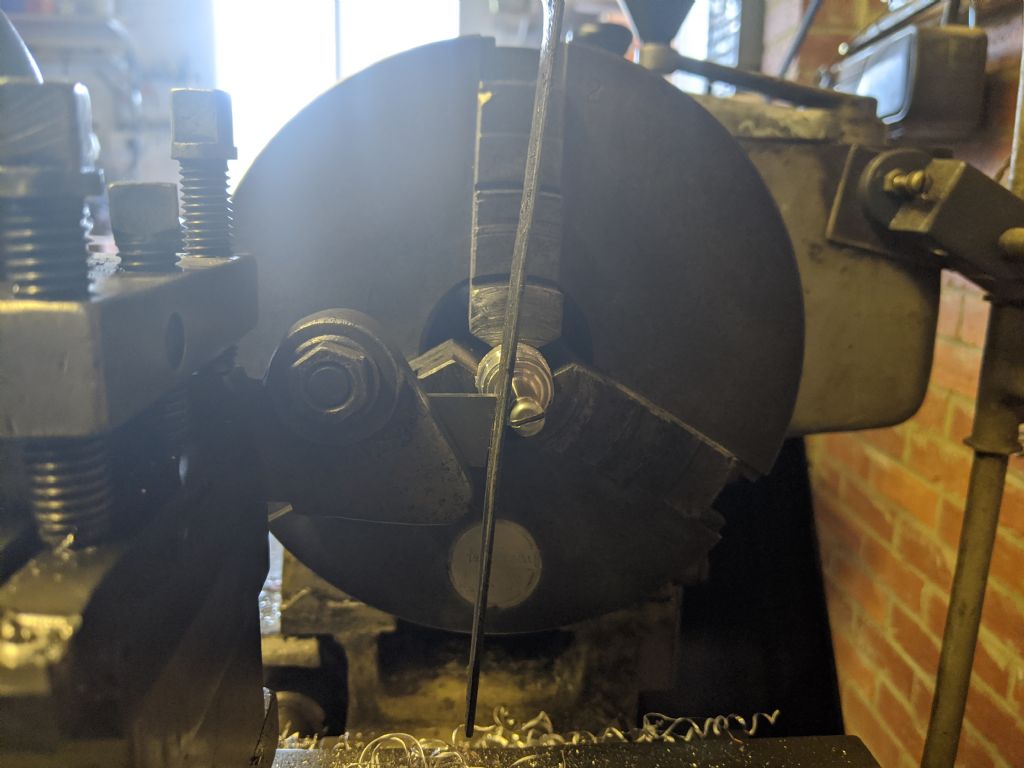

            Parting off started okay but then I have no idea what happened, just went terribly ended up snapping the tool. I had changed the shape of it a bit and made a weak point so I'll look into it tonight.
            The lathe started to make a horrible clunking noise. So I took off the motor again, turned out the grub screw wasn't tight enough, so easy fix.

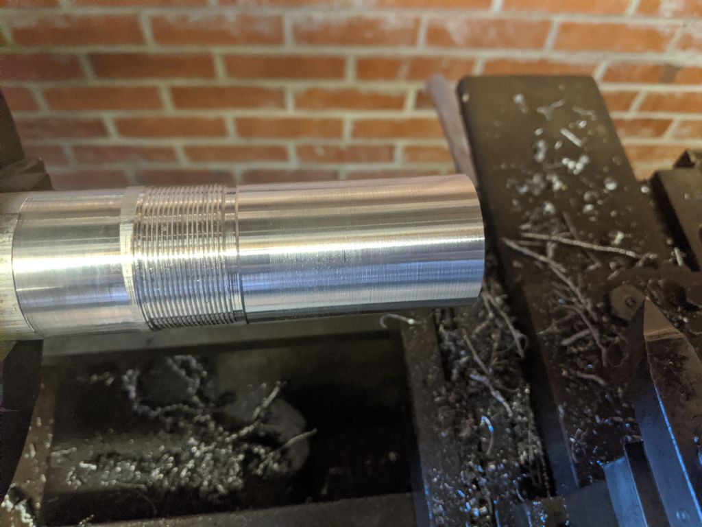

            I played around with some aluminum, just turned the end part and did a large 4tpi thread on the end. I didn't have the thread gauge on the lathe so I just left the half but engaged. But it went well. I forgot to move the tool back out a few times so it made marks on the return since the threads have some slop in so they don't line up back and forth
            Taking a cut to remove some surface marks from messing the thread up!

                    Parting off can be a problem. FWIW, I would suggest:
                    Minimum tool over hang
                    Plenty of lubrication
                    I cheat and use a rear toolpost, and being a cheapskate who hates grinding away good HSS, use Zero top rake.
                    This reduces the chances of a dig in.
                    For some reason, parting with a back toolpost seems to produce fewer problems that with the tool mounted in the front toolpost. But it may not be possible to fit a back toolpost to your lathe.
                    Keep a steady, but not hard feed. Don't let the tool rub.
                    Also, lock the Saddle to minimise any side load on the tool.
                    HTH

                        Being bone idle, I just grind the front face by approaching the grinding wheel head on. Hopefully, your parting blade already has clearance built in on both sides. If it hasn't, you need to grind some, but not too much.
                        You only need to produce some front clearance, effectively about 5 degrees. Too much takes away support from the cutting edge and weakens it.
                        Stating the painfully obvious, it is important that the cutting edge is on the centreline , and not above it. Tool rubs if you mdo.
                        Below and it will leave a pip in the middle of the job.
                        There are arguments as why a rear toolpost is better for parting off, all about the thrust being upward or downward on the dovetails. Have not followed the fight, just found that more dig ins and broken tools happen in the front toolpost. Am now getting so brave that power cross feed of about 0.0022"/rev gets used!
                        Speeds:
                        I tend to be cautious and run slower that for turning, about half usual surface speed.  Don't let the swarf build up for fear of jamming the tool on a deep parting cut..
                        HTH

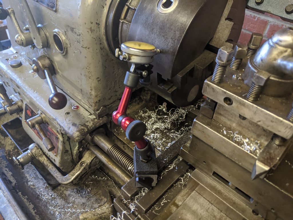

                                Thanks for the rollies dad thing, I haven't seen that before. I do have an indicator, but I need to make a mount for It to go onto the magnetic base. Perhaps today's project

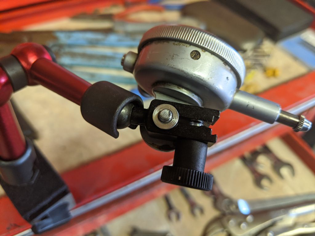

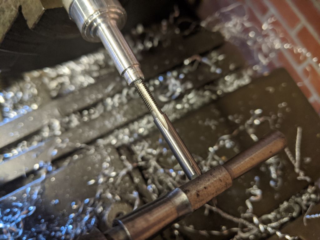

                                      I made a mount for my indicator today, although I'm not sure it's on the right kind of stand, it's works for me

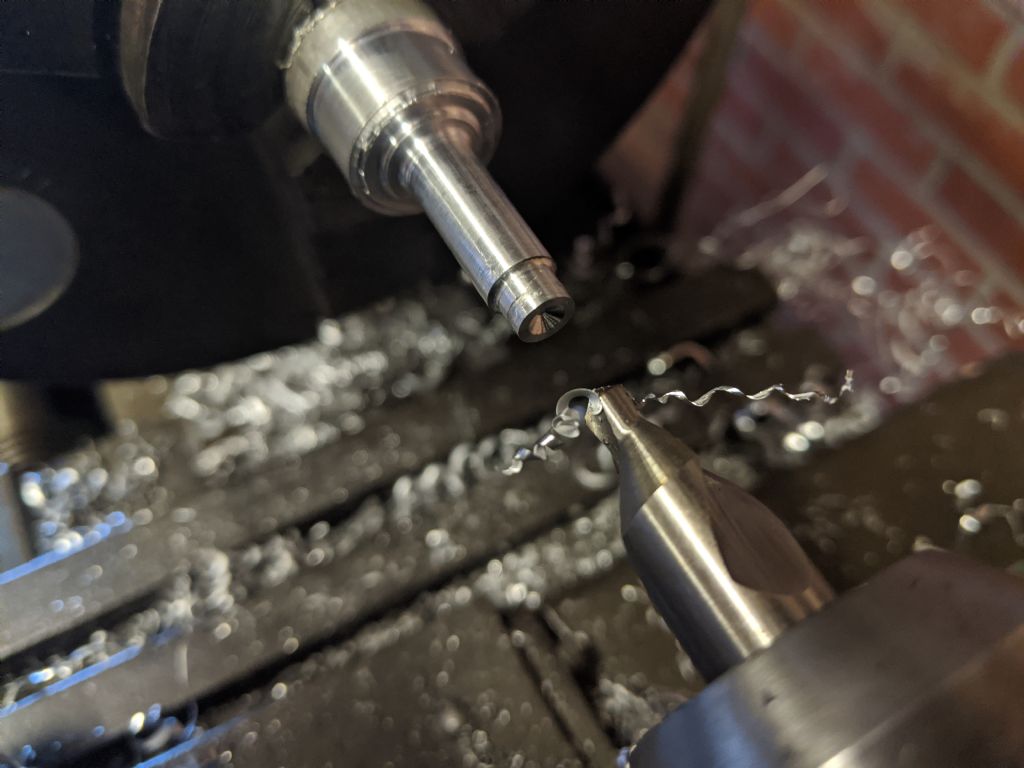

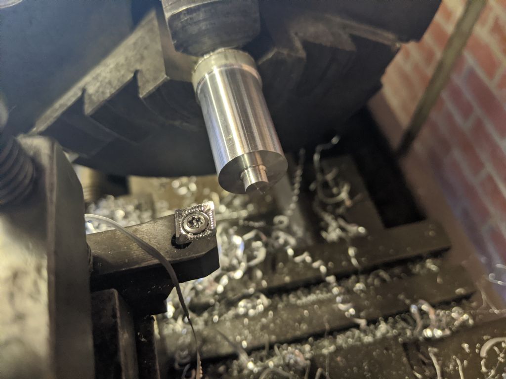

                                      I used a weird insert I found on arc euro trade. It said it was for non ferrous metals so I thought I'd give it a try, it did a good job I think
                                      I turned around 250 thou end for the indicator to sit on, then turned the rest to fit in the holder nicely
                                      Drilled the end out to 3.3mm for a m4 thread. It was nice to finally get to use my taps. Although they were too small to use a spring center, it went in very well by eye
                                      I had a play with my has parting off tool, ground it to how it was suggested, then I played around looking at the center height. It was a long way off, too high. I used the flat bar trick thing. I did try to grind it down a bit but it was taking too long. And since it was such a small part I decided to use my carbide parting off tool which was under center so I could shim it to the right height. It worked like a dream, 120rpm or so, hand fed, very slowly, with plenty of oil. Only aluminum so not too hard, but still good practice
                                      When I parted off yesterday I used the other end of the tool which was lower, but I didn't check the height of that, so I don't know if it was or wasn't on center. Guessing it wasn't since it went so badly yesterday.
                                      It fits! A nice little project
                                      Now I'll be able to use my 4 jaw when it dries. I put another coat of paint on it today. The first had only just dried as I put it on so thickly, and it pooled at the bottom. So just a thin coat today!

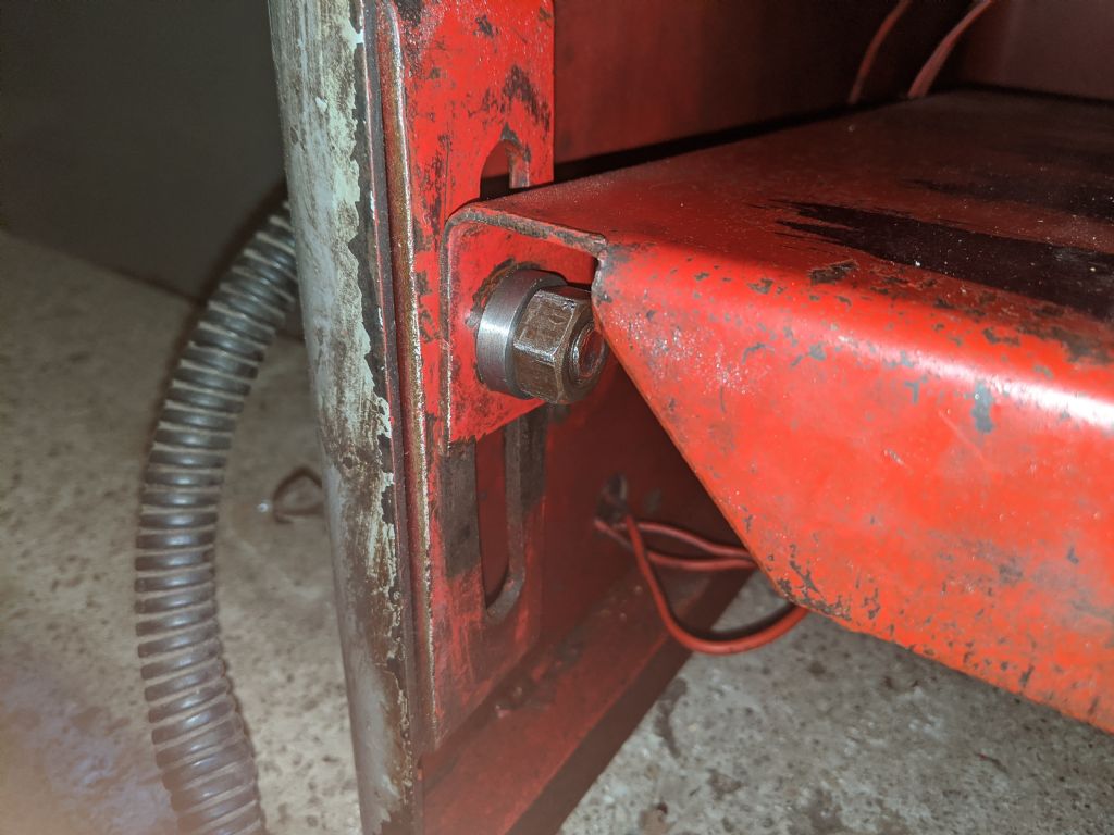

                                            It's not just the twist, it's also raising the lathe since I'm taller than average, it's a little low. I don't want to be crouching over to use it. Accuracy isn't quite it either. Obviously I've got plenty of time so I'd like the machine as well as possible, but that had limits. I'm not sure if the garage floor is level as well

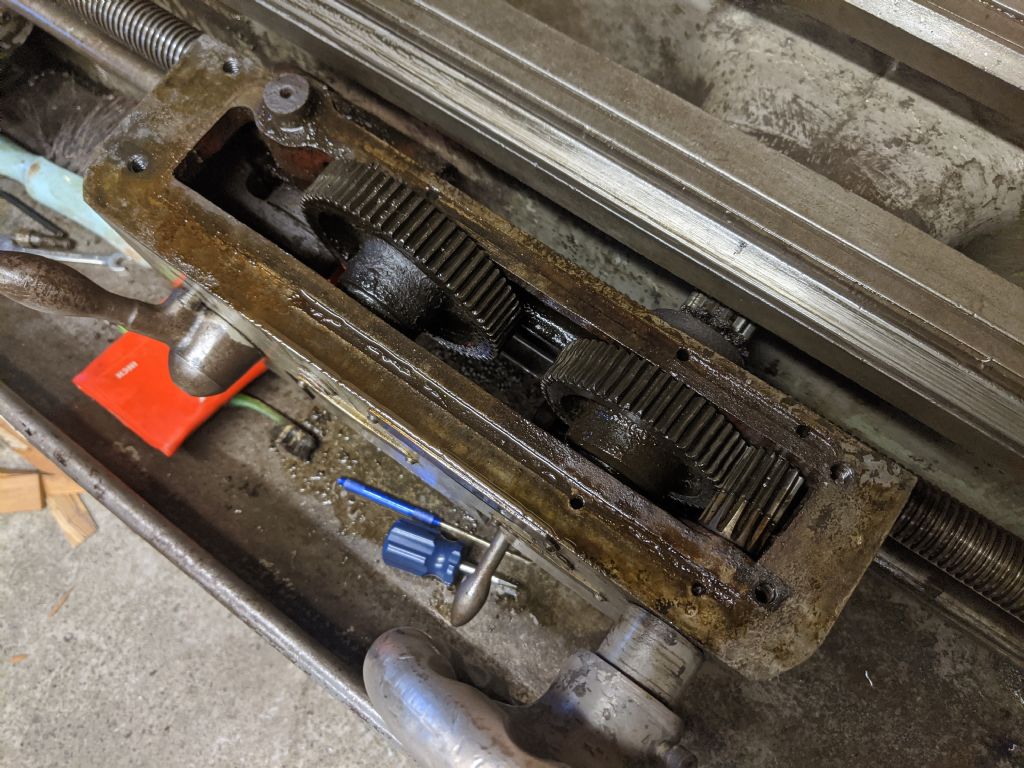

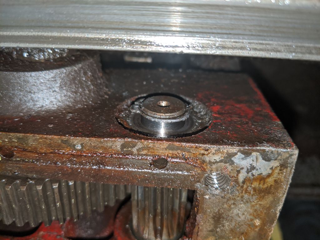

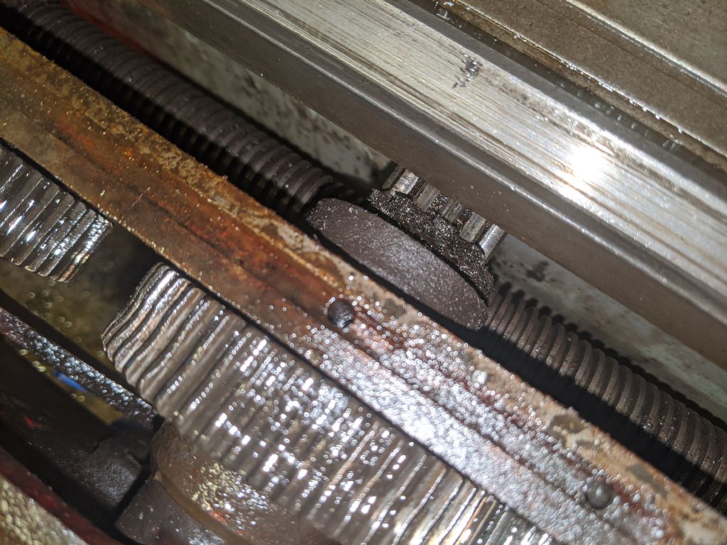

                                            When I've been playing around with threading, the lever doesn't always want to disengage fully, so I thought I'd try to take it to pieces so I can get in to clean. Also, I wanted to look at why my main carriage hand wheel moved in and out, which is very anoying when turning. All has become clear!

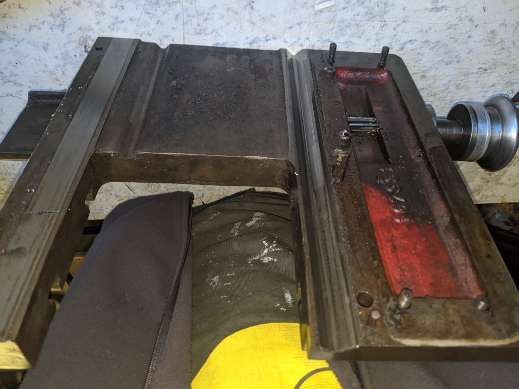

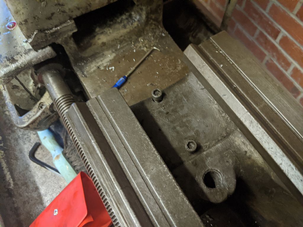

                                            So the issue is, I can't remove the apron completely without taking the SC gear box off. So I thought I would just take the top of the carriage off and clean in from the top. So I started to take it to pieces. The holding part at the back came off first, then I unscrewed all the bolts holding the top on. This unattached the apron, but the top was still attached with a part underneath. I couldn't remove it since I didn't have access. The only way was to slide it across then lift it off once the gap bed was removed.

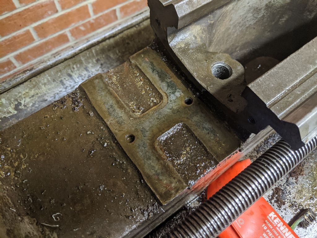

                                            First time I've taken the gap bed out. I'm very tempted to paint it orange while it's out😀
                                            I have no idea how this would be disassembled on a straight bed lathe, possible the long way round
                                            This then let me take the top off, so I have access to all the gears. Very dirty inside as expected, I'm just wanting to get all the gunk removed and have it cleaned up
                                            Some very thick gunk in there. Anyway, I'll get on with a proper clean tomorrow. It won't be perfect, but it'll be better than before.
                                            I also got a look in behind the shaft that the wheel goes on, there's a circlip holding the shaft in place, but there's a space of about a quarter of an inch that's unoccupied. Looking in the manual, I'd say there should be a spacer in there to keep it from moving back and forth like mine does

                                              I am sure you have thought about this, but do not get paint on any surface of the gap bed that sits on, or is adjacent to, the main lathe bed. To preserve the accuracy of the machine when reinstalling the gap bed it must be clean and go in the exact same position.
                                              My Student stands on a concrete floor with some shim under one corner to get it firm and level. I have no problems with accuracy of the finished product.
                                              If you want to raise your student you could use heavy steel channel across each end. My Myford Super 7 ( which is on a factory steel cabinet with tray) is raised like this. I also have no problems with its accuracy.
                                              I have a high precision level which helped to ensure the lathe beds were not twisted. I machined test bars to confirm the lathes cut the same dimension near the chuck and at the end of the bars near the tailstock.

                                                      to remove the apron, you remove the lead screw and feed drive shaft first, they disconnect from the SC box under the sc box top cover. So, with the saddle still on, you disconnect the lead screw and feed shaft from the SC box, remove the support at the tailstock end (you might have to do this first, to get enough clearance to get the leadscrew and feed shaft disconnected), slide the leadscrew and shaft out of the apron, remove the apron, and then remove the saddle retainers front and rear under the saddle, and remove the saddle. You could still do this if you support the apron on some wood blocks, do not let the weight of the apron hang on the leadscrew and feed shaft, they may bend!!
