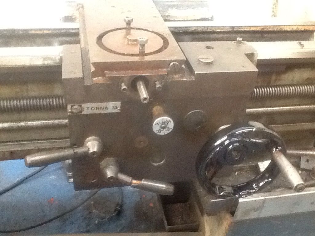

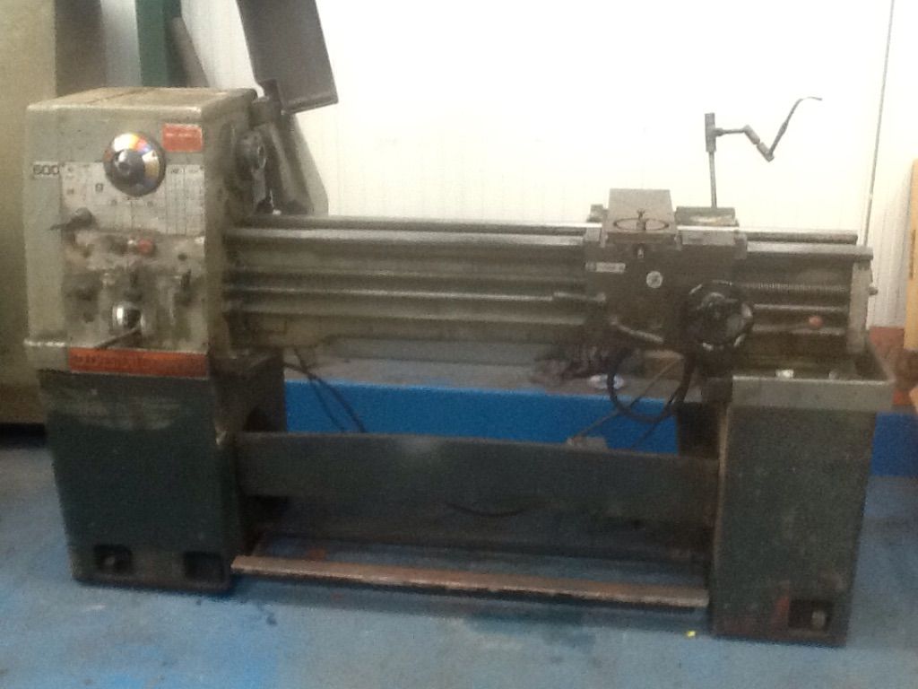

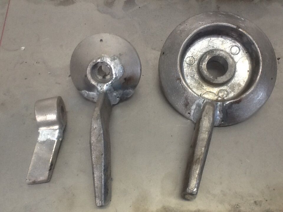

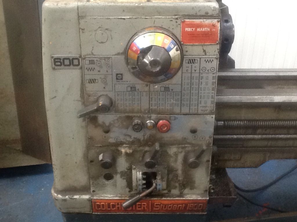

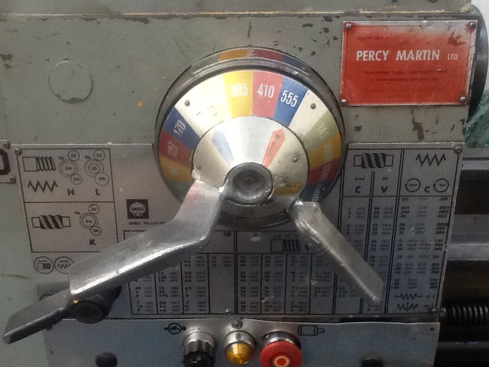

      This poor Colchester Student 1800 was damaged in several places after it was dropped while being moved. It sat uncovered in our works yard for a few weeks, awaiting its fate in the scrap skip.
      I suggested I try to fix it, but there was no interest, it being deemed uneconomical to repair. So I kept squirting oil on it every now and then, and salvaged some parts off it, but unable to bear the site of it decaying in the rain no longer I then suggested I put it under cover in a lean to in order to salvage other parts off it. From there it discreetly made its way into our steam engine workshop for some TLC every now and then when time allowed..image.jpg……………I have repaired the smashed cast iron apron hand wheel, and removed the damaged crosslide dial, thankfully the crosslide feed screw appears to be undamaged..image.jpg…………….The Alluminium Alloy headstock speed control levers are smashed, also a bent joystick lever on the screwcutting gearbox plus a broken joystick locating lug.image.jpg..

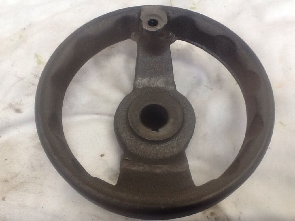

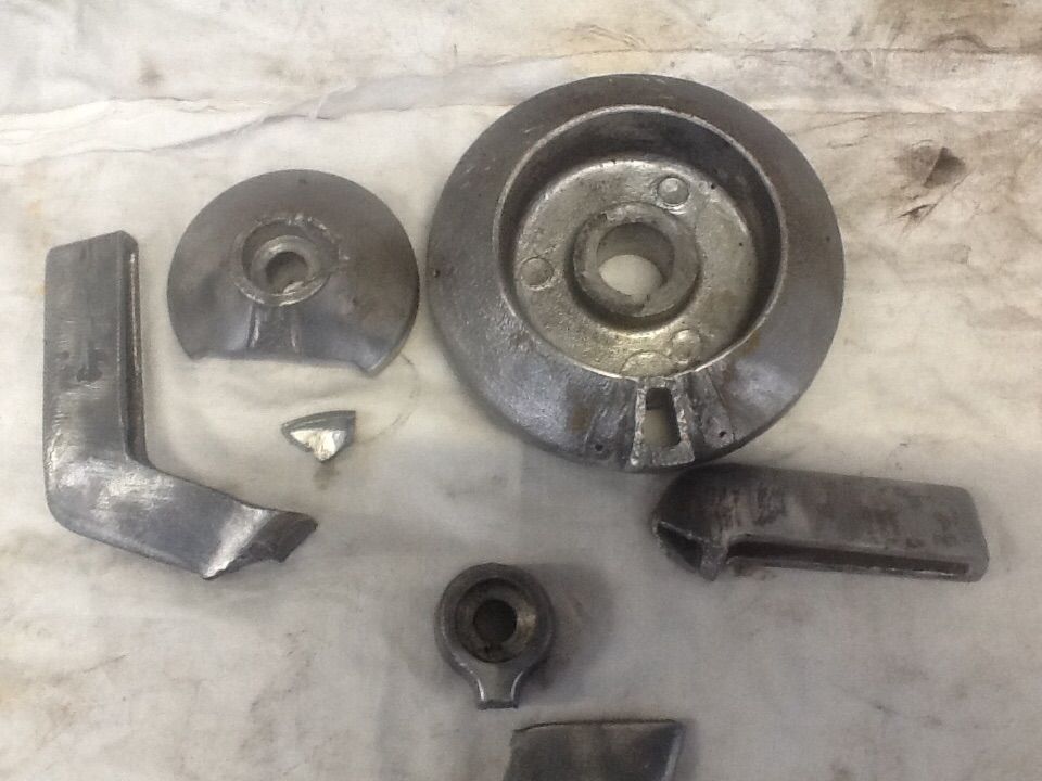

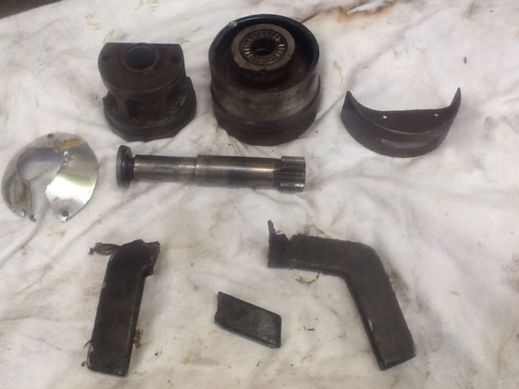

            Some of the damaged parts, the crosslide dial is the duel metric and imperial reading type which has badly damaged internal gearing for the duel dials. I have already done a weld repair on the broken hollow shaft with the gear teeth on the end, this slides onto the splined end of the crosslide feed screw.
            The broken headstock levers, and the snapped off end of one of the screw cutting box levers were found amongst the wreckage.

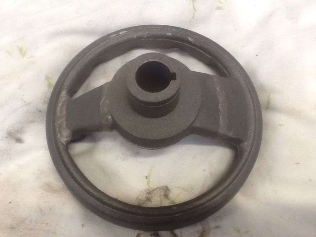

            image.jpg……………..The aprons cast iron handwheel was smashed into three pieces, with a break running through the full length of the centre of the threaded hole for the handle. I welded it all back together with the Tig welder using some nickel iron electrodes as filler rods. The two halves of the threaded hole joined back up nicely with the handle screwing straight back in.

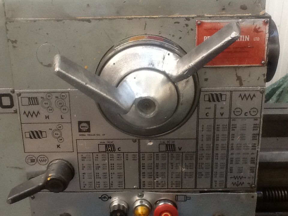

                  The smashed cast Alluminium headstock control levers were stripped of their plastic coating and cleaned up ready for Tig welding.
                  .image.jpg……………..I welded up the cast levers without any problems, thankfully they were made from Alluminium Alloy and not some Nast Zinc Alloy.image.jpg……………..After a little fettling the levers fitted back fine, followed by the colour coded covers that were pinned back on.image.jpgimage.jpg

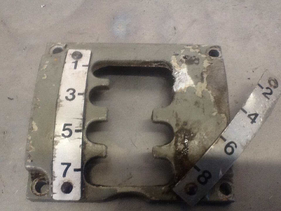

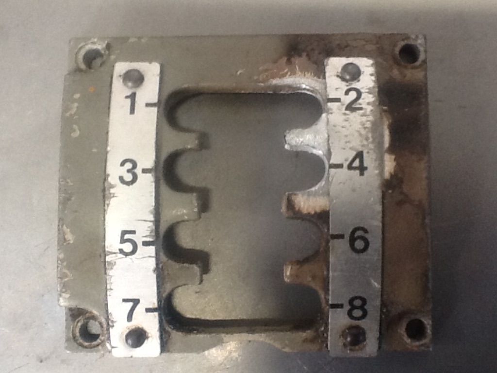

                    The screwcutting gearbox joystick gate had one broken locating lug. This is also made from cast Alluminium, so I built up a new lug using the Tig, then reshaped it with a die grinder.

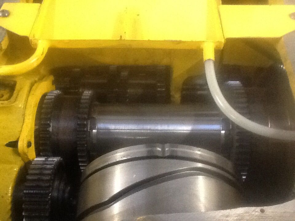

                    …………..A look inside the headstock revealed internals in excellent condition.image.jpgEdited By Lathejack on 18/01/2020 18:47:50
