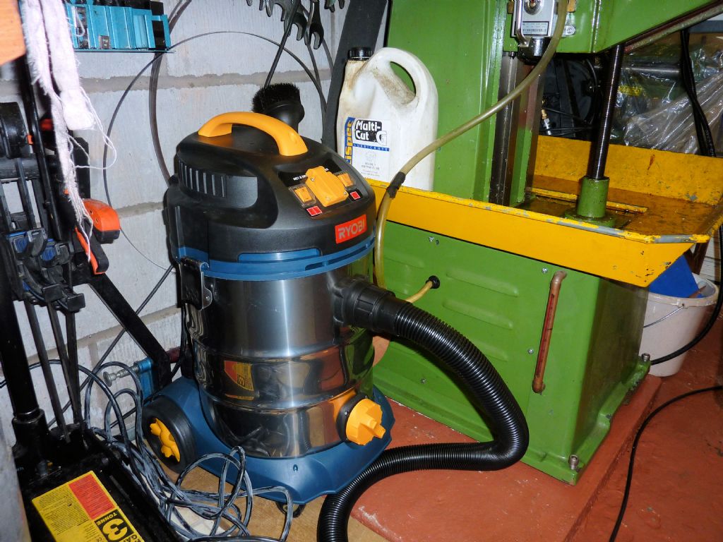

      This is not something most worry about – unless like me you are subject to endless grief should swarf find its way onto the living room carpet!
      However, another complication is the use of flood coolant and the resultant pile of soggy swarf, and how to dispose of it. I had reverted to the jam-jar of cutting fluid and paintbrush method which wasn't too difficult to clean up with an ordinary domestic vacuum cleaner, albeit the small capacity bags needed frequent changing (at no little cost), but having reinstated my flood coolant on the mill the small domestic cleaner simply can't cut it any more.
      So today I took delivery of a larger wet and dry vacuum cleaner which I thought was pretty good value at around £100 ( **LINK** ) and it seems to do the job nicely. No more worry about a dust bag getting soggy or swarf being sucked into the motor, this thing is designed for sucking up wet stuff. Much more powerful at sucking swarf out of crevices too – provided you don't let it suck up stray drills and taps etc., at the same time. The 30Ltr capacity is also a bonus. I wish I had it a couple days ago when I accidentally released a half gallon of coolant onto the workshop floor!

          Beware of leaving the inside damp making the filter soggy then sucking up regular dust or worst plaster. Ideally keep it dry inside. The 'wet and dry' is the marketing dream. Try to take off the filter regularly and reverse blow it with the airline (outside of course).

            I have got a similar model and it works very well considering the amount of oily filth that gets sucked into it. Only one problem has arisen and that is the corrugations on the vacuum tube can trap oily muck and swarf and on occasions gets partially blocked. Vigorous bending and twisting (the tube, not me) whilst the motor is running usually clears it but the time is fast approaching when I shall need a new tube. Who sells them?

                    No smell from the suds I use, some are better than others though (low odour should be on the container) and it should also have an inhibitor to stop fungal growths. I find suds gives a easier cutting and better finish, cooling isn't really a problem for me.

                              I dimly recall having a Vax at some point years ago, my only memory of it was it sounded like a Jumbo Jet starting up! One thing about the Ryobi – it is reasonbly quiet in operation. For the stinky thing, there are a variety of chmicals you can add to kill the smell.

                                          The Lidl offering is probably good quality (Aldi/Lidl stuff usually is) although it is not as powerful as the Ryobi (vacuum is 190mbar as opposed to 235mbar on the Ryobi), and the hose looks to be smaller diameter. Still, worth considering at the price.
