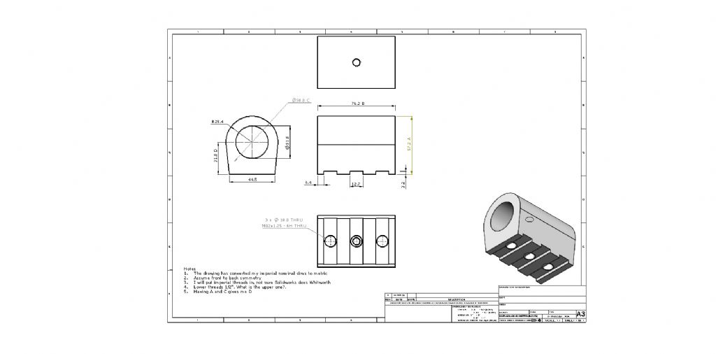

      I find myself 800 miles way from loved ones at Christmas, with a lump of cast iron and workshop time.
      Can anyone help with dimensions for a Clarkson tool and cutter Radius Grinding Fixture? I have a boxed mark 1 unit which like most others, is missing the circa 3” long component which holds adaptors.
      Superficially simple to make, I’d appreciate some dimensions as the project has waited a year or more to be kicked off and Tier 4 looks like the perfect time….
      Many Thanks
      Ian

          Ian Armstrong
            @ianarmstrong78579
            Hi Oily Rag
            My first stab at dimensions. I'm making from scratch and only have the 'Bedroom workshop' photos to work from.
            Ian

            peak4
              @peak4
              If you're not already aware, The Bedroom Workshop is quite a good resource for information.
              My own RGA (as yet unused by me as I need to make a universal head) id different to the one shown in the photos in this link. Rather than a solid Z shape, mine is built up of several parts; the top piece which supports the head is on a swivel, which looks original.
              Depending on what design you're looking for, you appear to have a couple of options.
              Bill

              Ian Armstrong
                @ianarmstrong78579
                Hi Bill
                My plan is the simple Mk1 holder to start with, that makes it useable. I might put the effort in for Mk2 parts afterwards. Presumably there are enough people missing the holder, that it can be passed on.
                Merry Christmas
                Ian

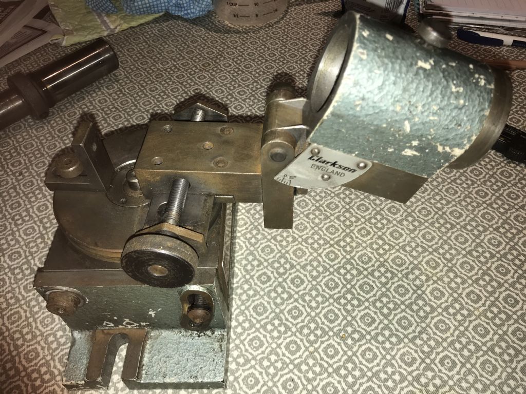

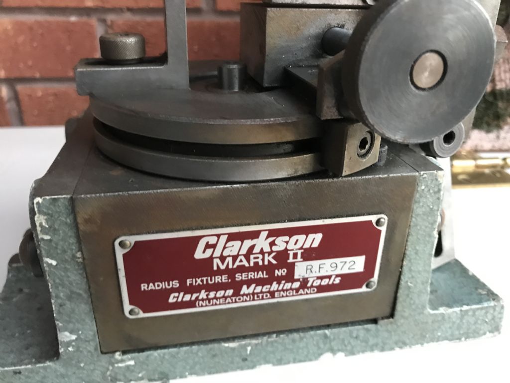

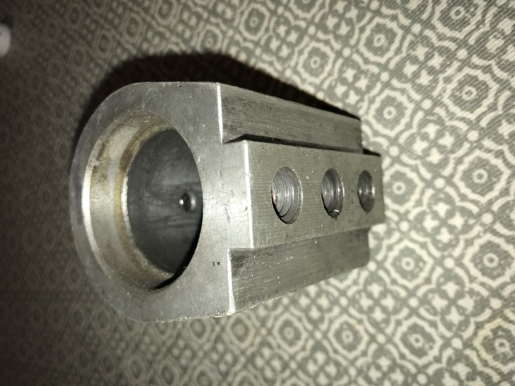

                  Hi Ian,
                  I've dug my Clarkson RCA out and what I'd forgotten is that it is a MkII – having said that I am not sure it is a standard MkII as it came directly out of St Mary's Rd Factory and may be a prototype or special.
                  Perhaps someone can confirm if it is a MkII!
                  On this the toolholder assembly (I've still got to dig that out!) is similar to your drawing but the tenon is coaxial with the bore not at right angles as shown in your sketch.
                  It locates into the female tenon slot as shown in the first photo. It has a very long toolholder 'tube' to allow for long tooling to be raidiused. I also have a lathe style square toolholder which allows lathe tooling to be radiused accurately.
                  I'll dig the bits out and post later!
                  Martin
                  #515306
                  peak4
                    @peak4
                    Martin, that looks to be broadly the same as mine; those bits are all I have at the moment.
                    The only obvious difference, are the three holes on the sliding part.
                    I'd certainly appreciate a photo of your other parts as well, since I still have them to make as well.
                    Unfortunately Covid got in the way of my trying to organise some lumpy bits of cast iron bar.
                    Also, does anyone have a working contact with the chap who runs the Bedroom Workshop website please?
                    I've tried the one on the site, but had no reply.
                    Bill
                    #515319
                    Oily Rag
                      @oilyrag
                      Ian, peak4,
                      Ere'tiz:-
                      and separately with its sleeve:-
                      Look in my album "Clarkson T&C' for further photos.
                      The lathe tool tip grinder eludes me at the moment but I shall search it out! Measurements for the tenoned block (it is interesting that it is made in aluminium ), is as follows:-
                      Overall length = 2.887" (Not including the internally screwed collar/thin wall sleeve – that is 2.248" o/d, collar shoulder depth 7/16th, bore i/d 1.5005", sleeve o/d 1.6845"
                      C/line of bore to tenon location face = 1.125", tenon face major width = 1.92", tenon locating width = 0.8745", depth of tenon = 0.245". 3 holes in male tenon are tapped 7/16" Whit (BSW) there spacing along the tenon length are 0.567" from one end x 0.9" x 0.9" ctrs.
                      Sleeve clamp screw is 5/16" BSW centrally displaced along axis centreline.
                      The thread in the retained inner sleeve appears to be 1 5/8th x 20tpi whit form (but I will confirm later)
                      The long sleeve is interesting in that it is in two parts (which at the moment I cannot separate!) More details of the sleeve will follow. There is one other item which I need to photograph and that is a straight shanked (1.000" dia) centre point which is the setter for the radius offset. it fits into one of the sleeve ends (one long sleeve end is 1.250" dia the other is 1.000" dia)
                      Hope this helps you get started on making swarf, if you need any other dimensions then feel free to mark up any of the photos and repost.

                            noel shelley
                              @noelshelley55608
                              Hello all, the two picctures are both Mk2. The Mk1 has a fixed arm and raised tenon with a single hole, the tool holder for this has 3 slots and threaded holes. The slots run across the axis of the large hole. The Mk2 has an arm that can be angled, with a slot running down the middle and a single bolt. The tool holder has a tenon down the middle and single threaded hole. They nearly all seem to loose their tool holders. They would be easy to cast in alli if a good drawing was available. How many ? Noel

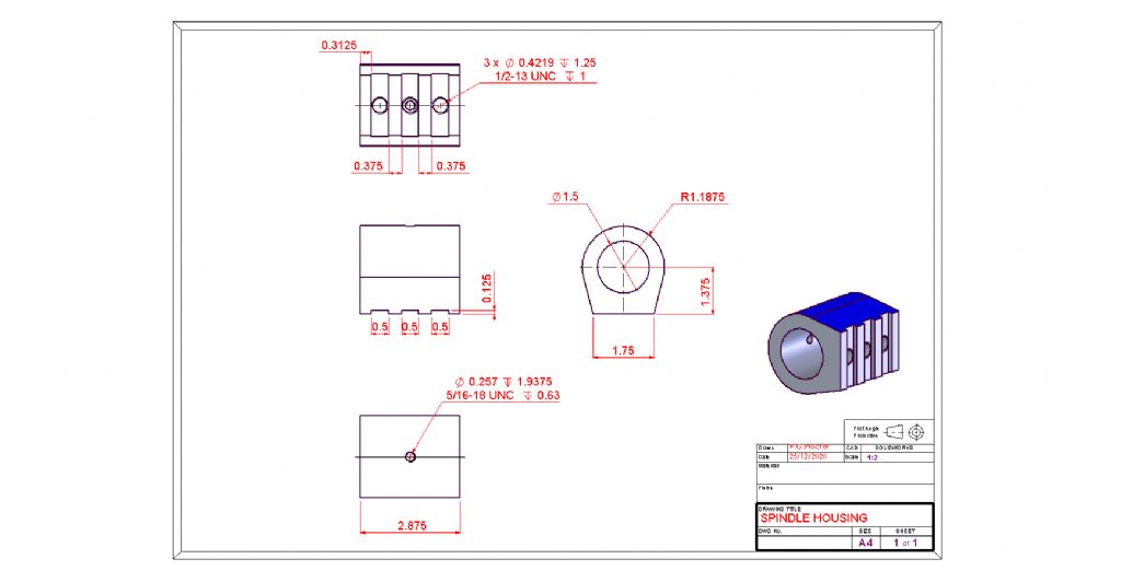

                              Phil P
                                @philp
                                This is the one fitted to my mk1 version.
                                Phil

                                Ian Armstrong
                                  @ianarmstrong78579
                                  Thanks Phil/all
                                  That should keep me busy on Boxing day.
                                  Martin's Mk 2 has a front counterbore. I assume Mk1 has a plain 1.5" through bore?
                                  Ian

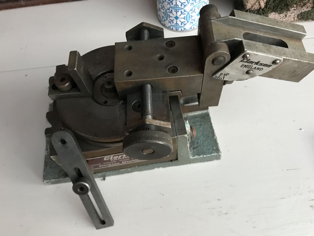

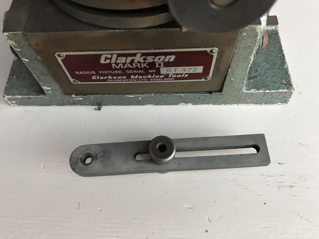

                                            SteveI
                                              @stevei
                                              Hi,
                                              My MK2 attachment came with a few items that are not in the pictures shown so far. So I've put a few pictures into an album. If you want any measurements of the items pictured do let me know.
                                              Oily Rag – I'd be interested to see pictures of the lathe tool radiusing holder you have. Is it anything clever?

                                              Oily Rag
                                                @oilyrag
                                                Hi Steve,
                                                No it is fairly straight forward other than it has an adjusting dovetail slide to bring the tool forwards (sideways movement is accomplished by the cross travel screw). I have only used it a couple of times and that was for a shaper tool grind. However it did produce an excellent radius – far better than a hand formed one!
                                                As I said previously I have to dig it out and currently Mrs Rag is, much to my frustration, limiting my 'shed time'; something to do with the time of year, I will drag it out and photograph for you.
                                                Noel, interesting that you say the bore of the toolholder is 1.25" and not 1.5" – mine is 1.500" and is sleeved with a steel sleeve. There is then a further holder (long) shown in photo #2 of the second 24/12/2020 post. this screws into the rear of the holder and is then sleeved down to either 1.25" or by reversing is sleeved down to 1.000".
                                                Phil, I would certainly appreciate a copy of the MkII instructions as I have never seen/read any and have so far used it 'intuitively' (and more than likely wrongly!). Can I PM you as well?
