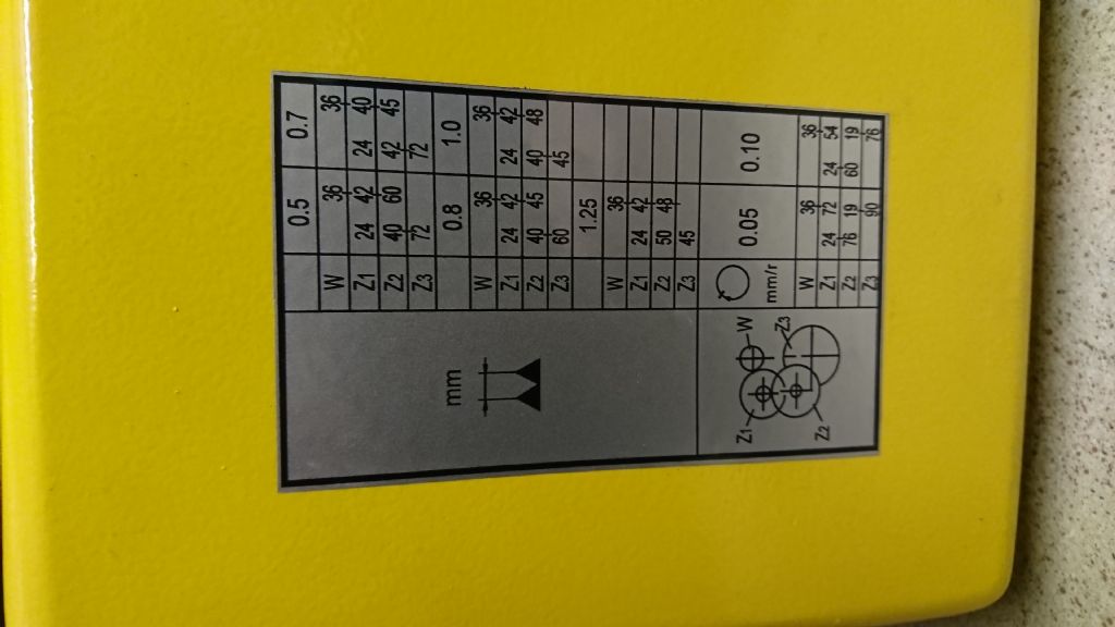

      I didn't bother with the fine feeds, the one that Ian quotes for 0.05mm does calculate correctly
      Brian

        Just looked again at the chart on the side of the lathe. Now it's all clear. There's lines joining the gears that are meshed.
        Cl250m metric gears

            Although looking at it the 50 should mesh with the 45 on the 1.25 pitch…..

                Posted by Brian Wood on 10/01/2021 15:07:43:
                Spindle [W] Driven Driver Leadscrew [Z3] Pitch mm
                36 72 40 60 0.5
                36 48 40 45 1.0
                42 Idler 90 0.7
                48 Idler 90 0.8
                40 Idler 60 1.25
                Just a couple of observations
                1. this lathe does not have a tumbler reverse so unless you like cutting a lot of Left Hand threads you may need two idlers.
                2. Like many of the far eastern lathes the spindle driver, 36T in this case is a larger bore and slips over the spindle within the nuts used to preset the bearings so not something you can change for screw cutting.
                3. I can't get 1.25mm pitch from the last line, that gives 1mm pitch 40/60 = 0.666 x 1.5 =1. If available 50 : Idler(s) : 60 would give 1.25mm pitch. 60 : Idler(s) : 72 would also do and looks like you have those gears

                  Posted while I was typing, yes keep the feed engaged and run the motor backwards to take you back to the start with tool withdrawn.

                    Hello Jason,
                    Thank you for your invaluable checking. You are right of could, a second idler will do the reversing where needed
                    I didn't know about the bore of the 36 gear although the paper chart lists a 24 in the same position so I assumed, incorrectly it seems, that other gears could be fitted there as required. That adds to the complications
                    My error completely for 1.25 mm pitch. It should read 50–idler–60; largely academic now but the maths is correct!
                    Retiring damaged now!!

                      Just to add a bit more damage, the last line of the paper chart will only give 0.1mm/rev if W is 36T

                        Maybe Ian could follow the printed chart in the gear cover and dump the misleading piece of paper, it might have saved Howard and myself quite a lot of wasted time.
