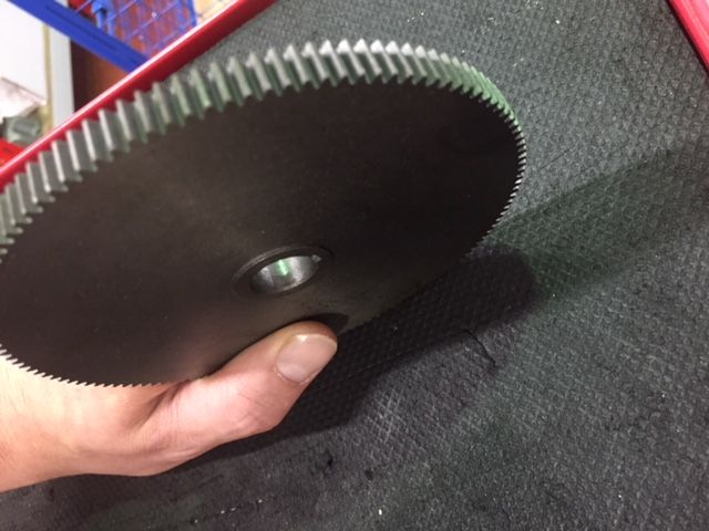

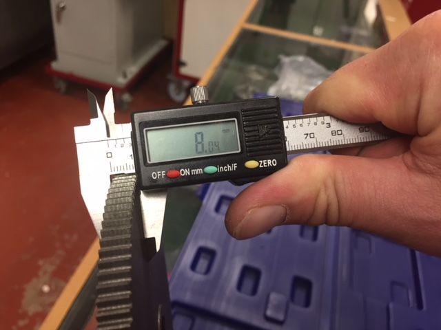

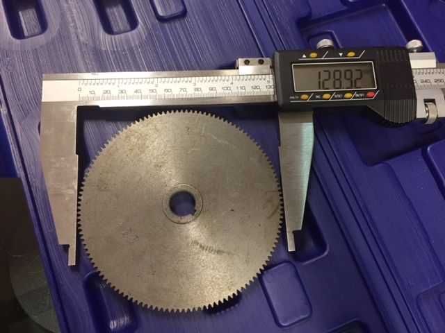

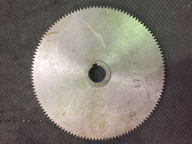

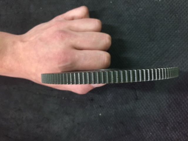

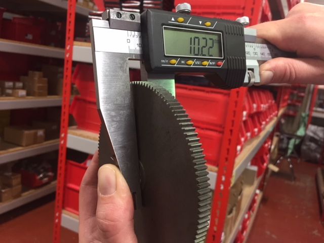

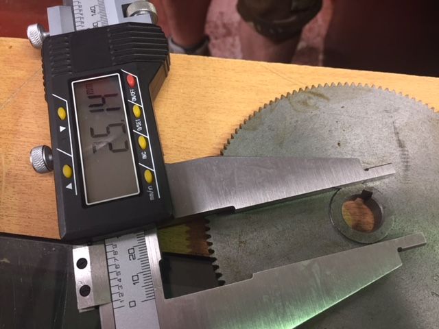

              Ketan Swali
                @ketanswali79440
                PM sent to Ian S for one piece which we have.
                We have ordered some 127T gears for general selling, which will be with us by end of September. Price will be around £24.00 ~ £25.00 inc.VAT for this gear. It is heavy at around 710grams.
                General dimensions are: Bore: 16mm, Keyway: 4mm, Width (thickness): 8mm, Width (thickness) near bore is: 10mm
                Some pictures below:
                Ketan at ARC.
                #365271
                  That's excellent, Ketan
                  It compares quite favourably with this compound pair for a Boxford: **LINK**
                  https://www.ebay.co.uk/itm/Boxford-Lathe-127-100-Compound-Gear-Imperial-to-Metric/283071577644
                  P.S. Unfortunately it's too big & heavy for my own current project sad

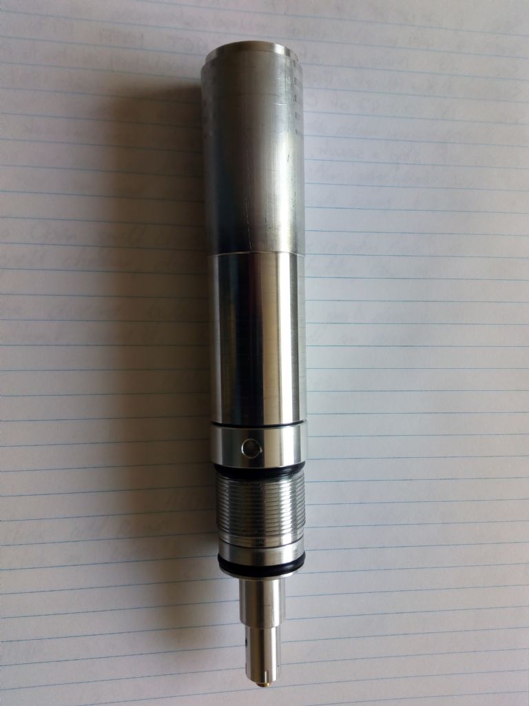

                                            img_20190502_180345.jpgI apologise for taking so long to show the components I needed to cut 14 tpi for. Below is the collection of parts the small item was bought in, the other two made by myself. The solid bar still needs to be parted and faced then drilled and tapped to take the guage assembly but it is very nearly done now as you can see in the photo above.
                                            My sincere gratitude to everyone that helped me to get this done.
                                            Ian
                                            Edited By Ian Skeldon 2 on 02/05/2019 18:39:17

                                            #407570
                                            Anonymous
                                              Nice compact reg tester Ian thumbs up
                                              Edited By Mick Berrisford on 03/05/2019 09:04:40
                                              #407574
                                              Brian Wood
                                                @brianwood45127
                                                Hello Ian,
                                                That looks like a nice piece of work, thank you for showing us what the collective prodding of grey matter helped you produce as a result.
                                                Regards
                                                Brian
                                                #407661
                                                Ian Skeldon 2
                                                  @ianskeldon2
                                                  Posted by Mick Berrisford on 03/05/2019 09:04:08:
                                                  Thanks Mick. Hopefully it will get lots of use as I still have a few AA's with regs that do not perform well.
