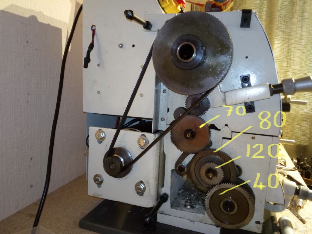

      Aagghhhh I think something is wrong here, I have a tumbler driving a 70T, driving a 80T with a 120T on the same shaft (a) driving the 40T on the feed screw gear box (b), I have selected position 9 on the gear box and a scratch test shows about 24/25 tpi.
      Is there something obvious I am missing or is it possible that the label stuck on the machine is the wrong one. Right now any ideas are very welcome.
      Please see diagram below showing the number of teeth on that given position.,
      Thanks, Ian

      Martin Connelly
        @martinconnelly55370
        120 tooth gear should be larger than 40 tooth gear. Have you got them the wrong way round because that's what the illustration looks like?
        Martin C
        #364613
        Les Jones 1
          @lesjones1
          Can you can confirm that the 80 tooth and the 120 (Which are on the same shaft.) rotatate exactly one revolution for two revolutions of the chuck ? Can you confirm that the 40 tooth rotates three revolutions for two revolutions of the chuck ? Can you confirm that with the gearbox in position one that the leadscrew rotated exactly one revolution for one revolution of the 40 tooth on the gearbox input ? Can you confirm that with the gearbox in position nine that the leadscrew rotated exactly three revolutions for five revolution of the 40 tooth on the gearbox input ?
          (I am assuming that the picture does NOT show it set up with the actual gears. I assume you have just used a picture with some other setup and marked it wit the gears that you have installed.)
          Les.

            Hi Martin,
            I was also thinking that Ian could have the 40 and 120 tooth gears swapped over but when I worked it out I would expect that to give 127 TPI. (14.11 x 9) Also the ratio of the TPI values between gearbox position 1 (1 : 1) and gearbox position 9 (1 : 0.6) Ian quoted about 22 TPI in gearbox position 1 and about 24 or 25 TPI in gearbox position 9.
            If he had 22 TPI in position 1 then I would expext about 37 TPI (22/0.6 = 36.66)
            Looking more closely at the chart in Ian's second post (22:09 on 22/07/18) there seems to be a difference between the ratios between fine feed and screwcutting. There may be a control that changes the ratio or fine feed may drive the carriage via the rack and pinion rather than the leadscrew.
            Les.

                I think Ian has just been using one photo and adding the numbers, look at the first photo on this page and it's the same as the ones with the writing on them.

                  Ian Skeldon 2
                    @ianskeldon2
                    Hi,
                    Yes the photo is the original photo, but I have edited it to show the current arrangement.
                    Howard, sadly I can't replace anything with a 127 tooth gear as I don't have one, the gears that I do have are listed much earlier on in the thread.
                    I will try to get another photo showing the arrangement but be aware that the 120 tooth gear will mask the 80 tooth gear.

                    Ian Skeldon 2
                      @ianskeldon2
                      Les, one full revolution of the chuck turns the 120 tooth gear 1/2 a revolution, so yes two full revolutions of the chuck, will rotate the 120 gear a full revolution. More information to come shortly.

                      Ian Skeldon 2
                        @ianskeldon2
                        Hi Martin, the photo is showing the old gearing but the writing is correct, Les your maths is spot on, the 40 tooth is doing 3 revolutions to every 2 revolutions of the chuck.

                          Ian Skeldon 2
                            @ianskeldon2
                            Les with the gear box in position 1, 1 revolution of 40 tooth produces one full revolution of the leadscrew, however 5 full turns of the 40 tooth gear produces aprox 2 1/2 (2.5) revolutions of the leadscrew.
                            I have taken another pass and the pitch is now easier to measure and comes out at 0.8mm giving if I am right about 32 tpi?

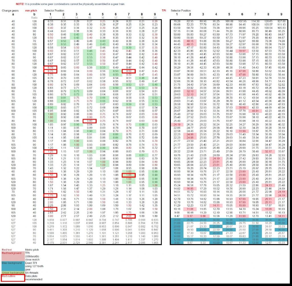

                                              Martin Connelly
                                                I've smartened up the spreadsheet of thread settings for the DB10 and created a jpg file but am limited to the quality of jpg that I can create from the spreadsheet. This is the result, clearer copies are available but would have to be emailed as something other than a jpg.
                                                Martin C
