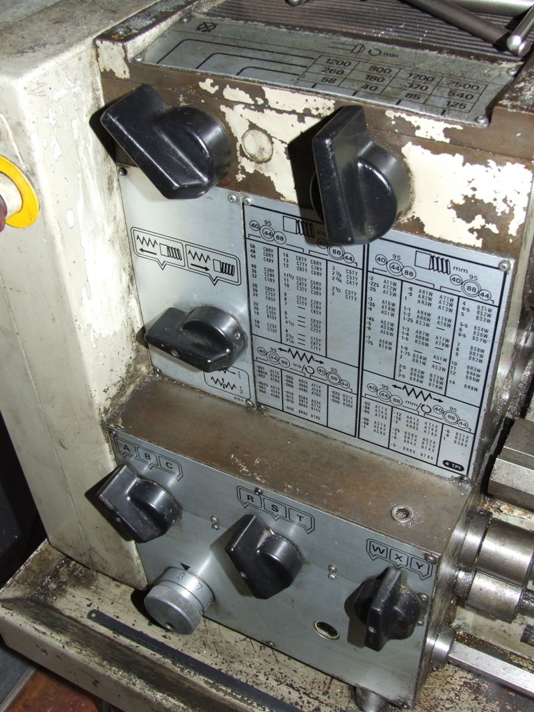

                      Posted by Ian Skeldon 2 on 23/07/2018 21:45:37:
                      Does anyone know if something like a harrison 300 would cut both metric and imperial threads?
                      I've got an imperial Harrison M300, and the answer is yes. Naturally the imperial threads are exact. The metric pitches are an approximation, using gears in the ratio 33/26 which gives 1.2692 instead of 1.27 so pretty close. These are the headstock controls, threading and feeds are set by the lower three knobs and 8 position rotary control bottom left:
                      And this is the threading/feed chart in more detail:
                      Not shown, but in the manual, substitution of a 56 tooth gear in the gear train allows diametric and module pitches to be cut. The gearbox uses gears in the ratio of 22/28 as an approximation to pi/4.
                      I imagine that many other comparable industrial lathes will have similar capabilities.
                      Andrew

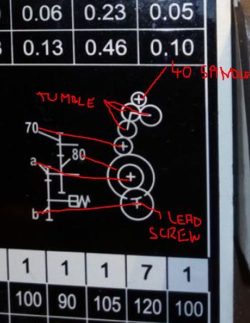

                        Redsetter

                                    Brian it is almost certainly going to have a 40T integral spindle gear so working out a few of the metric pitches from that suggests a 2.0mm pitch leadscrew.
                                    Position 1 seems to be straight through the box. For example using the 1.5mm pitch from the chart on the machine
                                    40 driver – 70 idler -80 = 0.5
                                    90 -60 = 1.5
                                    0.5 x 1.5 = 0.75 rev
                                    0.75 x 2mm pitch = 1.5
                                    Pity there is no 50T changewheel as that would work out well with a 90T driving it for 1.8mm pitch.

                                            This shows the closed gearbox version for those that want to work out the ratios. Drive comes in bottom left from the banjo geartrain then up to the layshaft, then back down and out to the 2mm pictch screw bottom right.
                                            Brian from the image on teh front of teh lathe the spindle is at the top with a fixed 40T gear. The group of three are some form of tumbler reverse for leadscrew direction and then down to teh 70T and 80T which seem to stay put. Finaly to A and B with B being on the input to the gearbox.
