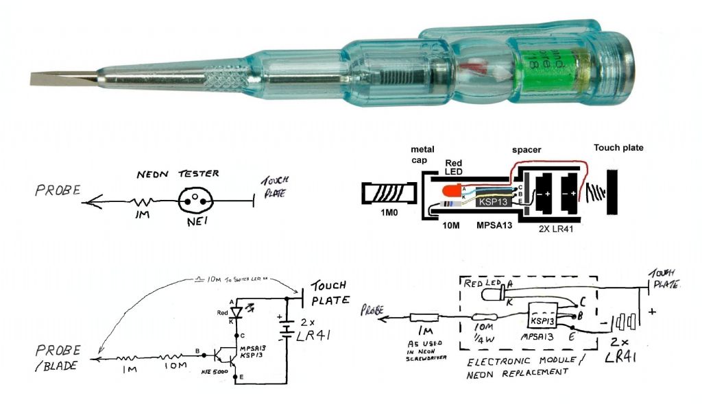

          Emergency stop press !
          It doesn't seem to work in cars (dang!)
          It only detects low DC stuff which originates from a mains supply

            the blade  is connected to the base of a NPN darlington transistor via a resistor of several meg ohms
            to light the LED the screw driver blade has to be a volt or so more positive than the end cap/ battery negative terminal
            if you touch the chassis with one hand and the tester/ screwdrivers battery cap with the other hand
            the LED does light when the blade is in contact with a +12V DC connection
            PS
            diagram

                Aha! thanks gents
                So contact work only on a car etc

                            In the early 1970s, I worked briefly for a TV Rental Company, where the engineers carried the neon-only version of these testers.
                            A favourite trick was to replace the dropper resistor with a fuse surprise

                              Exactly if that resistor goes short circuit you will be pluged into the mains, the electrians I worked with would never use them

                                I've rarely, if ever, come across a normal carbon type resistor go Short Circuit, only go High Resistance, or Open Circuit.
                                Capacitors on the other hand………..
