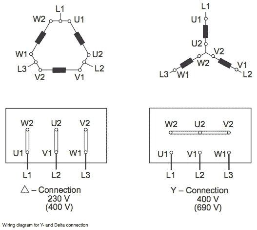

                                        A picture can be worth a thousand words.
                                        Mike

                                        #436113
                                        Brian H
                                          @brianh50089
                                          Many thanks Mike, that very helpful.
                                          Brian
                                          #436120
                                          Emgee
                                            @emgee
                                            Brian, nice clear detail in Mike's picture, are you up and running now ?

                                                  Back again!! Got the new bearings fitted to the motor and wired the inverter up to check everything before inserting the motor back into the base of the machine,
                                                  Success! thanks to all who helped, especially Peak4, Emgee, MickeyT and Mike Poole.
