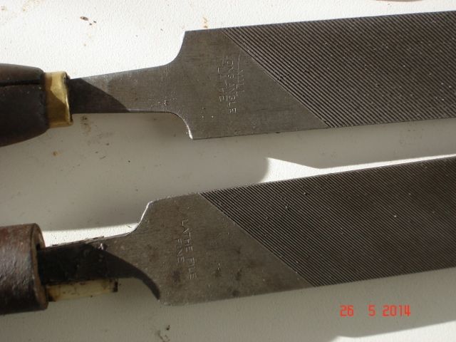

        Ian S C
          @iansc
          If you look at an ordinary single cut file, the cut is at about 30*, on a long angle lathe file the angle of the cut is around 60*. I'll have a go at a photo at some stage, I'v actually picked up three of them, one at the rubbish dump over 40 years ago, second one at an auction when I bought a pair of V blocks ex a NZ Army mobile workshop, The thrird one at the local second hand shop, cost $NZ2 brand new. Ian S C

                  #153766
                  Ian S C
                    @iansc
                    dsc00900 (640x480).jpgHere's a look at the long angle lathe files, One coarse, one fine. Ian S Cdsc00898 (640x480).jpg
