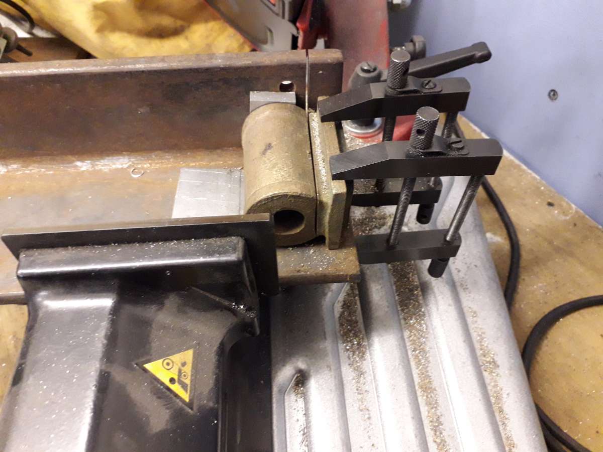

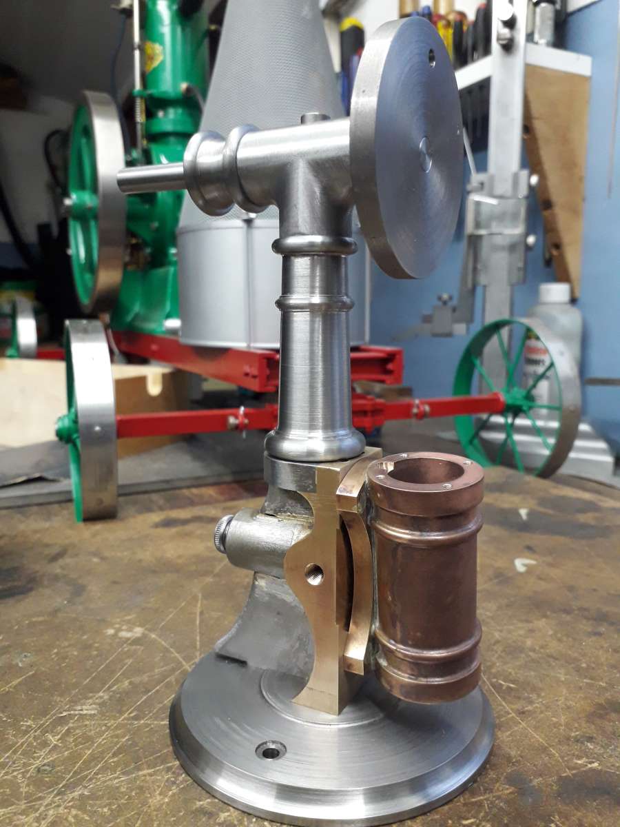

            The other option that I have used when recycling old cylinder castings is not to melt and recast them but use them as a source of hollow bronze/GM. Depending on the casting you can also make use of the chest as either a new chest of an end flange for the typical shape of a stationary engine cylinder.
            Only costs you a bit of silver solder and propane rather than a foundry set up.

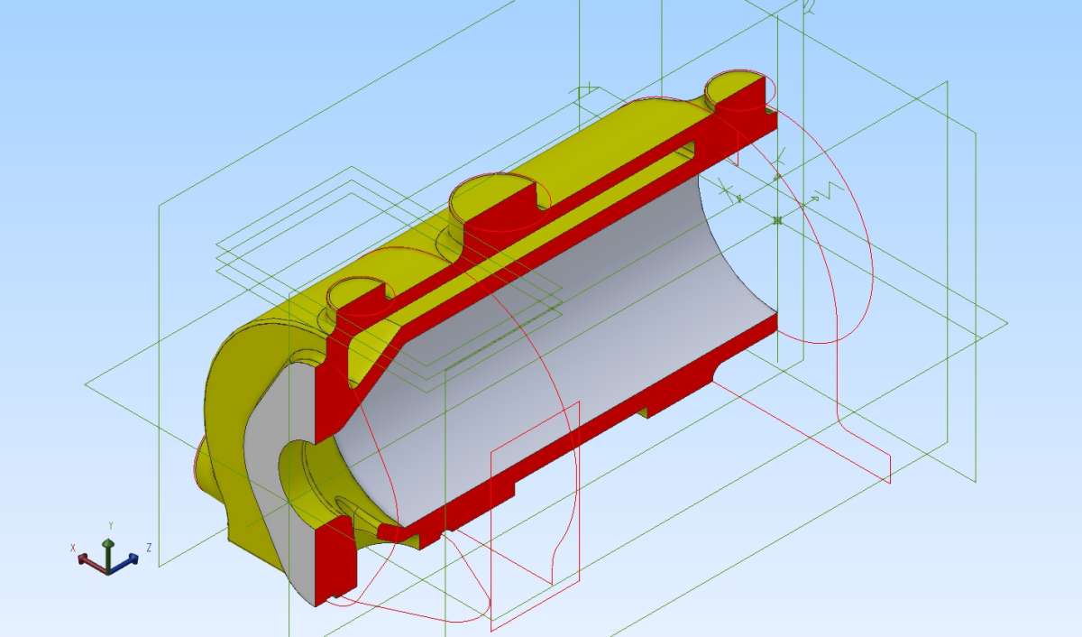

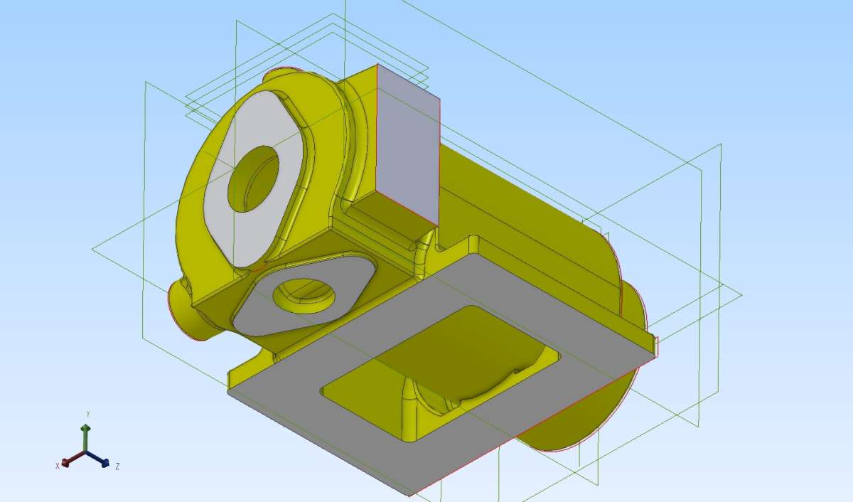

                Ah you do make it sound easy Noel, wish a bit of pipe would do for this I’ve just drawn.
                Pattern
                G10
                Cores in the sand
                G12
                Should come out like this with cast water jacket, exhaust port and the cored bore which has tool run out space and a tapered end down to a smaller diameter

                  Having had the pleasure of working in Bridport Foundry I was using resin bound sand for cores, very strong but easily burn out ! That looks as though it will be fun to mold. For the cylinder core 2 bits of steel, weld/tack together, bore out, to suit core then cut tacks and use resin sand. You make beautiful drawing look easy, every man to his own ? Noel.

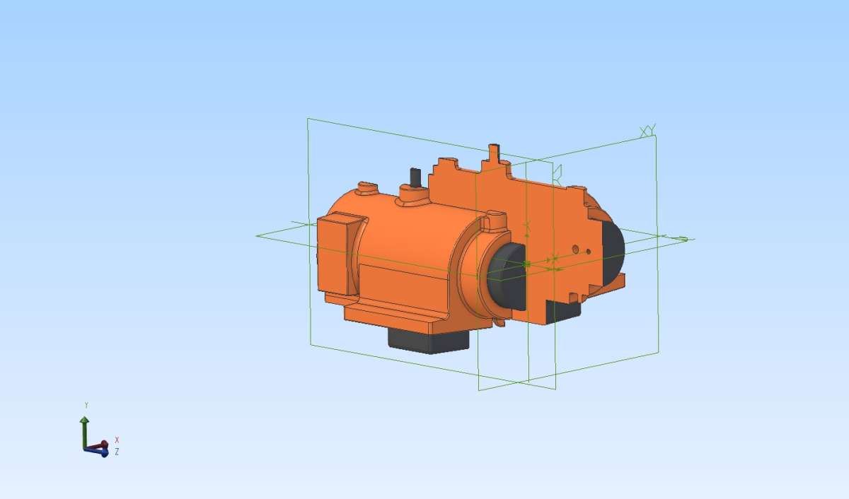

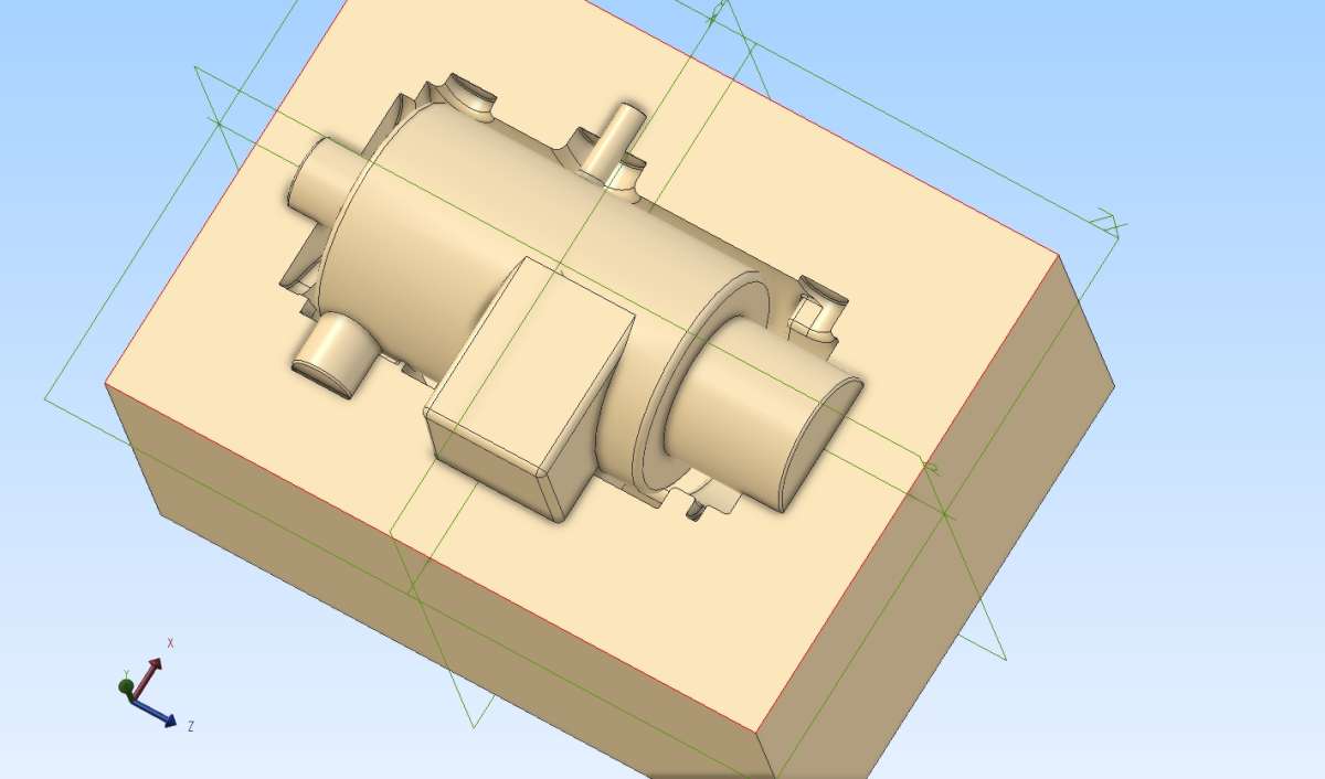

                    That one is down for 3D printed patterns & core boxes and being done in iron, all 27kg of it according to the CAD. Bit of reverse engineering for an early full size Gardner, about 11″ long and 4″ bore.
