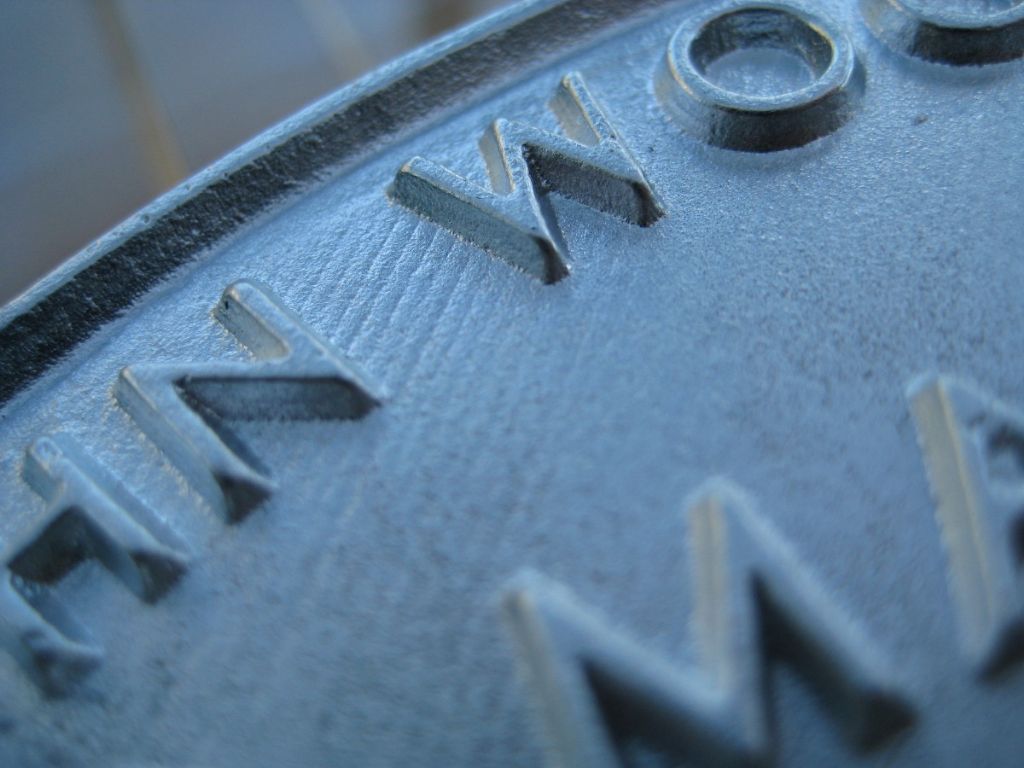

        I buy my sand, sodium silicate, bentonite and ingots from Artisan foundry supplies. They are based in Liverpool here in the UK. When I first started casting I was given some greensand and bentonite by a local engineer. Before that I bought fine sand from B&Q and used cat litter which in some cases is mostly bentonite. It was all a waste of time. This photo is of a small oval name plate I made for the engineer. I made it with his greensand/bentonite and cast it with a zinc/aluminium alloy. The letters are 8-ishmm in height and protrudes from the surface 2mm. You can see the layer lines from the 3D print.

          Lee, that’s really impressive. Quite similar to some projects I’d like to do.
          I was looking on the Artisan Foundry site. I see they have “Bromsgrove” greensand. But it isn’t clear if this is all that’s required or if it needs additives. What products do you use from their site?
          Steve
          #604039
          lee webster
            @leewebster72680
            Steve, I buy the Bromsgrove sand from them in a 25kg bag. I spread it out on a tarpauline in my conservatory to dry it for a few days, then use a flour sieve to remove all the bits bigger than fine sand. I loose about 2 to 3 kg of unwanted content. I then weigh the sand exactly, and seperate out one kilo. I add a small amount of water to the kilo, but not enough to make the sand wet. Very bad! This is why I do this with just one kilo, I am trying to determine how much natural clay is in the sand. With my last bag of sand I had to add 10% of bentonite before I felt happy. When I have the right mix, I can add bentonite and water to the rest of the sand which is then given a good whisking and is kept in a sealed container. If I haven't used the sand for a few weeks some of the water will have evaporated. I add a bit more water using a small spray bottle, give it a good mixing using something like a paint stirrer on a battery drill, and let it sit for several hours before using. If the sand is too wet I just leave the top off the container for half a day, stirring the sand now and then. If I have something like the name plate to cast, I will use a very fine sieve, finer than the flour sieve, to cover the surface with a thin layer of smaller grains of sand. Then I will use the flour sieve for put in 20-ishmm of sand, then just shovel it in to the top. I usually ram, not too hard, when the flask is about half full, then proper hard ramming when full. I allways pile the sand on high before ramming. I haven't got a muller for sand preparation, I just use the paint stirrer (home made) to fluff up the sand after each pour. Olfoundryman, Martin, and Swdweeb, Perry, on youtube are good people to watch. Martin is a proper pro, Perry is self taught and produces excellent results. Martin uses self prepared greensand and his surface finnish is second to none. His work makes my name plate look like it was made with a bag of boulders!

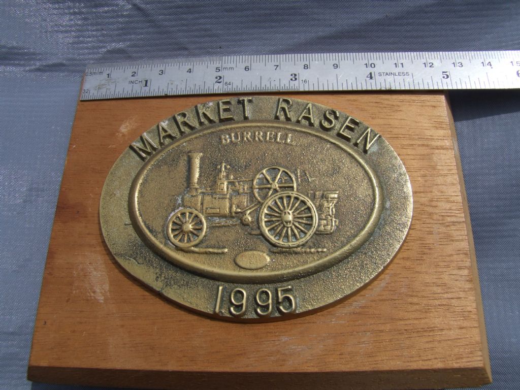

                These Foundry posts have really got going ! I started with about 100Kg of mansfield sand in 1995, I'm still using the same sand, I added nothing – but water ! It is stored in an air tight plastic bin and is ready for use at ANY time. Molds are broken open straight into the bin a little water added and it's ready for next time ! Parting powder to stop the sand sticking to the pattern, buy proper or use talc, perfumed or not to taste ! To administer make or for £3 buy the the proper bag. A flour sieve is good to put the faceing on, say 3/8"deep, then shovel half a box full and ram, a rammer can be almost anything, I use the handle of a 4Lb lump hammer. Then fill and ram above the sides of your mold box and strike off flat with any straight edge – hacksaw blate, steel rule, bit of wood Etc Once made the mold will last almost for even, I have an impellor mold I made about 10 years ago, not got round to casting it – yet. For those with welding gear the easy way to make mold boxes is to visit a scrapyard and buy a length, say 3' of LARGE box section, 100 x 100 x 6 upwards to say 500 x 150 x10 and slice into 2" or3" thick slices, weld on 10mm round bar handles and locating bosses for the pins, eg 20mm box 1" long, pins to fit and a T handle on top. The weight of the boxes is important as the metalastatic force of the molten metal will "float " the cope off with even small castings, even so added weight on the top of the cope WILL be needed I use lead ingot cause I have them ! COPE (worn over the shoulders) = TOP ! DRAG, (what we do with our feet ) = BOTTOM- simples ! ONLY POUR MOLDS ON A SAND FLOOR, or a sheet of dry timber NEVER NEVER on concrete, stone or gravel, ignore this simple point and you may findout what it's like to stand over a grenade when it explodes and the shrapnel may still be molten !!!!!
                I will try to add a photo, the date shows it was made not long after I had started the foundry, and we would do steam rallies showing how a foundry worked even if only with simple work. Look at the detail ! Using the method described, a homemade furnace and tools and working almost literally "in the field " I would say that the only way you would get better detail is using the Lost Wax Process.
                Some may say otherwise but for me using brass, and the only part I bought was a dip pyrometer, though even that was adapted to suit ! It tells me the temperature which I say is vital for non ferrous metals, cost – about £80, money well spent !
                For those who say they couldn't do I say try, it's not rocket science, the Greeks and Romans did it without half the knowledge you have on tap here ! Good Luck, Noel.

                  Steve, The Bromsgrove sand I got may have had bentonite in it as a natural ingredient, it just wasn't enough for me. I was given a bag of sand to try a couple of years ago by the engineer I made the name plate for. It needed sieving too, and I added some bentonite to it. My very fine sieve has holes at about half a mm. The ordinary sieve is about 1mm. I have coarser sieves when I need to speed things up.
                  If you find a supplier of ready to use greensand please let me know.
                  Noel, that is a great plaque! Did you 3D print the pattern?

                        Hi Lee, Thanks .The back ground is a perspex disc covered with a double sided adhesive tape, the lettering is traditional white metal foundry letters , I have sizes from 1/8" up to 4" in several styles and the relief in the centre is a brass stamping. I'm not sure 3D printing was even common in 1995. Noel.
