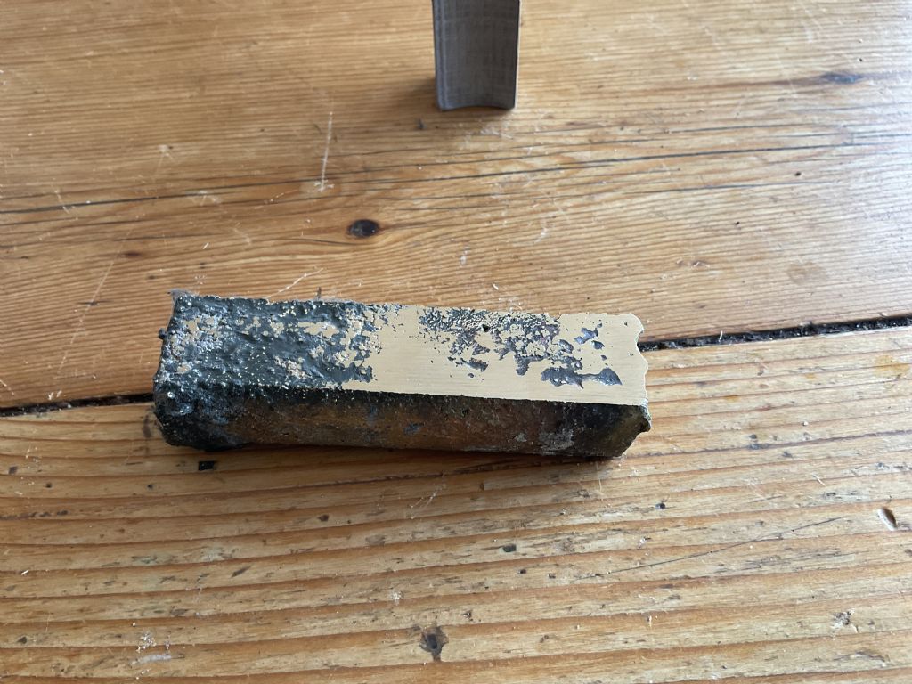

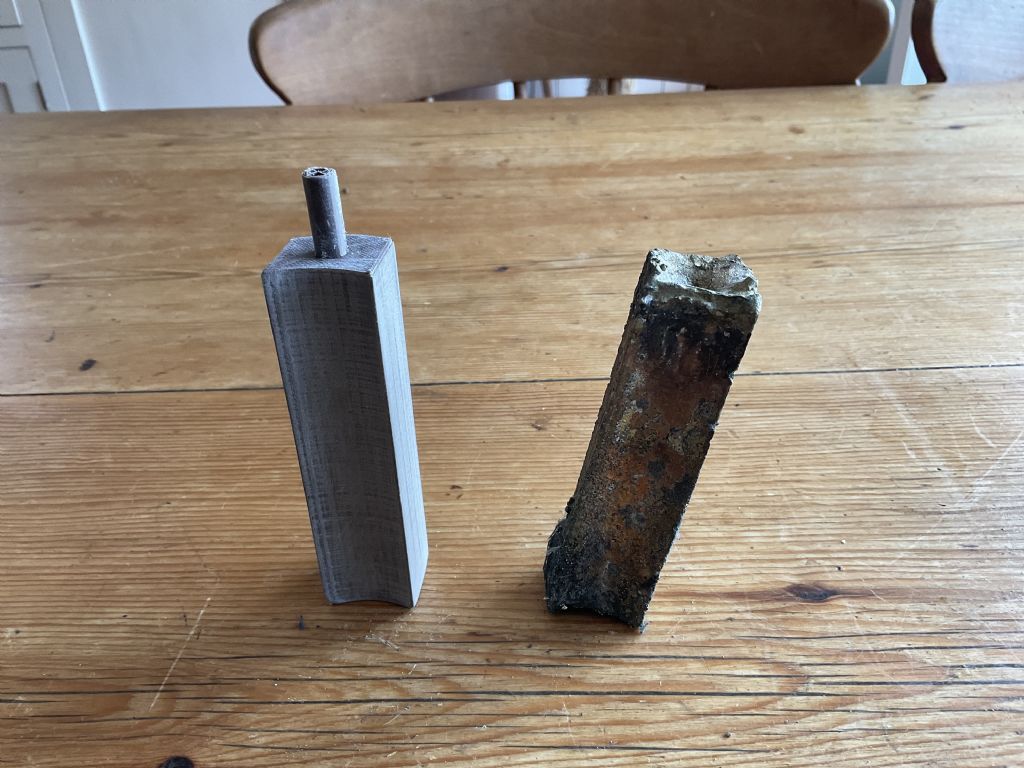

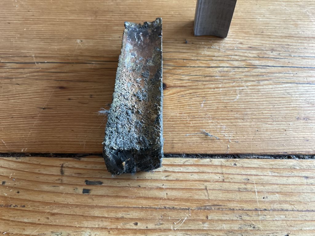

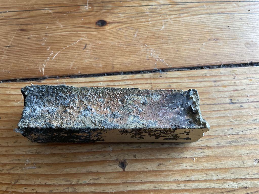

      Is there anyone out there who has advice for a total beginner at sand casting?
      I made a waste oil burner and furnace, after a lot of tinkering it’s working pretty well and can get up to 1100 deg C or so without too much trouble.
      My first project is to make some brass sanding blocks for making woodwork moulding planes. I made a pattern on a 3d printer. I used play sand (fine and consistent) and about 10% fireclay as DIY greensand.
      I used a cast iron flask, packed down the pattern in the sand vertically and removed it carefully. I melted down the brass and poured it in. The result was, well, roughly the right shape, but it had a big nodule on the bottom (presumably caused by the pouring brass) and a terrible pitted finish.
      of course I can sand out some of the pitting, but that’s not the point.
      Does anyone with experience have any tips? See pics. Yes it’s terrible, I know.

            If you are getting up to 1100 degrees then the zinc in the brass will boil away (boiling point Zn 907C) so the first suggestion would be to keep the temperature down. Zinc fumes can be dodgy too.
            Aluminium which melts at 660C as against the 930C for brass might be an option.

              Yes, it was an open mould.
              I could buy some commercial sand, but it isn’t cheap, and really this is a learning activity for casting a slideway and carriage I want to make for a bench tail vice. So I’d need a lot of it. Is there a cost effective way to get good sand?
              I’d say the bottom of the casting is about 1/32 wider than the top. I assume that’s because of the weight of the liquid brass above it. I’m thinking that I might be better to try casting it properly using a cope and drag type flask.
              the critical bit on this piece is the curve – it must be accurate to form an accurate (+/0.005) sole on the moulding plane. I could use aluminium, but I wanted some nice brass ones. TBH the pattern actually works fine as a sanding block for the purpose intended!
              And yes, at about 1000 deg there was lots of white flame and smoke, which I assume was the zinc burning off. Quite spectacular.

                        Don’t worry about the furnace temperature; the melt temperature is more important. 50Deg superheat is what you looking for; you just need to pour quicker. My furnace runs much hotter than the melting point of iron, and pouring brass etc. is no problem. For fuming; somewhere on the forum I posted a DIY crucible topping mix to help with this, but if the melt is fuming it’s probably already too hot.
                        If you spend a lot on backyard foundry work you doing something wrong. The cruicible is really the only consumable, and when I started I even made those. My waste oil cost nothing. My lining has lasted 10 years, and my green sand is still what I mixed all those years back. I’m not sure how it will ever go off?
                        What you trying to do is actually difficult. It’s much easier to cast something with a large surface area to volume ratio (casting modulus), like cylinders etc. than a block like you want to cast. You on the right track with an open mould like you cast but I suggest looking at the following:
                        Ram on the split line, and pour down the split, with the open end like you did it. Straight after pouring sprinkle some coal over. This is like hot capping and forces the draw from the top surface to prevent shrinkage defects in the mould. The pattern needs to be longer and the top is skimmed. Alternatively core the part.
                        The reason for splitting is to improve ramming. If you dust the surface with cake flour and go over it with a feather duster you’ll get a very good surface finish.
                        Check the play sand, the way it’s washed rounds the particles making it less suitable for casting. You want flat ‘sides’ of different shapes when casting to improve the binder and sand lock. My sand is from the local river with bentonite and other additives from the grocer/ garden shop. Practically most sand will work but the binder needs to be adjusted for the surface area etc.

                                              Ramming is compressing the sand around the pattern, either by using your fingers or a wood mallet. Here's a video I did for someone, which should give you a few pointers…
                                              With your pattern, feeding (basically stopping draw) is going to be a problem and any riser will be large. Your open mould is how I would do it with the coal, as mentioned, sprinkled on the top after pouring.
                                              The burn-on you got at the bottom is typical when pouring directly into the mould cavity without an ingate. Normally this cleans off depending on how hot you poured. The flour will help. If you want to fix this then you need to change how you fill the mould.

                                                I would not worry about surface cosmetics too much.
                                                That can be resolved over time.
                                                If you don't control the metal velocity as you pour, you will get splashing, air aspiration, mold degradation, sand washed into the molten metal stream, etc.
                                                Think of pouring metal like pouring a beer.
                                                If you pour a mug of beer from a tall height, from straight above, you get a multitude of splashing, foam, etc.
                                                If you pour from the lowest height possible, sometimes resting the lip of the crucible on the top of the sand mold, then you get a much more smooth pour.
                                                Scraped ways on a lathe have an introduced surface defect, and that does not affect the performance of the metal, so it is not out of the question to use castings with surface defects.
                                                I have tried various methods to stop the lid leak, and found it impossible.
                                                The lid leaking will not affect furnace performance.
                                                The total amount of combustion air being forced into the furnace will equal the sum of the gasses exiting the furnace lid and the gasses exiting the lid joint.
                                                No big deal; all lids leak. Just ignore that.

                                                Steve355
                                                  @steve355
                                                  Luker
                                                  I see, thanks.
                                                  I think I have realised that I’m barking up the wrong tree with this particular part, because of shrinkage. It’s actually supposed to be a precision part, with the arcs on the picture being 60° of a 2 inch circle, plus and minus 15 thou for sandpaper. The reason I wanted to cast it, was because I couldn’t see a way to machine it with the machines I have. But casting just isn’t gonna give the accuracy I need. We live and learn!
                                                  Never mind, I have another pattern printed for a different thing, a stamp for wood.
                                                  I am determined to crack this though, so many possibilities open up if one can cast parts then machine them.
                                                  I think what I’m going to do, is order some proper greensand from sdts (actually not as expensive as I thought) then I’m off abroad for work for a couple of weeks, then I’ll come back to it.
                                                  Thanks for your help

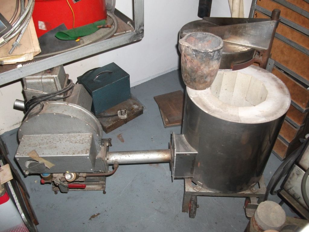

                                                    Eventually i got fed up with the tin can and coke furnace and built this modified Dave
                                                    Gingery furnace (in about 1989) supposedly will melt 20 lb of cast iron in 45 min i don't know if it will
                                                    I've never tried it with iron , an A8 crucible will fit inside.

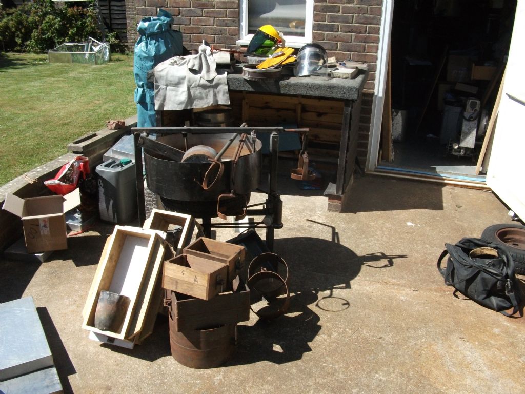

                                                    The thing is when you have done some of this you tend to forget how much equipment
                                                    that you have accumulated over time, the furnace the crucible some sand and then all of the other
                                                    stuff that you need lifting and pouring rings , moulding boxes, patterns and some
                                                    decent safety equipment and so it goes on ,it all adds up to some expense in both
                                                    money and time.
                                                    The 2nd photo here shows some of this stuff in the foreground some moulding boxes,
                                                    crucible , lifting tongs, pouring rings , behind , a copy of Luckygen's sand muller a recent
                                                    addition ,at the back leather aprons leggings face shields and gloves.

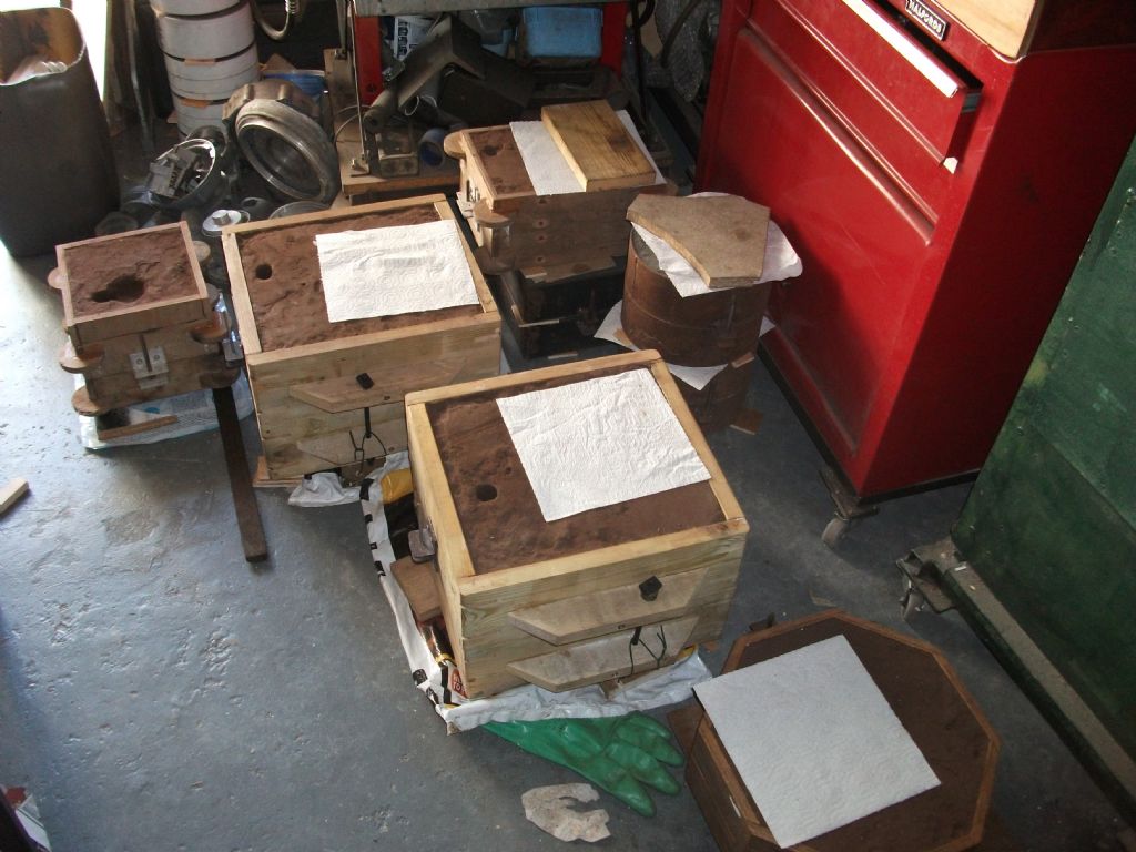

                                                    I don't do much foundry work the last time was about 15 years ago but in the next week
                                                    or so its getting fired up again if the weather stays fine. 3rd photo.
