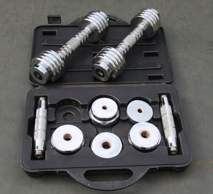

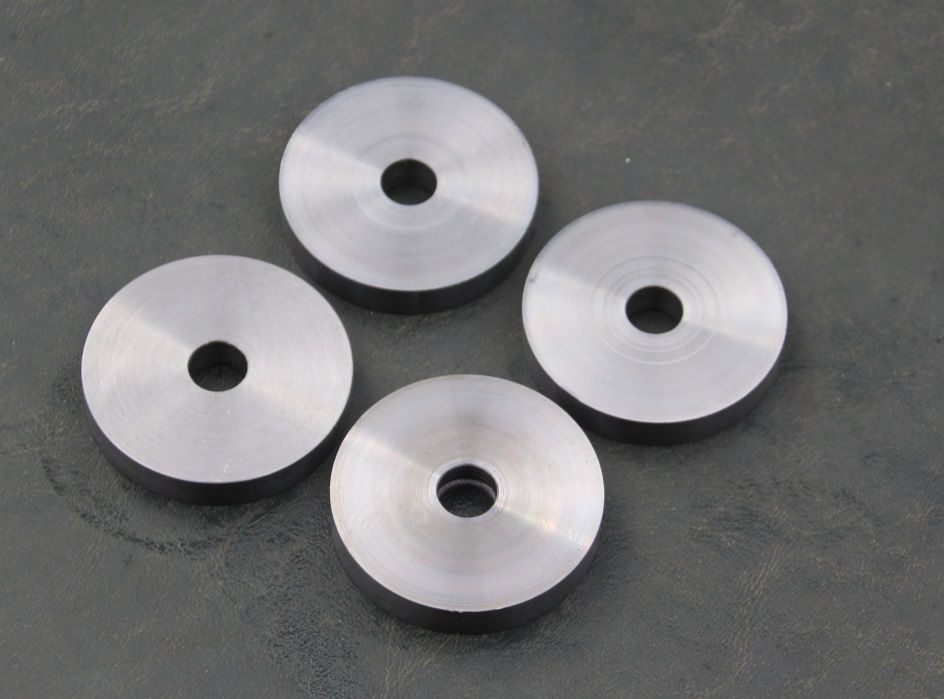

                                  #154324
                                  Rik Shaw
                                    @rikshaw
                                    These weights have been finished turned and are destined to become the crankshaft webs for a model I have in mind. Suprisingly nice quality steel NOT cast iron.
                                    These fine carcasses await Mr. Warco the butcher – (Evil cackle!)
                                    Rik
