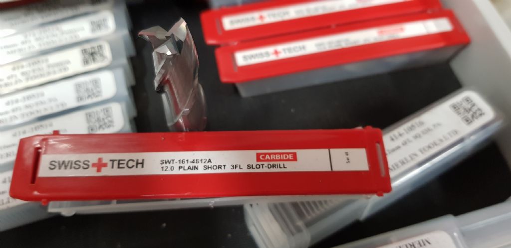

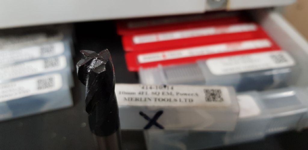

                  Hi Iain.
                  I bought a large amount of carbide cutters some time ago. These are top or good quality ones . I did as you say make a boo boo with one of them by dropping it from memory. Or coming into the work to fast. See pic.
                  But when treated with respect they are quite an amazing cutter to have in your arsenal. Just yesterday i was cutting steel for some vice holding clamps & the ease of cut & finish was very good.
                  Steve.
