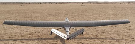

                            +1 for ZAP epoxies – I use it extensively building these…Works very well
