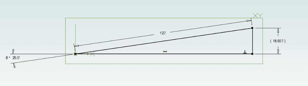

      I am going to make an R8 gear cutting arbour and have been trying to work out the packing for a sine bar to set the taper turning attachment.The included angle for the taper is 16.51deg and I have calculated the vertical at 18.23 with trig,.I am not confident that I am correct,could some kind soul give verify this answer please.I havn't done trig since 1964 so remembering is a struggle.

                No wonder I can't get my head around trig,The sine bar is 5".

                  I just use CAD, enter angle an 127 and it gives the height

                    The sine of the half angle (8.425 deg) is 0.1465. For a 5" sine bar the gauge block stack for this angle is 5*0.1465 = 0.7325"
                    Martin C
                    This is based on an angle of 8 deg 51 mins. I think some diagrams have this as 8.51 degrees. Not sure which is correct.
                    Edited By Martin Connelly on 10/06/2020 19:47:15

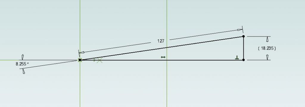

                      Well the value 18.23 is right for 16.51 degrees but I don't think the angle is correct. I think it is 16 degrees 51 minutes which is 16.85 degrees. That would give 18.61 mm
                      Does anyone definitively know the angle as I have seen some other forums arguing what the angle is.
                      Adrian
                      #478979
                        Model Engineers Handbook has it as 16deg 51 mins so that's 18.607mm

                          Thanks for your confirming my effort ,I can proceed with confidence.

                            Crawford collets has 8 deg 25 mins for the half angle. Seems conclusive that people who are using 16.5 degrees have misread (or copied someone else who has misread) the angle when written as degrees and minutes as a decimal value.

                                        Confusion abounds, but my figures agree with Jason's. A 5" sine bar should be lifted by 18.607mm ( 0.7325" ) to set a taper half-angle of 8.475°

                                            If the included angle is 16.51 degrees, the half angle is 8.255 degrees. Sin 8.255 is 0.1435789.
                                            To incline it at 8.255 degrees, a 5 inch Sine bar would need to be raised by 5 (0.1435789 ) inches which is 0.7178949 Inches or 18.234531 mm.
                                            So 18.235 mm should be fairly close, but some slight lapping may still be needed for an exact fit..
