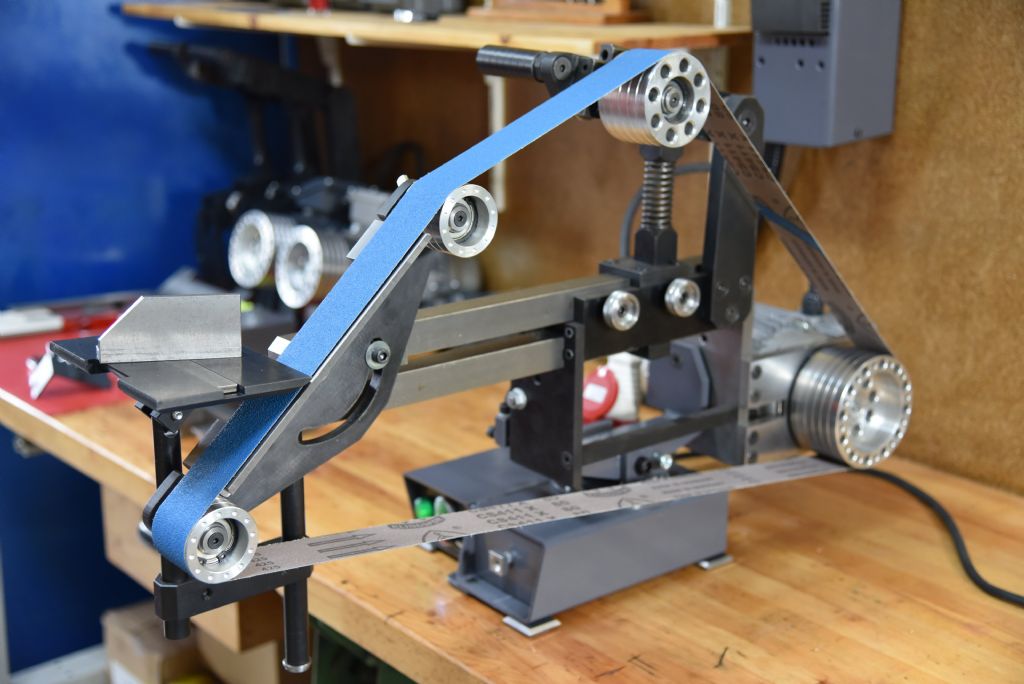

                                  Jack, thanks for your input, but I'm not using it for knife making, it's for general fabrication work, which is why a 4 inch belt is more useful for 'ME' what I want from the machine, I had a 1 inch grinder, and it was next to useless for what I needed, the machine I'm planning on building should be able to use 4×36 and 4×48, the former are cheap as dirt and widely available, the later are not expensive either really, but yes you are correct, if knife making is your thing, 2" is the way to go,
                                  grinder
                                  This is the style I'm planning on building, but with 4" belts, and 48" not 72" so reduce the size down, the design allows for different length belts, and I should be able to make it very compact, I'll be building the frame out of 10mm thick cold rolled steel not ally like the picture.
                                  Not entirely sure what motor set up to use yet, but thank you to everyone for their input, it has been helpful, and those of you who mentioned, I'm still interested in seeing your machines,

                                          Peter F, the machines shown in your two pictures look brilliant!, I want one!
                                          Do they exist, one looks a photograph but the first one could be a rendered 3d model. Either way do you have nay more info or links?

                                            Peter, there is a fundamental floor in the design of that first model. I made the same mistake on design.
                                            When you build yours, make sure that the guide wheel (top wheel) moves through a horizontal arc to the belt.
                                            I will post again with pics of my different designs and the pit falls.

                                              Ian, the first one I'm not sure if it's a 3d rendered model, but it is a real machine that is sold, both are just random pics I found on Google images, if you google 2×72" belt grinder, you'll get loads of this style of grinder, 2×72" seems to be the in vogue size in the knife making community, they are a very versatile design, which is why I want to make a similar design, but with shorter belt and wider, there's an American company that makes one that is in the region of $4000.

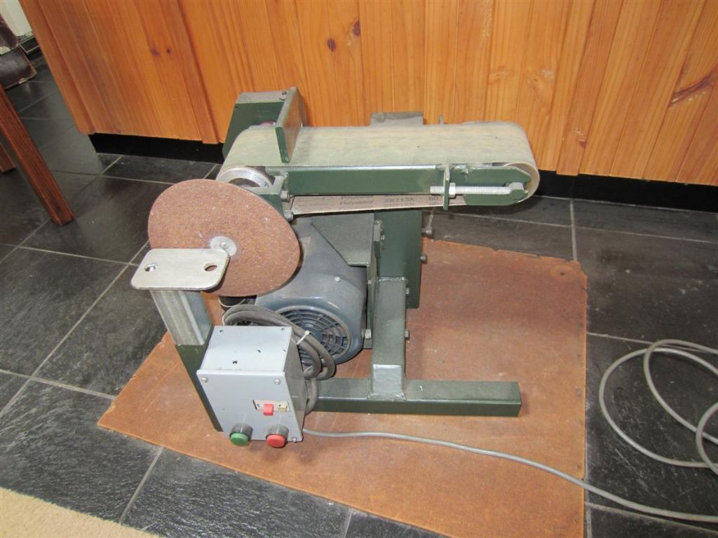

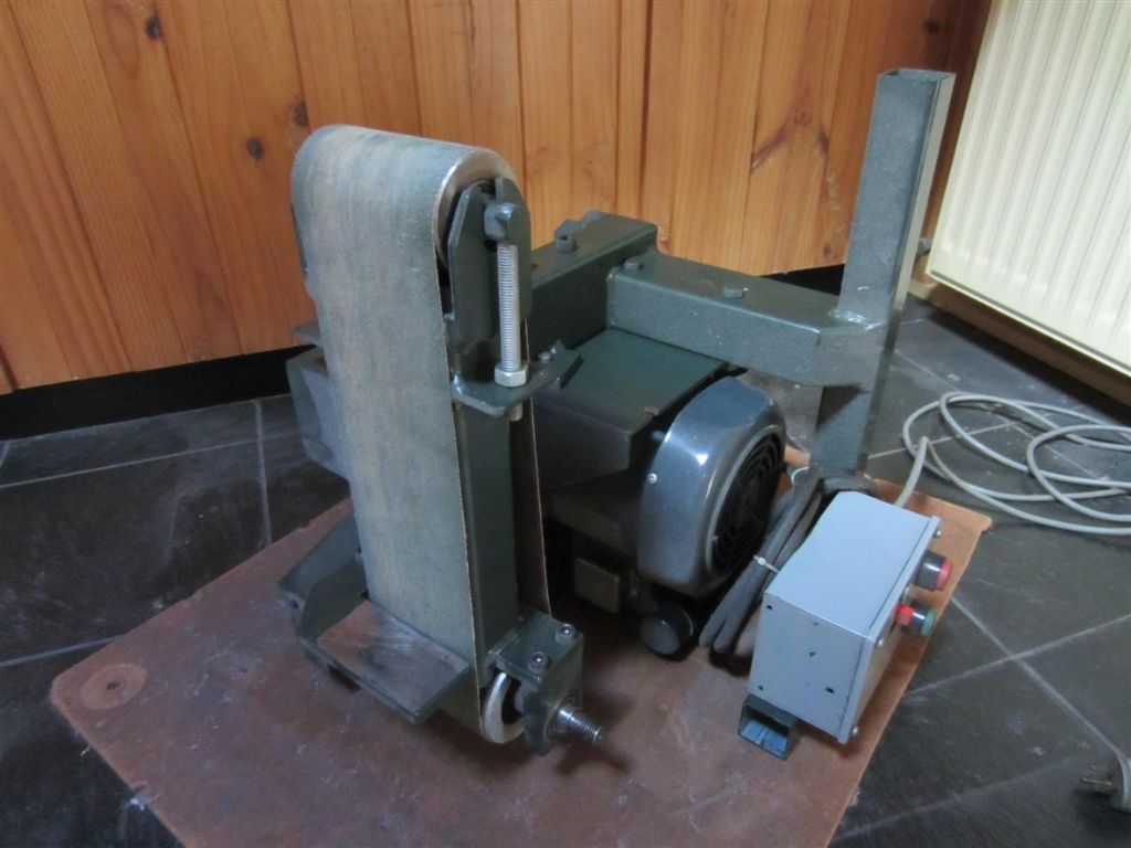

                                              #406447

                                                Terry, do you mean the tracking wheel isn't moving up and down completely vertically to tighten the belt?

                                                  The tracking wheel moves up and down to tighten the belt but can also be angled to track the belt on the rollers.

                                                    Paul, Terry said he made a design mistake on his, that was present on the first picture I posted, what is this design fault?
