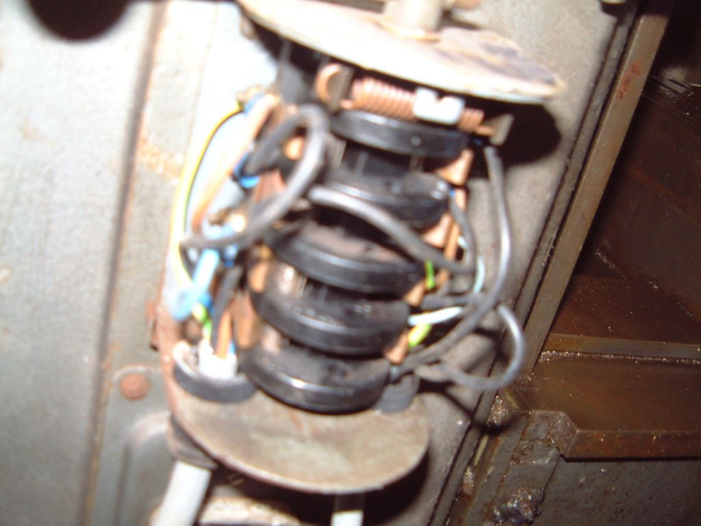

                            Hi All,
                            Sorry to resurrect this post, but I am trying to find what might be the fault with my CUB motor, which appears to be the same as the one you are all describing. Not really able to access the plate, but I can read 'Cont' Rating Speed 1420, and possibly .5 HP, but too difficult to read. However…
                            My problem is that my old Beaver milling machine has this motor, controlled by a Dewhurst on/off switch (OK I know about the feelings of this switch, but that's not the issue her I hope). When I switch the Dewhurst to forward and carry out what I want to do ( usually just drilling a series of holes), switch off and when I want to start again all I get is a humming noise. I have to turn the Dewhurst switch to off, and usually have to wait for a minute or 2 until there's a 'click' and the Dewhurst will switch on again. I think the 'click' is from to motor, but, as I said, it's too difficult to access where it is.
                            Any thoughts or advice would be greatly received. thanks in advance.
                            Geoff

                              I suspect it could be the centrifugal switch in the motor sticking in the open condition. The click may be the switch dropping back to the closed position. Have a look inside the dewhurst switch and check how many wires (Other than the earth wire.) go between the switch and the motor. If there are only two then the fault is almost certainly in the motor. If there are four then post a diagram of how they are connected to the switch. Do you have a multimeter ? This is so we can get you to do some tests to prove it is not the dewhurst switch. Is the switch a forward – off – reverse switch or just off – on ?

                                  Hi Les,
                                  I have removed the switch (as we speak!) and there's a lot of pitting, which I will try to clean up, possibly in the lathe. There are 4 wires from the Dewhurst to the motor. As you look at it from the top left:Brown, next: Black, next: Blue (bottom peg not used). Then one Black to the 2nd peg on the right.
                                  Just about to follow the Youtube video – Beachcomber Bob. Looked at it before, now I'll try to follow it, LOL!
                                  Can't do anything more right now until I get it all re-assembled. Thanks for your response. I'll be back asp!

                                      Hi All,
                                      OK, so I have removed the Dewhurst Switch and cleaned it up, removing the burrs from the pins etc. Put it all back together and onto the motor, and it works as it should: dscf4374.jpg
                                      My camera batteries failed just as I was going to take a pic of the motor. I've been able to swing the mill head around and there is what I assume is the capacitor on the outside – about 3 inches long by 1.5 inches diameter, sealed at base with what looks like pitch. The motor runs OK, but when I've run it for a few minutes, like this morning, it takes several minutes for the power to be restored. I assume now that the 'click' I hear is in fact the centrifugal switch. I don't think it's something that I can actually tackle, so I'll look around for someone that knows what they're doing, LOL! Even if I remove said motor, and remove the base plate I assume there's not much I could do at this stage to find the fault. Electronics are not my specialist subject I'm afraid.
