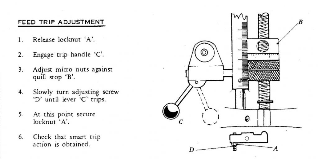

          I wonder if anyone can help me, I have an Adcock and Shipley Bridgeport mill circa 1976, can anyone tell me how to adjust the mechanism which kicks out the drive when I am using power down feed.
          The feed works o k in both down and up modes, but when I try to get it to stop on the knurled vertical screw, it just "ticks" and doesn't throw the lever outwards I notice these is a small mock allen screw underneath the shaft which bears on the rectangular bar which fits between the upper and lower pieces, has this any bearing on the "stop" function?
          Further, on trying to engage back gear, there is an abominable noise, sounds like the dog clutch is not engaging properly, has anyone any ideas on how to fix this please?
          You can contact me on keithrussell10 <at> yahoo.com

          #158012
          Les Jones 1
            @lesjones1
            Hi Keith,
            This may be what you want.
            This is from a PDF I have of the manual. (It may not be the correct version for your machine.) Let me know if you would like me to email a copy of the manual to you.
            Les.

              Hi, This message for Les Jones 1
              Hi Les, not sure if you got my previous mail, still trying to work my way round this forum, a bit complex for an old timer!!!
              But just to say thanks very much for the information regarding my Auto down feed
              Kind regards
              Keith Russell
              #158423
              Les Jones 1
                @lesjones1
                Hi Keith,
                I've just had a look at my inbox to see if I have received a PM from you and I have not. The PM system on this forum is very useful to exchange email addresses without putting them on the forum posts. This avoids the risk of spam. I hope the adjustment solved your problem.
                Les.
