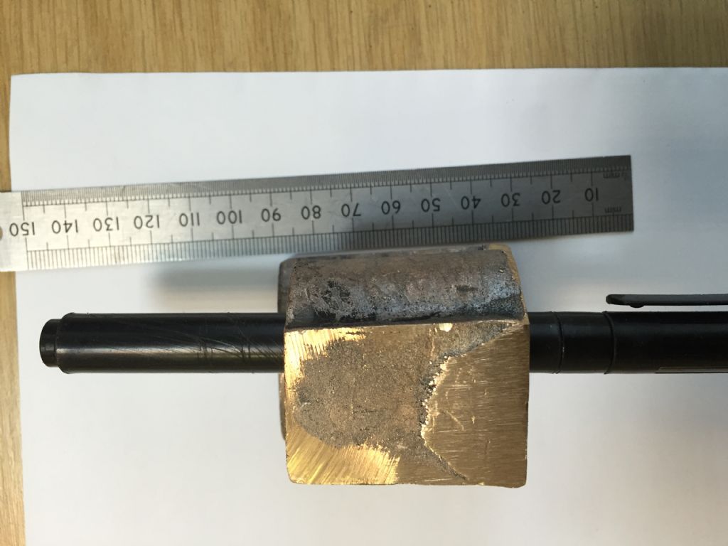

        Bit worried because the casting seems to have a taper down the one side, not sure if i should try and machine the radius.
        #249903
          I ended up machining every surface of mine. Leave the outside until later then you van mount it on a simple arbor and take a few passes over teh curve to tidy it up.
          Is your casting just the cylinder block without the saddle?

            Hello.
            Yes its got the saddle on, its not a very clear picture sorry,
            as you say i will machine the 2 bores, then try and true the rest up to it.
            Thanks.

                Hello Brian, I'm sure the Cylinder casting has plenty of spare 'Meat', so don't be worried about the taper.
                If you first measure up the smaller end and set up to start machining that smaller face and then the bore, you will be ok.

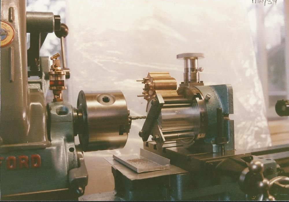

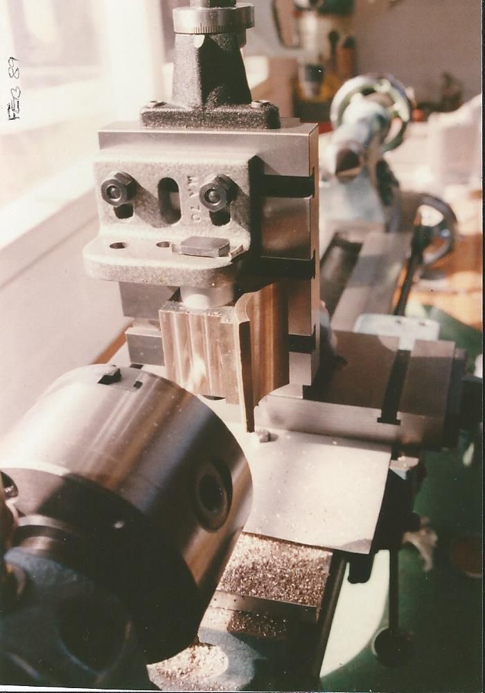

                        Ok, found 2 pics that may help, sorry about quality. Don't know your equipment stock levels, but the pics should be self-explanatory….if not-
                        I used the Vertical Slide for most of the faces, including fly cutting the saddle underside using a 1. 3/8" dia boring bar between centres.
                        In this pic, you can see the thickness of the Saddle face is also tapered (top face not yet machined). Taper is there for a reason and built into the Pattern for retraction from the casting mould.
                        I used a 4" Rotary Table to machine the top faces of the Saddle (and drill the bolt holes). In this pic the Cylinder is bolted to a slice of machined-to-size Aluminium Bar rather than Mr Mason's method.
                        Set ups may be crude in workshop procedures, but all went fine and accurate for me… being a Dabbling Novice.

                          Sorry , forgot the other picblush. Not used to no Preview facility….cyl machining 2.jpg
