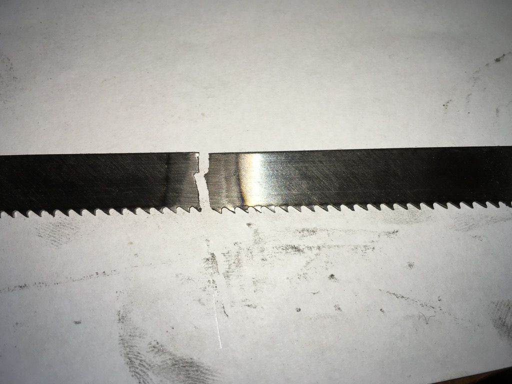

      I seem to be breaking bandsaw blades too frequently and wondering why.
      I've got an Axminster engineering series band saw. Using axcalber blades. 1440mm x 1/2" 10TPI. Blades seem to break along the welded join long before the blade becomes blunt. Generally the saw starts to 'jump' when the join passes over the cut metal and if I look at the join it shows a crack starting to form. Shortly after it will break. Its hard to guess how long I've used a blade, maybe an hour total time.
      I wonder if I'm doing something wrong. I tend not to release the tension when its not being used, is that bad practice? Should I be using a different manufacturer? any ideas please?
      This is the blade that broke this afternoon.
      Thanks

                Don't throw the blade away, you can silver solder it back together again. Plenty advice on youtube. I have also noticed the jumping as a blade is about to break and wonder if badly adjusted guides may cause this.
                Doug
                #439874
                Clive Foster
                  @clivefoster55965
                  Something very wrong going on there. A professionally made blade shouldn't break at the join like that until its very old and well past its use by date.
                  I've had them go in a similar manner, including the jump, when I've cocked up the joining using the welder on my Startrite saw but that was pure operator error. Either poor welding technique or not getting the blade straight so there is a step on the back at the join. I rarely have problems when making the 112" blades for my Startrite vertical saw but my old Alpine horizonta/ / vertical is much more demanding.
                  Best guess is that the blade tracking is well out with the balde not sitting properly back against the rear bearing and / or not properly held parallel between the the side bearings.
                  The common small horizontal / vertical bandsaws are notoriously hard on the blades due to the small wheels, short wheel centres and rapid twist betwixt wheel and guide. Being made to sell at an economic price the various alignments and adjustment arrangements are not as well controlled as one would ideally like.
                  Best to make sure that the blade is sitting true on the rear roller and properly held between the side rollers with minimal tension applied. Then make sure that the blade is tracking ture on the main wheels without touching any flanges. (The drive on my big Startrite can be disconnected allowing the wheels to be spun by hand which makes life much easier. No flanges on the wheels either but setting up from scratch isn't trivial.) Once the balde is running true in its natural position you can then carefully crank the tension up re-adjusting as needed to keep the blade running free.
                  Being one of the early imports my Alpine moved all over the place as tension was applied. I had to run it with the cover open to see what was going on.

                      The blade welder on the workshop bandsaw had an annealing operation after welding, perhaps this was not done or cooled too quickly and hardened again. Might be worth annealing the joint if it has been butt welded, a pencil flame torch should manage it without affecting too much of the blade.
                      Mike

                              Chap who makes blades once told me, if it breaks on the weld then its a badly made blade – avoid! Ive been down the braze them back together but unless your desperate its just not worth the effort. I used the cheap Silverline ones off ebay with varying success. Then I bought one from a local shop….had it years…its a lot thicker than my previous ones and the box said Cobalt tipped (anyone know how this is even possible?). Anyway, vutting up to 1/4" brass and copper with only SIX tpi I ddnt expect it to hold out for long – best blade I ever used by a mile. Still using it! Even kept box somewhere so I gan try to source another.

                                      Our supplier at work (KR Saws) have a lifetime warranty on their welds – if a blade breaks at the weld at any time, the cost of the blade is credited to our account. On the very infrequent occasions that a blade has broken on the weld, I sent a picture to the rep who then called in & picked up the broken blade when he was next passing.
                                      If no one contacts a supplier to inform them that they have a QC issue, they will just keep on sending out defective products.

                                            Looks like numerous others have pointed out, poor quality welding. I have a Chincom cheapo bandsaw which uses 1/2" x 0.025" x 64 1/2" blades. The originals supplied with the mahine (3 with various tpi's) lasted about halfway through their first cuts! Since then I have only ever used Starrett bi metal M42 vari-tooth blades – never had a problem with these, track well, cut well, and last an amazing time! Only time they ever struggled was when I had some copper berylium stock to cut – but then anything struggles to cut that stuff!

                                              I haven't seen anyone blame other than poor welding but there are other reasons for frequent blade breakage as I know to my cost and those were professional blades as well..
                                              I recommend you test the guide alignment/wheel alignment. My guides were both very bad, simply cast surfaces clamped together.
                                              The method is easy with a stretched wire round the blade wheels and through the guides, it will show those faults as in no other way. When I had put my guides right, blade breakage stopped as if a tap had been turned off.

                                                    I seem to remember hearing somewhere that the biggest cause of breaking blades was over-tensioning them.

                                                      Ians comment about over tensioning reminds me that my old style, UK built, 14" throat Startrite vertical bandsaw requires a noticeably lower tension on 1/2" blades than the Alpine 6" capacity horizontal / vertical saw. The Startrite uses a spring to apply tension via a big knob on a screw with a nifty viewing window showing the size of blade that tension is appropriate for. Much nicer than the "heave it up and hope" system used on the Alpine.
                                                      Was told that the small horizontal vertical saws had to have the blade over-tensioned to work correctly due to the combination of small, relatively closely spaced wheels and savage twist between wheel and guide. Allegedly you want wheel diameters approaching 30 times blade size on centre spacing approaching 45 to 50 times blade size if a smallish two wheel saw its to work really well. I imagine it all gets easier once you have enough wheel size and spacing so larger saws have different rules.
                                                      Wish I'd known about Brians wire trick 30 odd years back. Would have made setting mine up so much easier. As I recall matters the killer wit mine was one wheel twisting a bit when fully tensioned so the flange kicked the blade out of line as it came off the wheel. Which took a deal of sorting to generate appropriate clearances and blade support once I'd figured the problem.
