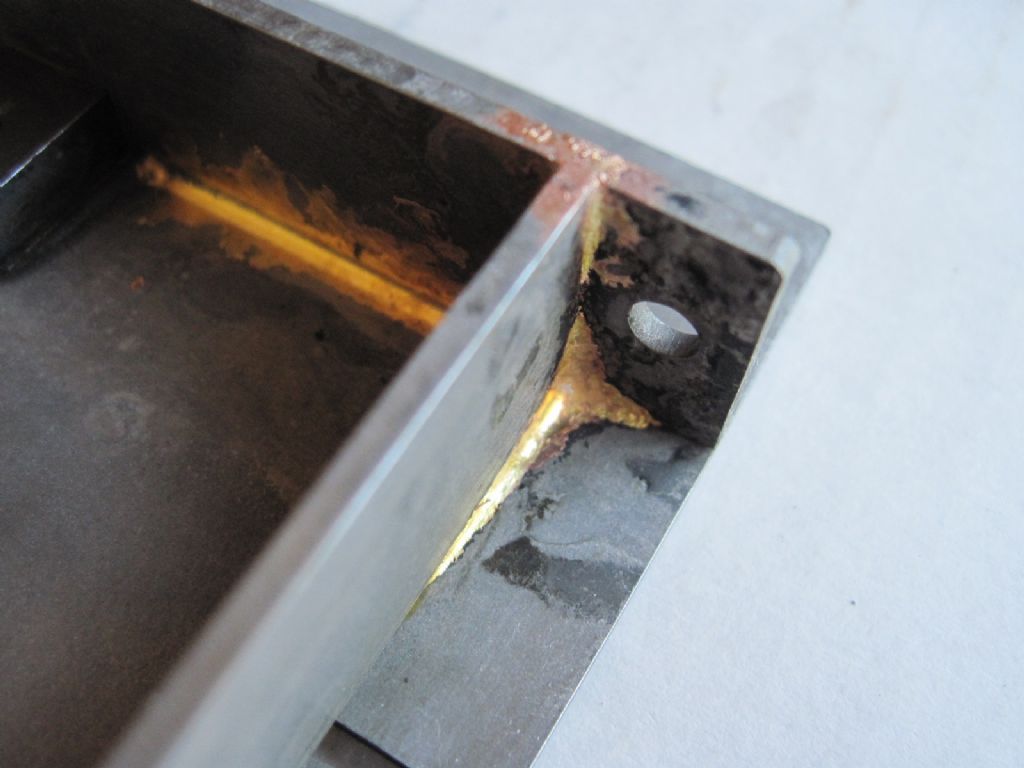

                  I think Clive might be referring to a query I had a good while ago.
                  I'd purchased a Bullfinch Autotorch 404 for small SIFbronze (e.g. brass) brazing work. I already had a large patio gas cylinder, which I had (wrongly) assumed I could also use for the Bullfinch but it turned out that wasn't possible (different connector).
                  So I ended up buying a new Propane (Red) cylinder which wasn't that much more than just the cost of a refill IIRC (and very cheap compared to disposable gas bottles). I was then able to attach the Bullfinch directly using the Bullfinch supplied regulator. It all works very well for small SIF brazing jobs as well as any larger silver brazing I need to do.
                  Regards,
                  IanT
                  PS The 404 generates higher temperatures than most propane guns are capable of and (in my view) is a viable alternative to Oxy-A for smaller brass brazing work – although obviously it's not quite as versatile. But then it isn't as costly or (potentially) as dangerous either…
