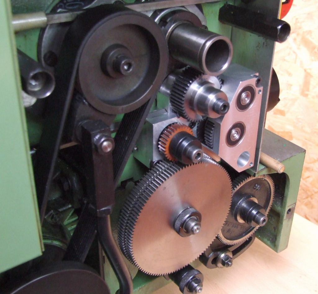

      On Saturday last I was going through my files and deleting those which I deemed as dead, or of no further use.
      As luck would have it Trevor Steele sent me an email on Monday on the above Screwcutting Clutch which he has just completed. Looking at the date on the back-up file in AutoCAD, (which luckily had not got deleted), that date says 2016. I have an uncanny feeling that was when my computer was replaced and the actual design date goes back to before I retired in 2012. It seems the Lockdown has brought this version of the clutch to fruition.
      Thus thanks to Trevor we have another version of this attachment, and hopefully in due course Trevor will write this up for others to enjoy.
      Trevor has sent me some more photographs and in due course I will add more details. I had also better add that I have Trevor's permission to post these photographs on the Forum.
      Regards

              Hi James,
              Trevor has made some alterations to my original design. Having the machine in front of you makes things a whole lot easier. He has also added DU lined bushes, where I had originally fitted Oilite bearings. Apparently Boxford use these instead of Oilite, something I did not know, but it makes for a more compact unit.
              Hi Steve,
              I have to get to grips with downloading some photographs from the Clouds. My forte is mechanical things not Computers as some of you may have guessed, but I will get there eventually.
              Regards

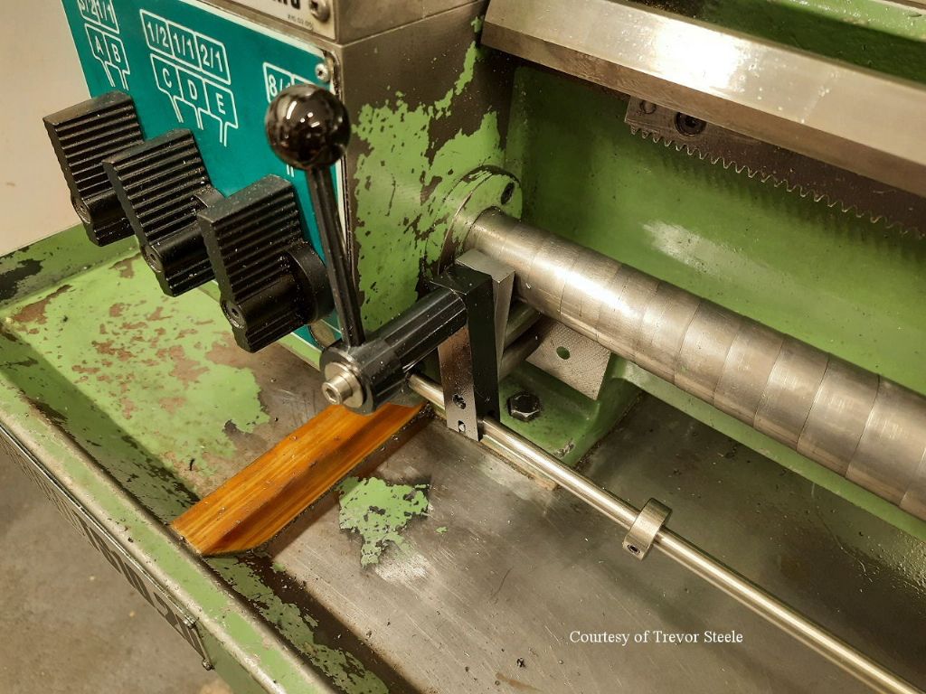

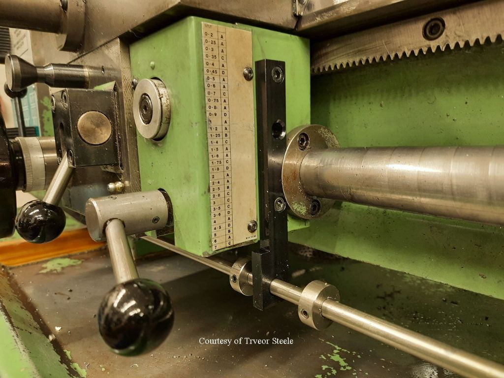

                                      Here are a few more of Trevor's photographs, starting with the Operating Handle which Trevor has arranged more conveniently at the Headstock end.

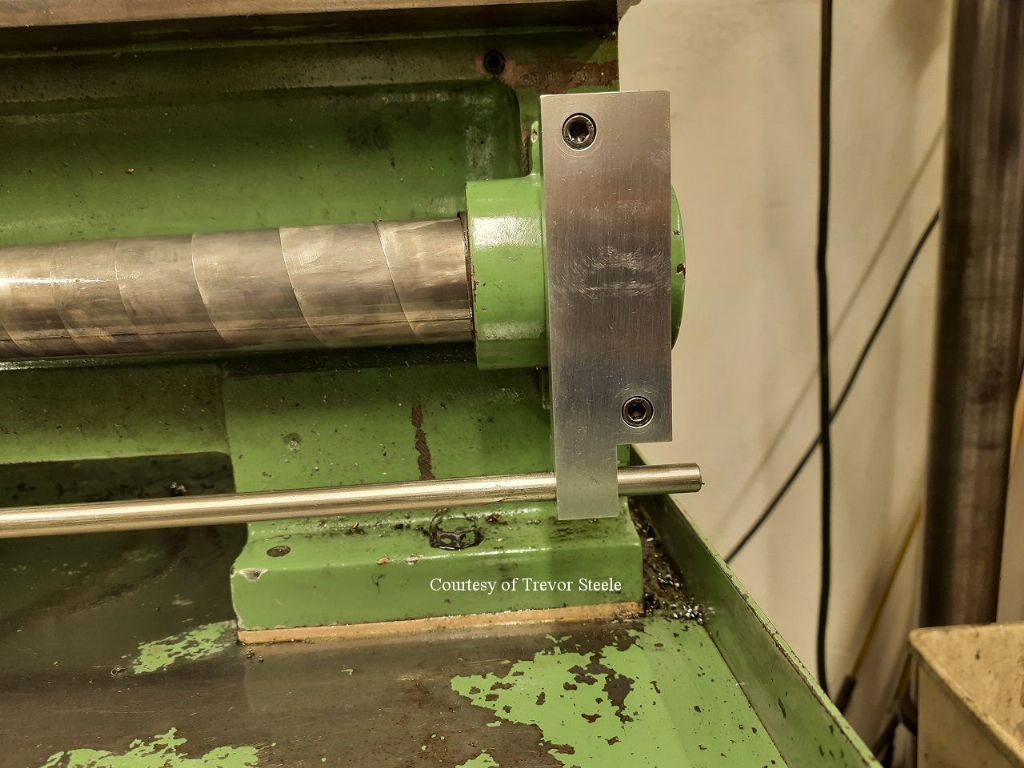

                                      The Stop Rod passes through a bar attached to the carriage, the manufacture involves a bit of sculpting to get it to fit around the Leadscrew guard support bracket.
                                      The outer end of the Stop Rod is supported in a Bearing Block. This was where I had originally designed to place the Operating Handle.
                                      Finally a end on view to show how well the clutch gearbox fits in the space available. Again Trevor had to make changes to my original design in order to miss the Quadrant bracket.
                                      I will add a few shots of the internals later this week hopefully.

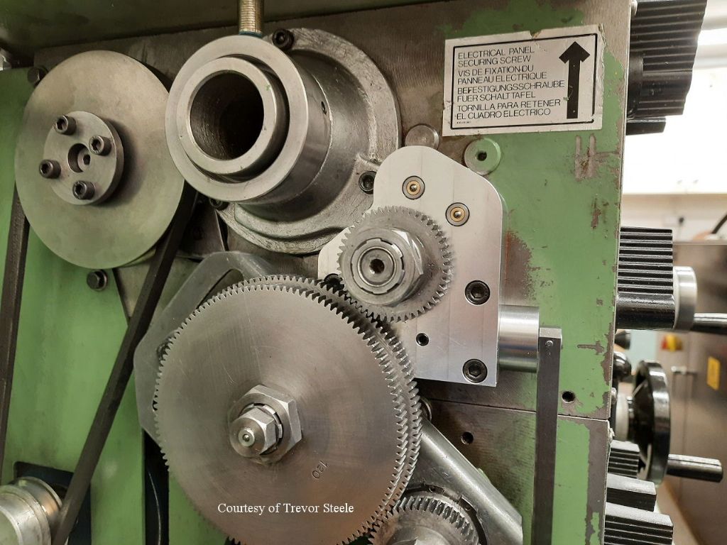

                                            This Boxford clutch was the first to be fitted externally to the Tumbler reverse gears, (these are contained with in the headstock like the Emco Maximat). Unlike the Maximat there is a good deal more room available with the Boxford STS.
                                            I am however thankful that others are rising to the challenge of fitting a clutch to their lathes. The Atlas will be my last version.

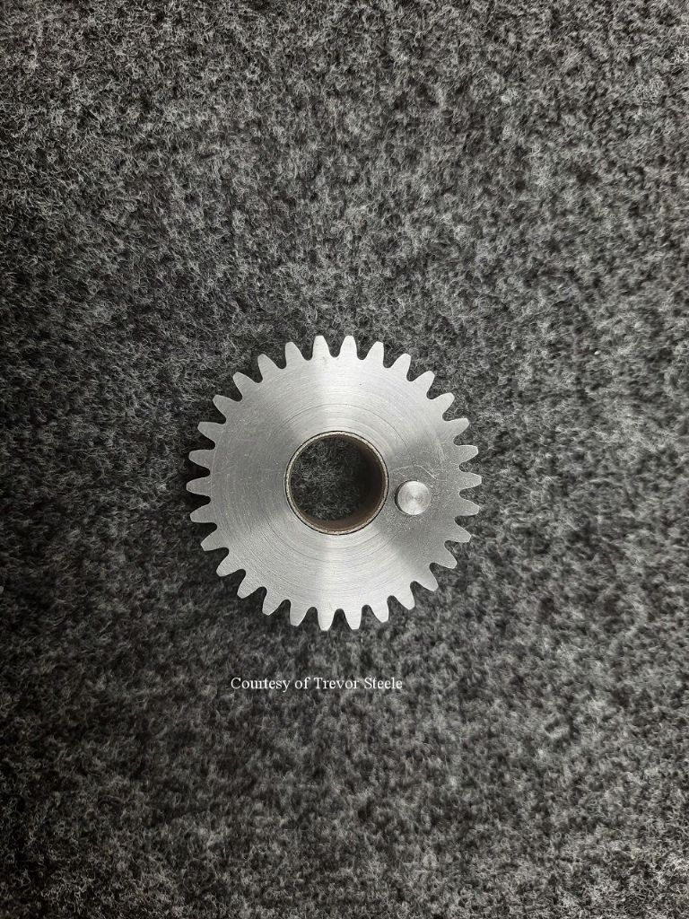

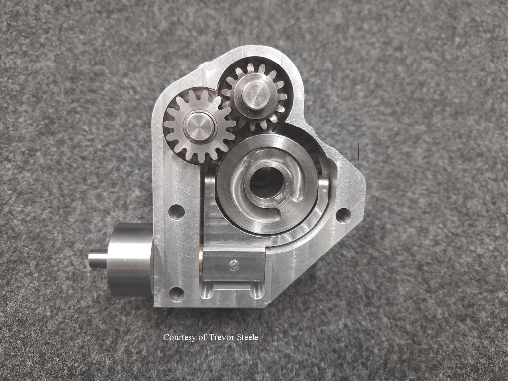

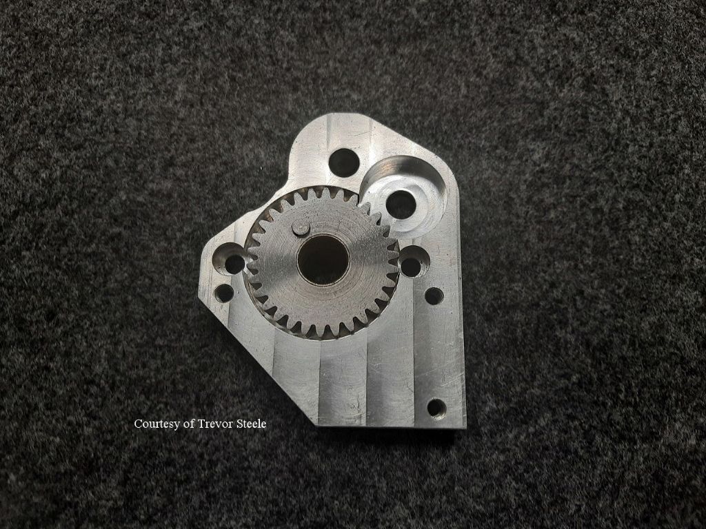

                                                    I have the last few of your photographs I selected to post.
                                                    The first is a view of the internals of the Clutch Housing
                                                    The next shows one of the Dog Gears in-situ
                                                    With a separate view of the Dog Gear, showing the Drive Dog, and Trevor's use of DU lined bushes for the bearing bush.
                                                    This next photograph shows the two Idler gears and their shafts, again using DU lined bushes and note the oil holes in the shafts which connect with Oilers in the end of the shafts.

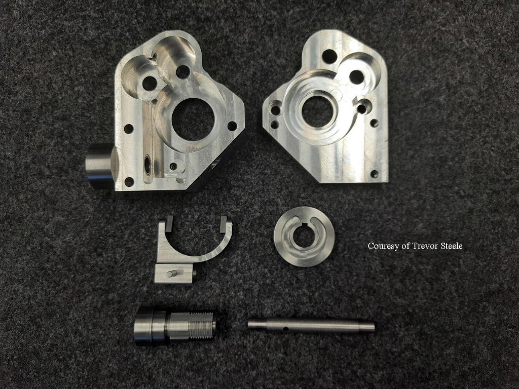

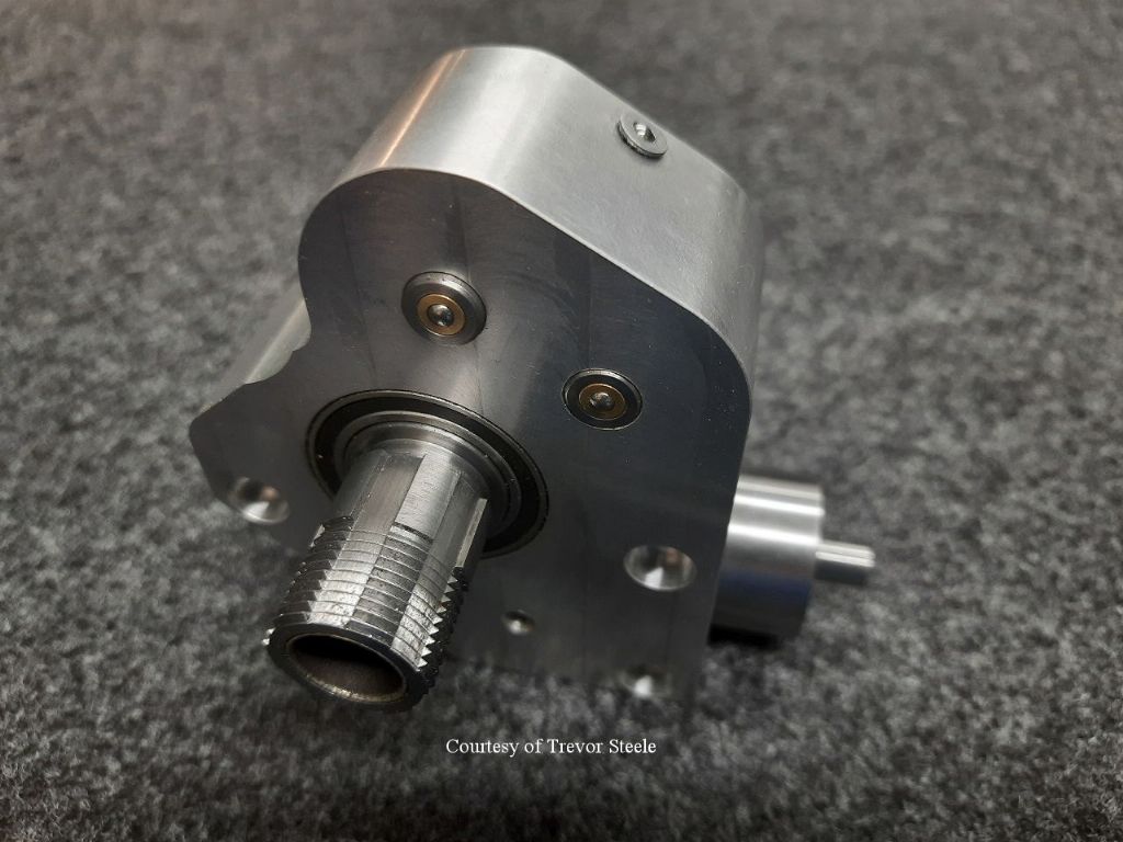

                                                    Lastly we have the Splined Output shaft to match the Boxford Change gears.
                                                    The Oilers for the idler gears can be seen in this photograph. The Oiler on the top of the housing will lubricate the Dog Gears etc. Being in a housing there will after time be an oil bath for these gears in the bottom of the housings.
