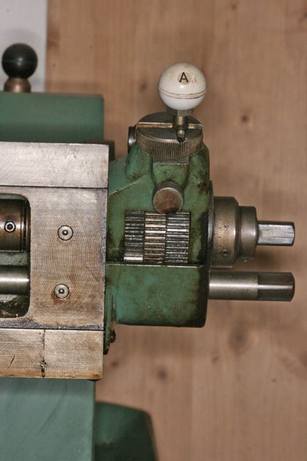

                    Saxalby
                      @saxalby
                      The feed mechanism looks nothing like my Mk2 Boxford.

                      #604635
                      peak4
                        @peak4
                        Posted by Saxalby on 06/07/2022 19:31:30:
                        Barry
                        Thanks Barry, that looks the same as mine, barring the colour; mine is blue as per the photo(s) on Tony's site.

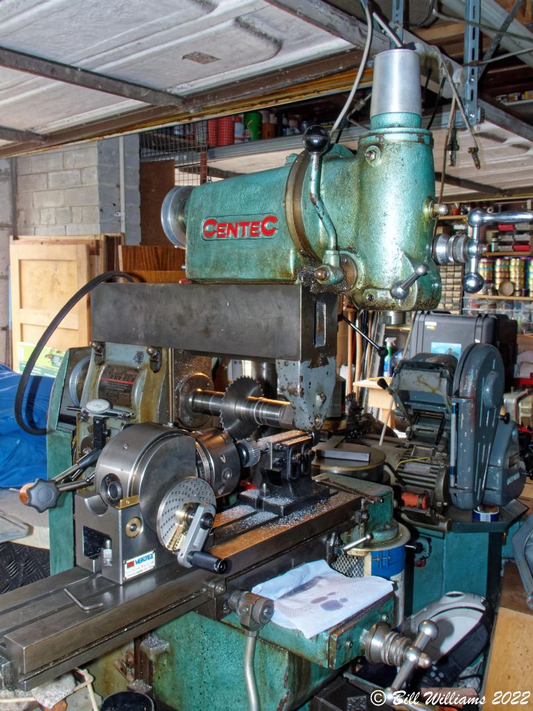

                              #608246
                              peak4
                                @peak4
                                Posted by Saxalby on 07/07/2022 12:47:55:
                                Have just had a look at mine.
                                The two ratchet wheels are identical, size and tooth count.
                                The gear on the left is 26 tooth and 1.4 inches dia., so that makes it 20DP gear.
                                And almost certainly 14.5 PA
                                Reds Barry
                                Edited By Saxalby on 07/07/2022 12:49:18
                                Thanks again for your assistance on that one.

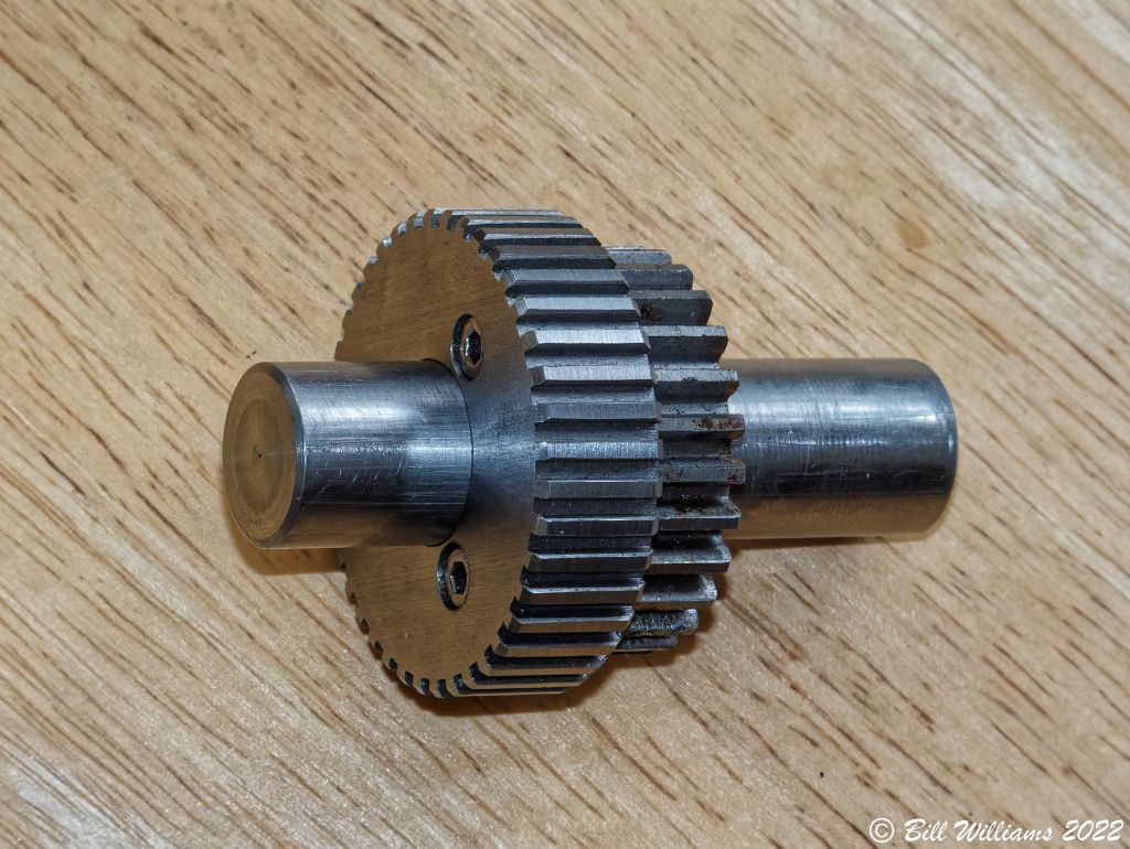

                                I went to order a 26 tooth gear from RDG, and found they had some dirty ones going cheap, so not worth me buying a gear cutter for the one job.
                                It fits and meshes nicely.

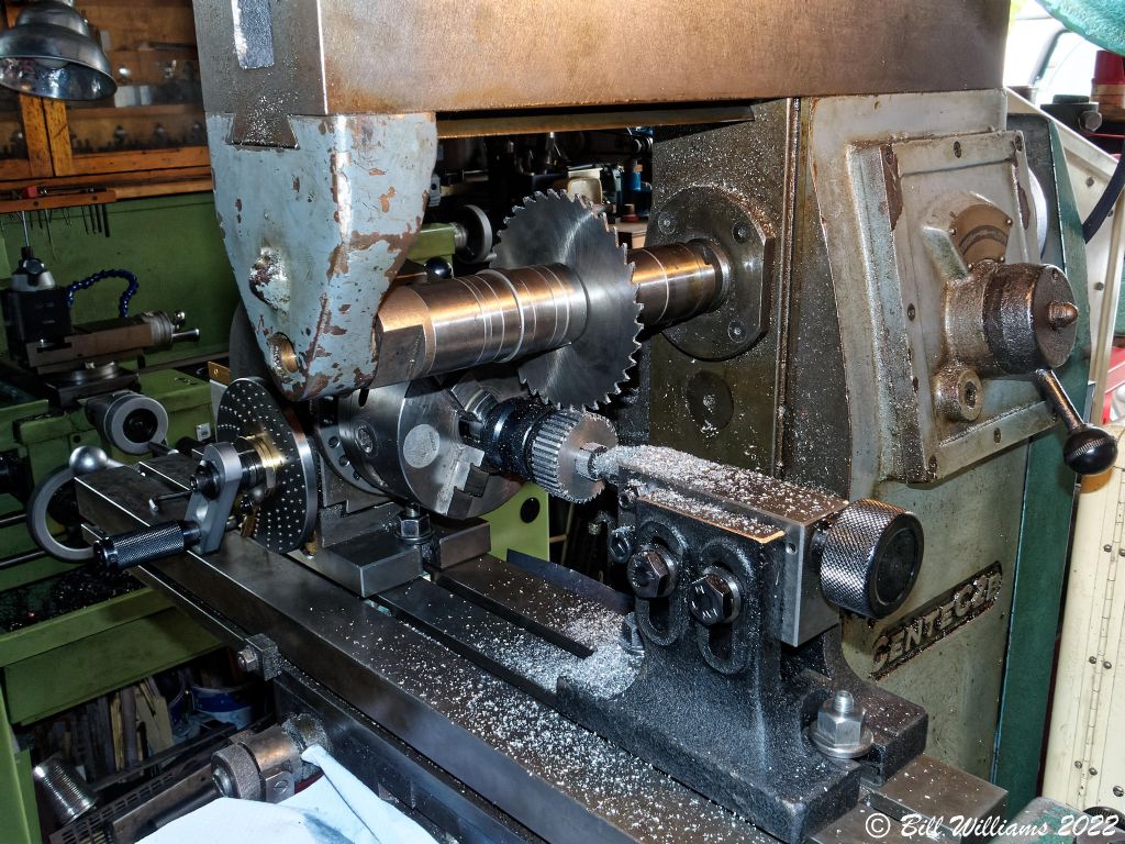

                                Fortunately I had a lump of 50mm EN8 in stock, so made up a duplicate 40 tooth ratchet wheel, and the machine now has vertical feed.
                                Dividing head set up on the Centec, showing the riser block in use for horizontal milling.
                                Seems to work well enough, and convenient at 40 tooth so no holes to count.
                                The completed assembly; the bit of bar was just for lining things up.
                                There's a few more photos in the album.

                                          #608265
                                          Robin
                                            @robin
                                            I'm just doing one, the tricky bit is cutting 40 x 1/16" grooves in the ratchet, you really need a shaper for that.
                                            I broke my only 1/16" end mill and had to do them 2mm.
                                            The gear is the same as the one it meshes with. I gave it a sintered bronze bushing.
                                            It goes up and down like anything. The vertical drive shaft has a steel gear taper pinned on the end. Be sure to remove the bronze gear behind before knocking the pin out. Angst surprise
                                            Have you found a supplier for 3/32" x 1 1/2" taper pins? I got some 1" from EKP but I need bigger.
                                            Robin

                                                  #608401
                                                  Saxalby
                                                    @saxalby
                                                    Just checked – it is just a knurled screw which locates in the two holes in the rotating pawl bit.
                                                    Rgrds Barry
