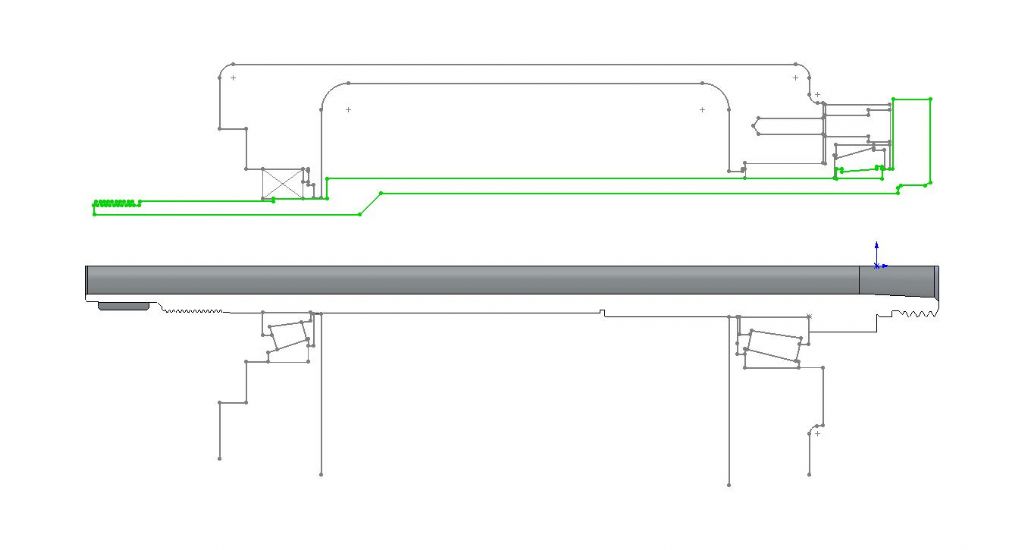

                It has been a lot of head schratching but we are getting closer.
                It is nice if we can avoid  removing headstock from bed and  do all  work at home.
                >**LINK**
                The first modification on headstock is opening the cast iron grease traps up to 50.05mm and 60.05mm from 35.05 and 38.15mm repectively.
                The new aft bearing is a 32910 costing between 3 and 140£ depending on source and delivery time.
                My three $ ones has not arrived yet. 72/50/15 mm.
                New front is 32913 (90/65/17 mm) between 29 and54 £
                We will have to cut (CONCENTRICALLY) a corner that is 90mm diameter from 76.2 mm
                and 10 mm deep.
                Beauty is that if we regret it is no big deal to reinstate the original bearings and spindle.
                New spindle with 65 outside and a long hole of 63.5mm will have same bending stiffnes as stoneage Boxford.

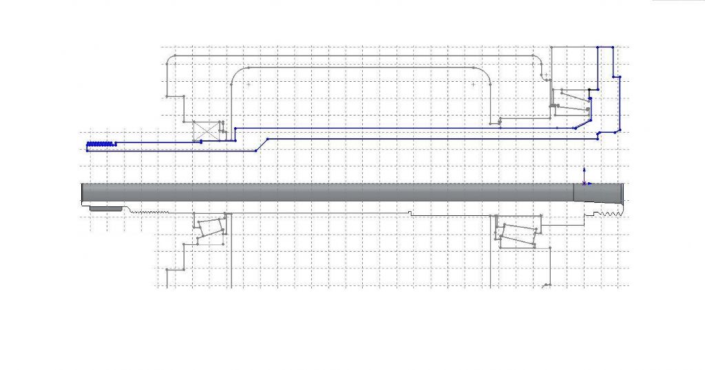

                      An old thread but I have seen the holy light.
                      To make a really usefull Boxford ,we can machine a front bearing holder (bearing 32913) as shown and fit it in front headstock front bearing hole that   is bored 3Inch/76.2mm.
                      These new,slimline bearings have 65mm holes and spindle front part can easily have a 55mm hole.
                      I hessitated to send Brian the used chineese spindle as I thougth he underestimated the trouble of line boring headstock.
                      After having seen the holy ligth and I would not have hessitated but it had served no purpose either.
                      This new illuminated solution is pure lathe work and spindles are easy to make.
                      If the chucklholder face of spindle is made after assembly in the Boxford , no Schaublin,Hardinge etc will better it.
                      Please enjoy or critisize.

                        A picture of standard Boxford
                        Standard Boxford

                          I had sworn that I would not allow a Boxford in my house and was looking for suitable WM250 headstock to make two big spindle experiments.
                          My WM250 machine with MC4 is a very nice machine.
                          By accident a cheap model A 19509 Boxford saw me and followed home.
                          It has been in school since 1966 and has seen very,very little  use.
                          The complete drive system with a 0.5hp three phase Crompton will leave as will all the rotating parts in headstock plus gearbox and (imperial) leadscrew.
                          The spindle scheme to be tried first is this.The lines are 10mm apart.Bearings 32910 and 32916

                            Well I was going to excommunicate you for this sacrilege but your proposition is sufficient for a pardon, at least temporary.
                            Looks like you are aiming for 38mm through bore which is quite impressive.
