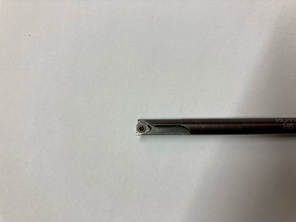

      img_0202.jpgimg_0204.jpghi all does anybody recognise this small boring bar its made by HOYBIDE and is 6mm in diameter I'm trying to find inserts for it but haven't had any luck they are tiny img_0204.jpg

              I have looked for Hoybide without much success. The only likely looking candidates for your inserts all have proprietry codes which is no help at all if the original Hoybide information is missing. The shape is a combination of T and W type inserts which means that no common inserts will fit.
              Unless somebody on the forum already has that H6 FR boring bar and knows the insert code, I fear you will be unlucky.

                Have the used cutting corners just been ground off or is that the true shape ?

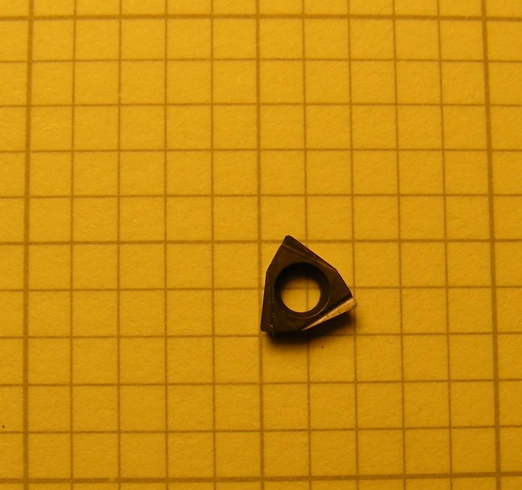

                ega
                  @ega
                  Here's a photo of an unused tip for the Sumitomo bar I referenced above:
                  The squares are 1/10" in size.

                        Would a triangle insert fit in that pocket.

                              DC31k:
                              Thanks for the very helpful link. It looks as though my inserts are WB 0601.

                                after reading all the posts and following your links I'm thinking the insert is WBMT thanks to all
