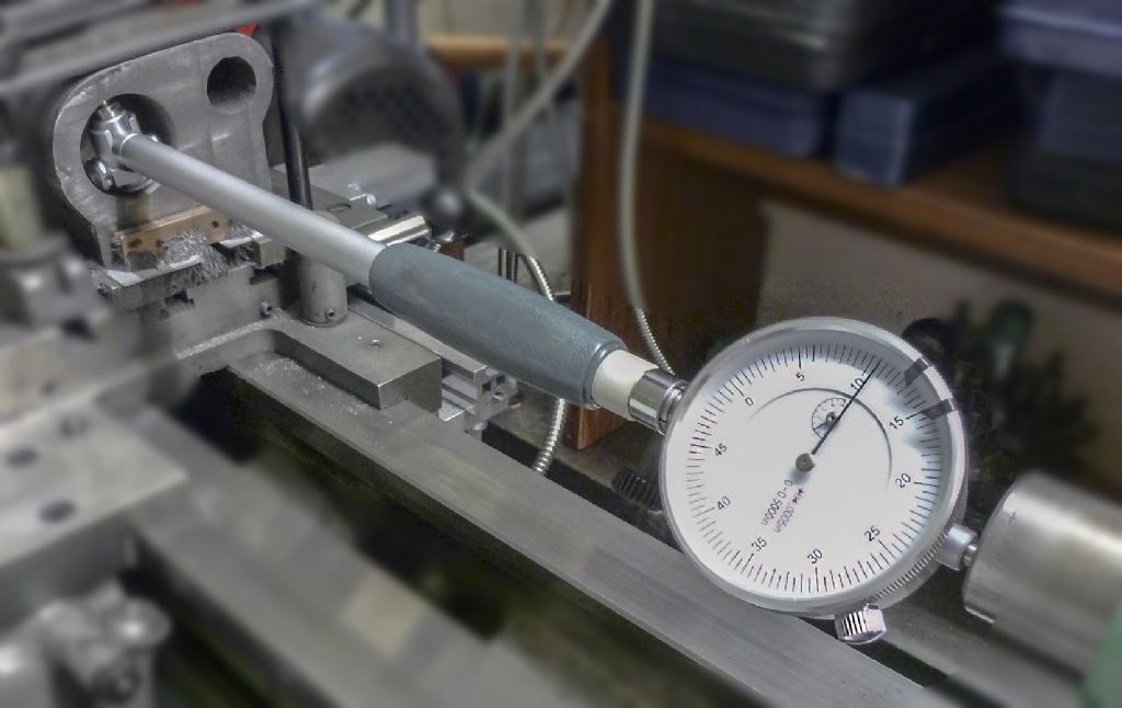

                                Fowlers Fury
                                  @fowlersfury
                                  Valuable comments above ! Kiwi Bloke ! makes observations I can endorse from experience.
                                  I've been through similar exercises recently when trying to determine as accurately as possible the bore of cylinders about 1.5" diameter.
                                  Conclusions for what they are worth:-
                                  • Prime requirement seemed to be a reference standard of known ID. Far too expensive to buy at that ID. I bore out a steel tube segment but then what? I still need its precise ID somehow.
                                  • A digital micrometer (Mitutoyo) was useless since the flat edges of the "inside" jaws obviously do not register the actual, true diameter. Allowance may be possible IF a reference standard was available.
                                  • Spring-bow internal calipers and telescopic bore guages – as others report, very much subject to variation of "feel" and require a secondary measurement adding to the error potential.
                                  • A dial bore guage – zeroed (calibrated) against a 1.5 inch micrometer held in clamp – difficult to achieve but possible and was repeatable. Then insert dial bore guage into cylinder….instructions say "take maximum reading as it's moved around". OK, done that and have to assume value obtained is correct.
                                  I suppose, given my ignorance in such matters, that the least subjective method might be to turn down a diameter of steel on the lathe until it "just" fits and then measure its OD with a micrometer (allowing for temp equilibration). But that's fraught with problems of surface fnish etc and gives no indication of bore ovality.
                                  So Adam, apart from investing in a dial bore gauge……..

                                      #408613
                                      Fowlers Fury
                                        @fowlersfury
                                        'had written before" take maximum reading as it's moved around".
                                        Apologies, just realised that should have read take minimum reading…….
                                        This was it in use:-

                                            Fowlers Fury
                                              @fowlersfury
                                              Adam, I don't disagree in principle about holding two of the axes steady but I didn't do so for 2 reasons.
                                              • Wanting to 'wiggle & turn' the DBG around in the cylinder bore to ensure a minimum reading was showing.
                                              • There was no provision on the DBG to support it by a dead centre in the tailstock and I wasn't confident – at the accuracy needed – that a light grip in my 2MT Jacobs chuck was precise enough.
                                              For reasons to do with the special piston rings that were to be used, the bore had to be 1.500 + or – 0.001" throughout the length. I was using a between centres boring bar and that had to keep being removed & replaced for the DBG as the required ID got closer – a PITA.
                                              There are numerous YouTube vids on using DBGs. As usual, some very useful others not so.

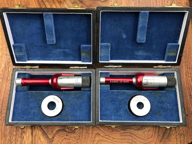

                                                Oily Rag
                                                  @oilyrag
                                                  Bowers 13-16 and 16-19 bore micrometers with their setting gauges. An excellent buy at an auction for £40 for the pair. I have also got some larger Mitutoya bore micrometers in imperial sizes from 3/4" through to 2.5" with some gaps in the range. Once set they are pretty reliable, but I do check them every time I use them. DBG's are good for checking bore taper and run-out but cannot meet the exactness of using a bore micrometer – these Bowers are graduated in 0.005mm but are readable to 0.002mm (glasses dependent!), especially where small bores are concerned and accuracy is required. I use these for little end measuring of con rods and pistons. The bigger imperial mikes I use for main bearing fits. I did have some Chinese small bore micrometers but given they were reasonably accurate they were poorly made to such an extent that the jaw on one mike dropped out! Their setting gauges were inaccurate when checked with the Bowers.
