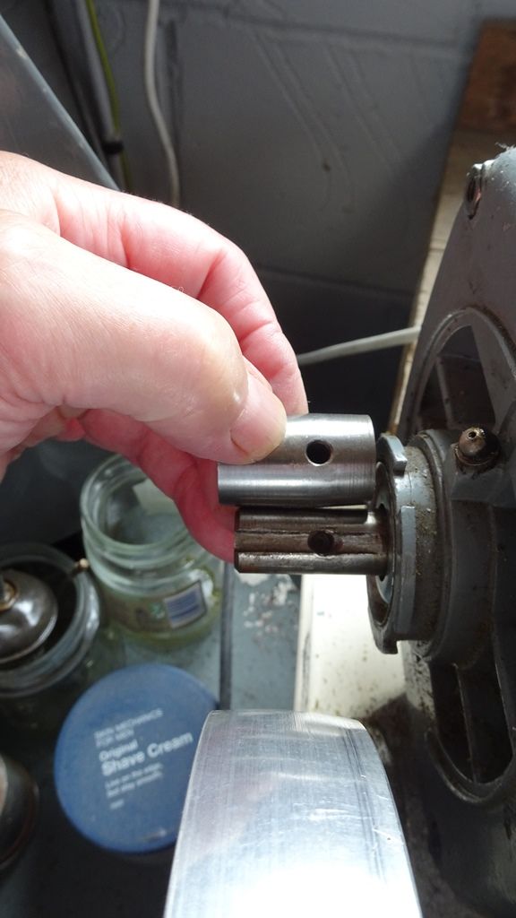

      I have a Kennedy 60 powered by the original; Hoover 1/6 HP motor. It used to work fine (I think!) until the belt began to slip. I purchased a new belt but no matter what I do the belt slips to the outside.
      I say I think because I'd never taken the guard off before getting the fitting the new belt.

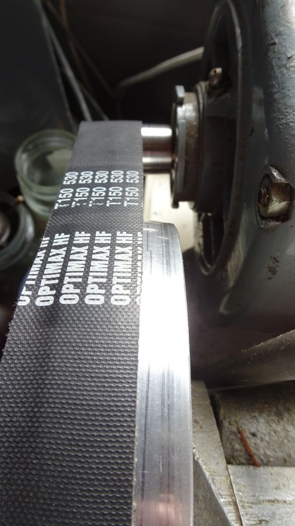

      I have tried all permutations of pulley positioning on the spindles to no avail. According to the manual, the pulleys outer edges should be in line. I can get close but the belt still rides off to the same extent.
      I have not loosened either the motor, a no-no according to the manual, or the saw body itself although I suppose the new belt may have pulled the shafts out of parallel.
      Calling Kennedy owners, is your motor pulley like mine?
      Any ideas as I'm getting cross now!

          Look about 2:48 into this video. I would suggest your motor and pulley are not parallel. Possibly one of them has become misaligned.

            Odds are its been running misaligned for years 'cos last person to change belt loosened the motor instead of just working the belt on. If so the large pulley crown may have worn asymmetric and need correcting before the belt will run true.
            These little flat belts seem either to just go straight on and behave or turn into a total nightmare. Had the nightmare with my Clarkson. Pulleys measured OK but it flat out refused to behave. Ended up making two new ones which worked just like that after a simple ruler alignment of the pulley faces.

              Thanks, Murray. That is sort of the conclusion I came to, too.
              Thanks, Clive. I hope mine is not that much of a 'mare! I must say that the motor pulley is a strange shape but is in steel whilst the driven is aluminium. I don't think the motor would have been worn by the belt.
              It will be difficult to work out which if any bit has moved. The motor to base or the saw unit to base. Or maybe both!
              I would still appreciate any input from fellow Kennedy owners…..

                    The motor pulley is noticeably "barrel-shaped" intentionally, so as to cause the belt to ride to the middle of the pulley. It's called "crowning" and the big pulley is similar but not so noticeable. Bandsaw wheels are the same.
                    Would suggest that your 2 pulley shafts are not parallel. Don't forget that the belt needs to be really tight (known as "bar-tight" in my day). I use a short length of wood batten as a lever between motor and saw base to tension mine.

                        Remove the motor pulley and turn the shaft so the keyway is not pointing towards the big pulley. Place a straight edge across the edges of the big pulley so that it extends up to the motor shaft. Put a small square on the straight edge and check if the motor shaft is truly perpendicular to the straight edge, which will make it parallel to the big pulley axis. If it isn't, loosen the motor and adjust it until it is. If the pulleys are now aligned and parallel, the belt will run true.
                        Once you have the motor pulley parallel to the big pulley use a marker pen to draw marks on the base along the motor feet. Then if you have to adjust the motor to tension the belt you have a visual reference to keep the shafts aligned, you just eyeball the gap from the line to the motor foot.

                              There is an easier way to align or check the pulley
                              simply re fit the belt and trap a piece of string under one end – it does not matter which end, now rotate so that the string is pulled across the face of both pulley's
                              move off and bring it back onto both adjust until it touches all 4 contact points
                              for example if it touches both sides of the motor's pulley and not the large pulley then move the motor
                              keep adjusting until the string just touches both
                              if you want to check the correct tension then simply down load Gates Carbon Drive – its an app that measures the frequency of the belt when "plucked"
                              you enter the belt details and it has a proffered frequency attached to that belt size and distance between centre's

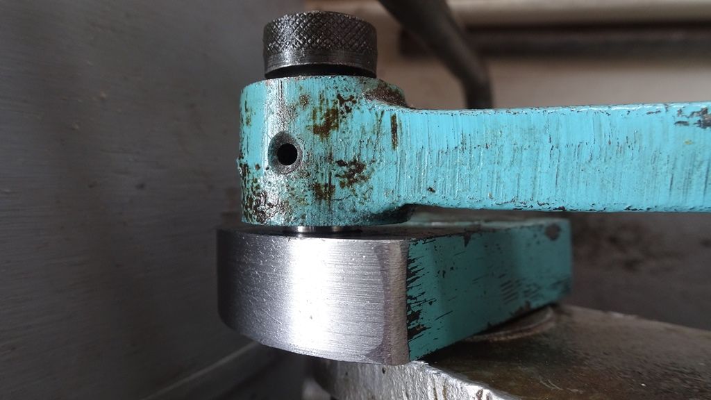

                                            Managed some workshop time and got the pulleys running parallel and the belt is now centralized and runs fine.
                                            I had to machine the end of the crank though as it was just tapping the motor casing.
                                            It might have been better if I had bought a 540 belt. The 530 is very tight!
