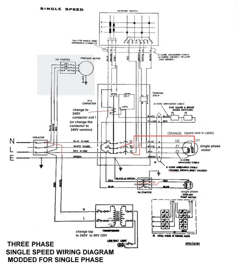

      john swift 1
        @johnswift1
        Hi Paul
        since I don't have the original Colchester wiring diagrams
        I have modified your diagram to show how I think the relay should be wired

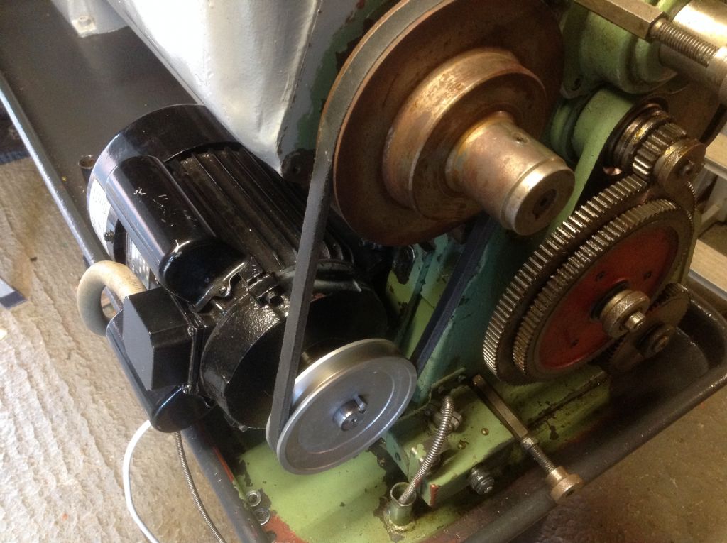

                        Paul Matthews 4
                          @paulmatthews4
                          Hi Phil, if you look up about 8 posts, I've posted a small video clip of how the forward / reverse / stop lever operates on the lathe – I haven't dismantled this switch yet but looks like I'll have to at some time so I'll try and get in there today. I've posted the manual diagrams below – plus my updated "as is" wiring diagram. I assume my lathe was the two speed version as it has the two speed switch blanked off on the control box plus the red / blue speed options on the headstock plate.
                          Now don't laugh, but I was taking some chuck speed measurements last night and set the lathe to run in forward at the 800rpm – that is the speed continually cutting in and out as described above, and the motor ran no problem! I can only assume, as was identified above, that the motor being unable to run in forward but OK in reverse was very marginal, and with the very hot weather, the gearbox oil has become less viscous and therefore not offering so much resistance to the motor. I'm still planning to change the motor so don't worry all the advice has not been in vain! laugh

                                    #248933
                                    Paul Matthews 4
                                      @paulmatthews4
                                      Hi all, just to bring this thread to a close, I'm pleased to report that the new motor is now fitted, switching rewired and all seems to be working perfectly. Thanks once again for everybody's help.
