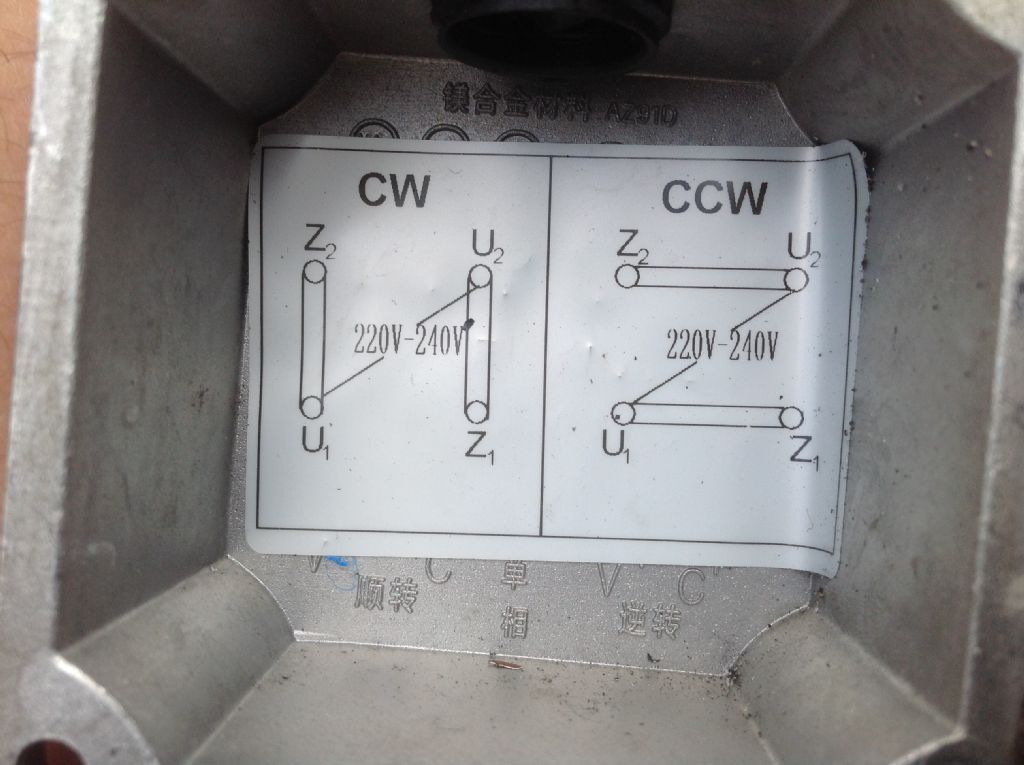

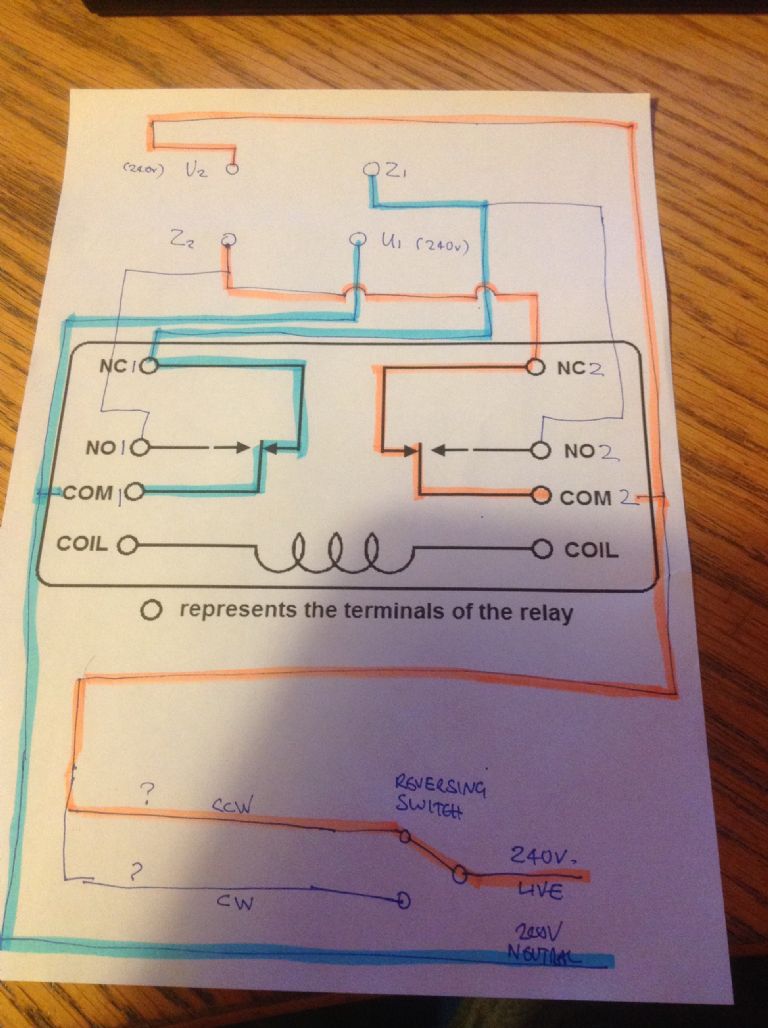

                      Hi there everybody I've been given a much more modern A/C motor that I wanted to try out and see if I could solve the problem of the stall at top speed as above. Unfortunately, not knowing much about electronics I'm a bit stumped now, so I'd like to ask if anyone can advise:
                      My existing arrangement has a single phase motor fed by three wires, which (I think this is right) are two lives and a common neutral. One live operates the motor in clockwise and the other counterclockwise, these bring switched by the forward / reverse control on the lathe. The new motor has a different arrangement as per the wiring diagram below
                      This indicates the wiring required to operate the motor in clockwise and counterclockwise directions by the use of physical links – obviously I need to operate this via a switch control so I can operate the motor in both directions without the physical links. I spoke to a technician at the motor manufacturer and he confirmed the motor was used on one of their lathes so is suitable for my needs and in order to operate the motor via the forward / reverse control on the lathe, I'd need to add two contractors to the existing three wire supply. Well I'm a bit stumped now as to how to do this, I'd be grateful if anyone could offer any advice.

                        To reverse this motor use a double pole double throw contactor. Each pole will have common, normally closed and normally open terminals. COM1, NO1, NC1, COM2, NO2, NC2. Connect U1 to COM1, U2 to COM2, Z1 to both NC1 and NO2, Z2 to both NO1 and NC2. In this setup with the contactor de-energised you will get CCW and energised you will get CW. A second run contactor is used to apply power to the reversing contactor common terminals.

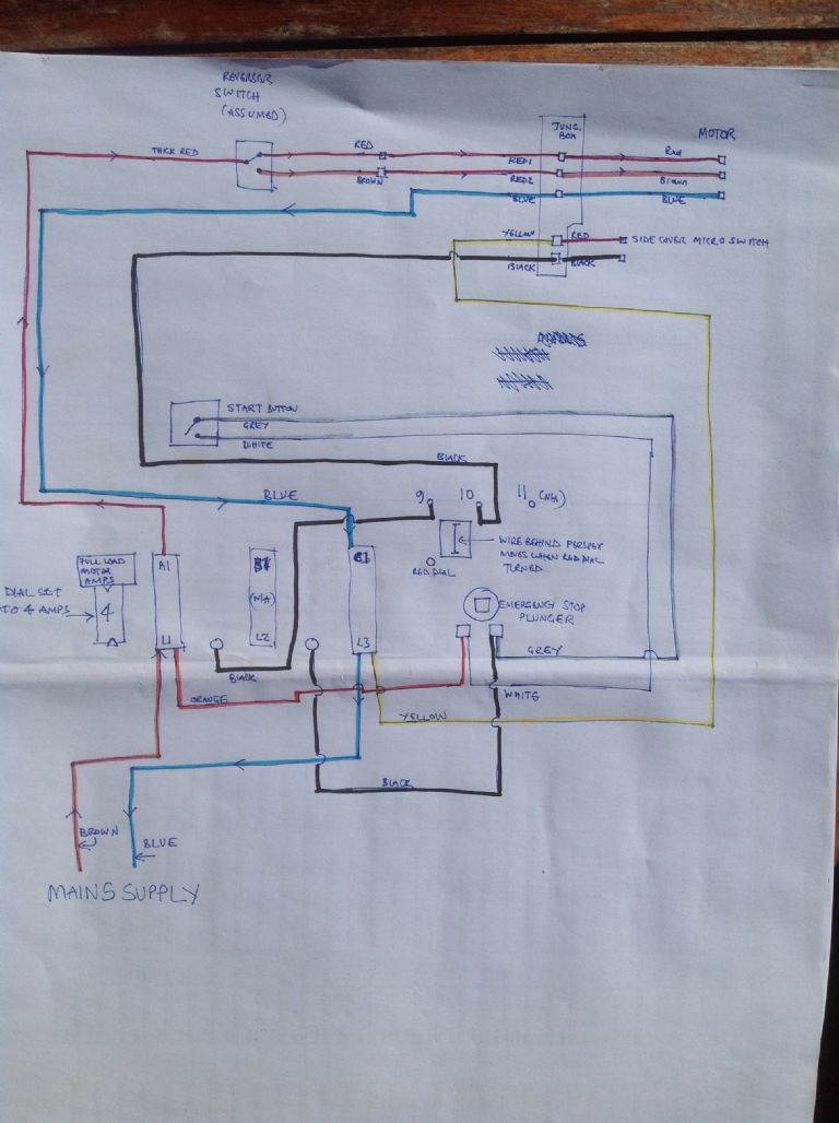

                                Hi everyone thanks once again for the comments – plenty of food for thought – unfortunately the motor plate is right under the motor so very difficult to see but I'll try now I've moved the lathe out from the wall – be in touch…

                                  Yes this was a 3 phase motor originally but converted to single phase motor which is 2850rpm, 2hp – can just about read it on the plate which is underneath

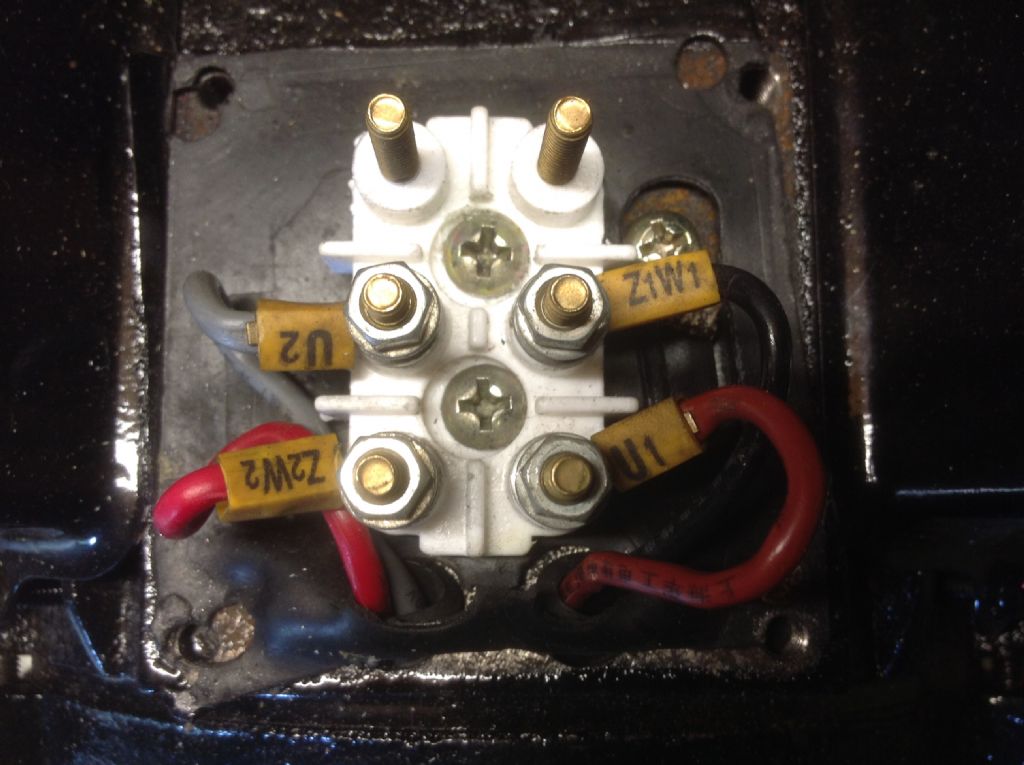

                                      Hi Paul,
                                      Well, I was totally confident that the nameplate would show the motor was half horse power or thereabouts, and we could put this to bed. Shows how much I know! 2 HP should be plenty.
                                      However, there are a couple of questions that arise out of the information you have posted, as I fancy the original motor would have run at 1450 rpm, and this motor runs at twice that speed. Do you have a means of measuring the ACTUAL speed at the chuck, not just what the gear lever nameplate says? I just wonder if the whole thing is running at twice the speed indicated, unless whoever did the conversion did the right thing and altered the pulley sizes appropriately. If we're actually running at 1600 rpm then 2HP on a single phase motor might well be marginal. I can't gauge the speed from the video.
                                      My second question is just to confirm the full load current as indicated on the motor name plate, just to check that it correlates with that of a 2HP 230 volt single phase motor. If you can get a piccy of the nameplate so much the better.
                                      Failing that my next best theory is that there is something odd with the motor run winding, though I can't fit that with the proper operation at lower speed at the moment.

                                          Yes I can check the chuck speed with a meter – I'll also try and get a photo of the plate tomorrow, i'll double check the HP – not easy to see, 1/2 could look like 2! Regards Paul
                                          Hi Nick
                                          I think this is right, this lathe originally had a 2-speed control (as per the blue/red plate you can just see in the vid) – I think that was only available for a 3-phase supply but could be wrong. The two-speed switch has now been removed so only the speeds on the red part of the plate now apply. Regards Paul

                                            The original motor would have been two speed 3 phase working 2 pole and or 4 pole to give the different speeds e.g. 2600/1400 rpm. and something around 1.5hp on full speed (1600 rpm spindle speed).

                                                  Photo of motor plate as best I can take. Checked chuck speeds and a bit faster than prescribed:
                                                  334rpm actually running at about 360rpm

                                                    The forward/reversing switch should energize the coil and should not go to com2, com2 should be wired directly from A1. You do not seem to have a 24V control system so you need a contactor that has a coil designed for mains voltage. One side of the coil is connected directly to the C1 terminal and the other side to A1 through the forward/reverse switch. You should only have the two wires going to the reversing switch. Put the wire from A1 to the common terminal of the forward/reverse switch. If you find forward and reverse are the wrong way round then swap the wire going to the coil to the other terminal of the forward/reverse switch.
