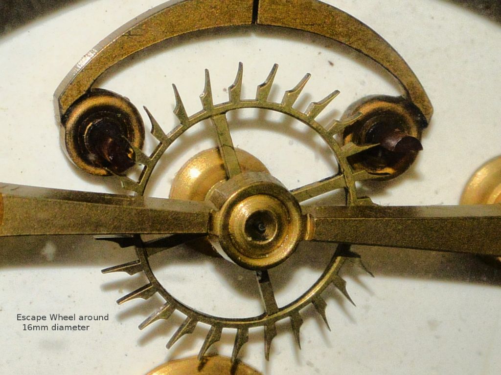

                    Here is a shot of an escapement actually made by Brocot. frown The clock is virtually held together with clock pins but still no sign of a reamer.
                    Looks like very slight flats on the end of the teeth to me. From the split in the escapement it also looks like the pallet spacing can be adjusted. Probably in part to account for wear over the years..

                                    I am currently drawing up plans for a Brocot escapement for this clock, rather than my original design. I have read that the diameter of the pallets should the same as the gap between the tips of the escape wheel teeth, less the drop. What would be the consequences of using smaller sized pallets than this? The main thing that I can see is that it may run out of "operating" surface if the pendulum were to swing too far, so the cut-out part of the pallet tries to engage, rather than the curved face.
                                    Can anyone please advise?
                                    Thank you.
                                    James.

                                      It looks like the data base is off line John. Perhaps best to try again in a few days. Odd it's one I have made a lot of use of at times and I hope that mentioning it on the web hasn't caused them to restrict usage. When it's back on line you could try searching Astronomical Clock. The paper was written by F M Fedchenko. It is mostly of academic interest though.
                                      You would be increasing the recoil James if you mess about with the other face so best stick to the design. The other curved face just provides clearance for the pallets and could be replaced by the other form that has a straight angled line instead. The curved form provides stronger teeth. It's possible to cut that with a curved form tool first and then a suitable slitting saw. I'm stuck for a suitable linux cad package that will draw one easily so will have to do it on paper.
                                      So far I have found that a 60T one will be about 95mm dia and a 120T one about 190mm dia. Irksome as I would prefer 120T.

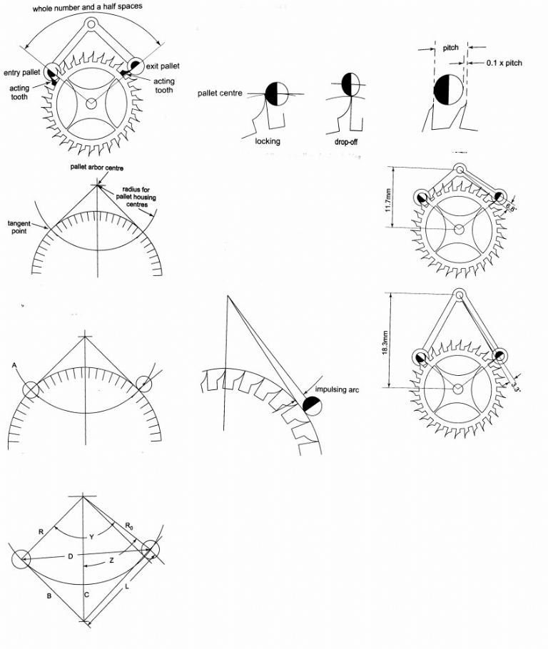

                                              I'll see if I can find some images that give the main aspects of the design James. The size of the pallet given that the active face is set at the correct angle shouldn't make any difference to recoil. Altering the angle will.

                                                  As things tend to interrelate there doesn't seem to be much "do this" and all will be ok design information on Brocot escapements. It seems that there may be a list of ideal designs about some where but I can't find it. Best I could pull together is this.
                                                  What it really doesn't cover is the rake on the active face – the flat side of the tooth as other factors such as the number of teeth spanned and the length of the escapement arms alter it.
                                                  The best way to view that seems to be looking at what happens at the start of lock when the pendulum carries on swinging, Left hand pallet in the view on the top left. The rake at that point needs to be tangential to the curve of the pallet swing. As it's a curved path it can't be precisely replaced with a straight line so there is a need to play with escapement arm length and the number of teeth spanned to flatten the curve as much as possible.
                                                  It can work as the video clearly shows. The drop, 0.1 pitch clearance can be altered by rotating the pallets slightly and as De Carle points out the impulse angle can be reduced by moving the pallet up a touch but not by so much that it can run unlocked.
                                                  laughWell this is how I see if, If anyone knows better or can think of other aspects now would be the time to mention it.
                                                  When I ran through the design verbally I suspect I had the tooth pitch incorrect. The graphic design starts with twice the number of teeth sectors. One thought that struck me was what would happen if the flat raked side of the tooth was given a suitable rad but as most things will have been thought about long ago I suspect there is a catch.

                                                    Thank you for this information which I shall need to study carefully, I am working on my design of the escapement slowly and shall update this thread once I have something completed.
