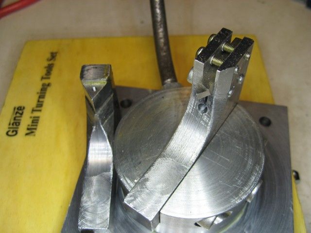

                  Hi Peter & Guys
                  In this picture you can see the HSS tool > I dont know if it helps
                  Nobby
                  radius dresser

                  John Stevenson 1
                    @johnstevenson1
                    Plus 1 for using a boring head.
                    Reasons are it's 3 tools in one and none are specialised and can be moved from machine to machine, even mill to lathe.
                    1 It's a boring head.
                    2 It's a ball turners as in previous photo's
                    3 It's a taper turning attachment that can do taperes longer than a taper turning attachment or even steeper.
                    John S.
                    #106973
                    Nobby
                      @nobby
                      Hi John and Guys
                      Brilliant picture . What sort of centre do you use when turning these steep angles ?
                      Nobby

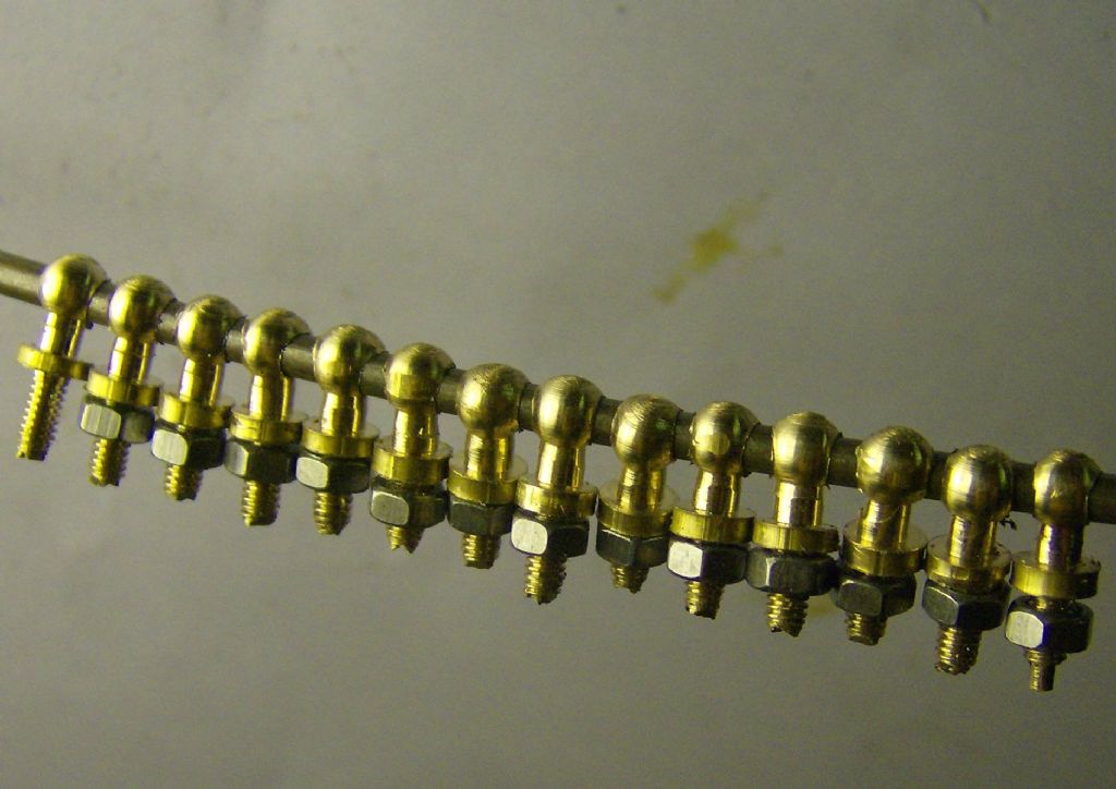

                          Sub Mandrel
                            @submandrel
                            Hello Peter
                            I made smaller stanchions for my 3 1/2" gauge loco. In the end I drilled a hole in a steel block, then cross drilled it. I used this as a jig to cross drill short brass rod blanks at each end.
                            I then used a semi-circular form tool to make the balls – it was much easier to line the form tool up with the hole than drill a small ball accurately!
                            I threaded the ends by putting a shirt piece of rod through each one in turn and 'screwing' them into an 8BA die by hand.
                            Stanchions!

                                  @johnstevenson1
                                  Nobby, you take a piece of 1/2" mild steel in my case and drill a centre hole with a centre drill, that goes in the boring head.
                                  You then do the same but leave that bit in the chuck. This way you know it's got to be running true.
                                  Then you locate the work using two ball bearings held with a dab or grease and drive with a lathe dog.
                                  Doesn't matter how much off set the ball bearing will cope.
                                  You can then dial in the taper you wnat by adjusting the boring head.
                                  And before some Herbert starts rabbiting on about the head being on a horizonal centre there are simple ways to set this and if you are worried about the play in the key on the tailstock barrel,
                                  FIX THE DAMN THING

                                    Nobby
                                      @nobby
                                      Hi John & Guys
                                      Thanks  for reply . Brilliant . 1/2 is the size of the one I made . I have used mine 1, 2, &3 also as a
                                      a flycutter . ( Slapped wrist for that one ) my centre hole i made to run true so at a push you can use say a 1/4" shaped D bit and widen the form you are cutting .
                                      Merry Christmas & a Happy New year
                                      Nobby
