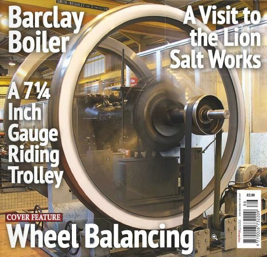

        #363088
          A look at the recent ME 4586 may help, I think there was a thread about the article at the time.
          Edited By JasonB on 20/07/2018 13:12:35

                #363122
                  Not unlike the photo on the front of ME I mentioned earlier
