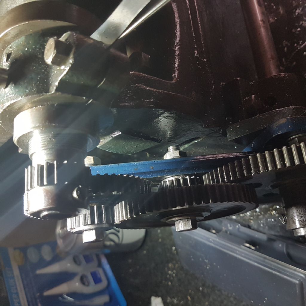

            Just looked at your photos, if you haven’t already that 18tooth gear needs to be changed for the 20tooth gear near the bottom, otherwise your tumble reverse will be sending you potty trying to cut threads.

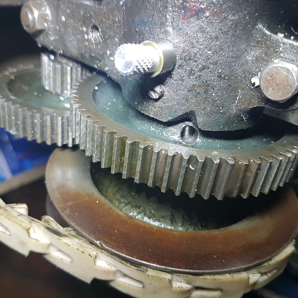

              Thanks Jon but i meant the gears in frount of the pulleys. The ones that make any gear setip go really slow. The lever is really stiff when in disengaged mode but ultra loose when engaged and the gears just get thrown appart.

                It may be locked tight with grease or rust from a former owner. Remove the two screws by the handle which lock the retaining plates. Remember which went which side. Remove the handle.and the quill and inspect the lever see if it moves, it may need some leverage to free it but be careful as you don’t want to damage the bore or the camlock.
                The gears you refer to are the back gears. When someone says to put it in back gear now you know. The back gears don’t simply engage. You need to do a few steps.
                1. Unscrew the Allen grub screw in the pulley assembly
                2. Screw the Allen key grub screw into the back gear, so it locates onto the flat of the spindle. (A light shining down the hole will spot this)
                3. Undo the retaining nut that holds the cam shaft.
                4. Engage back gears.
                5. Tighten nut up to lock into position
                Hopefully this helps with your situation.

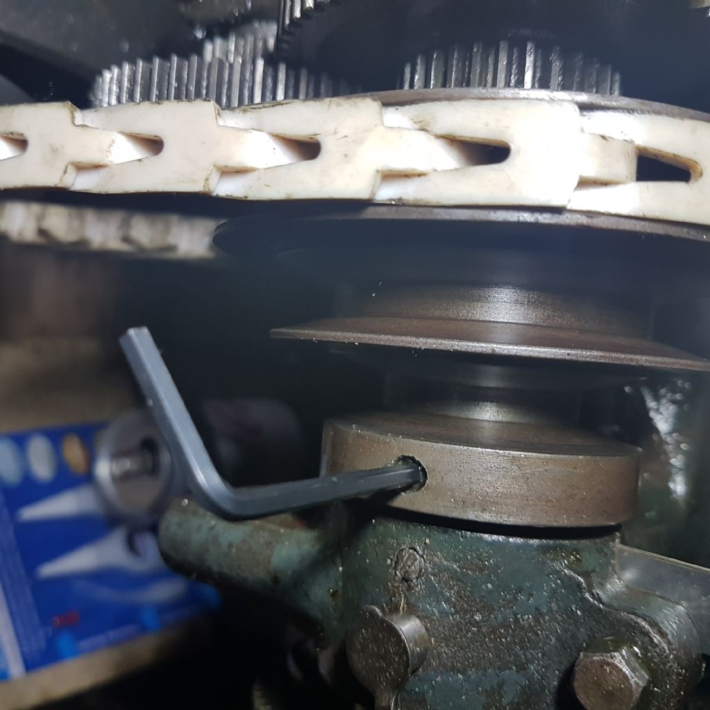

                    On your back gears!!! A 1/8" Allen grub screw and a 3/16 Whitworth spanner is all you need.
                    Undo the Allen bolt in the pulley.
                    Tighten the Allen bolt into this hole on the bull gear

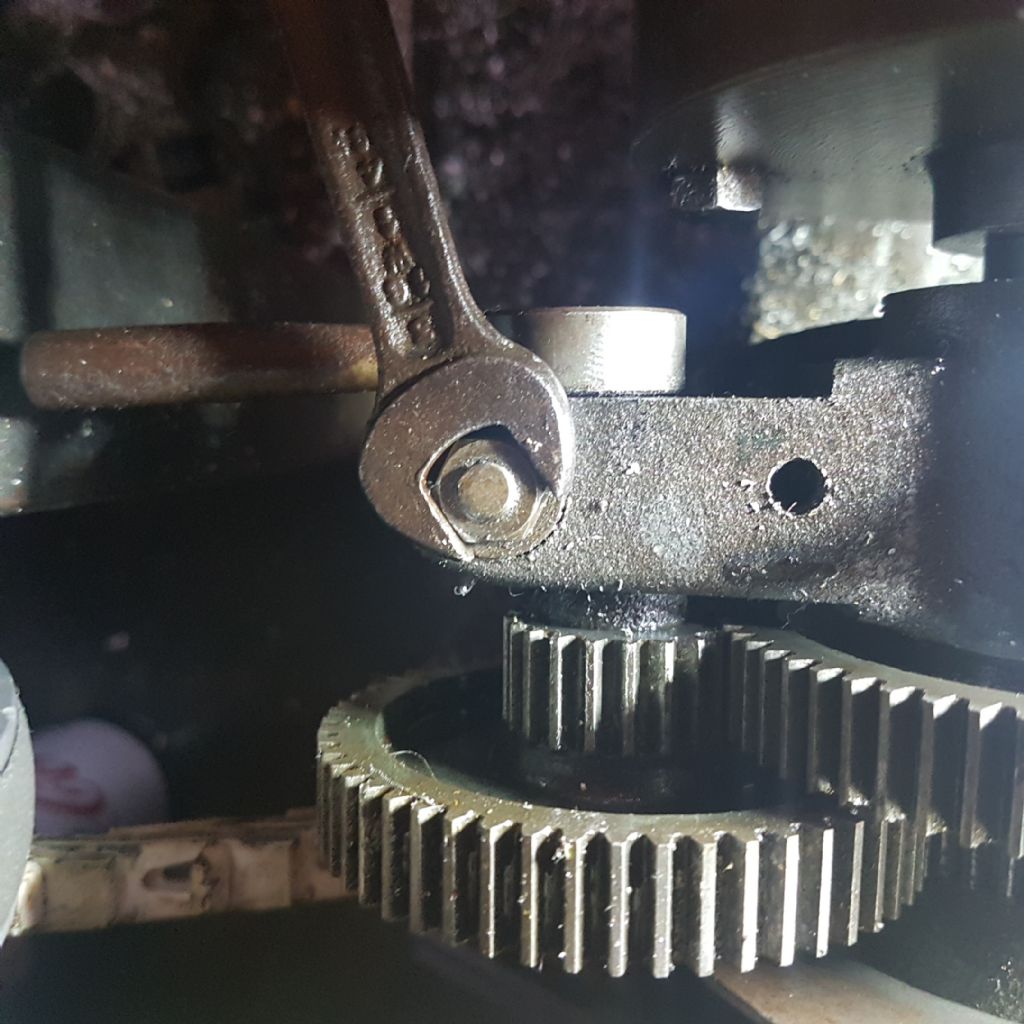

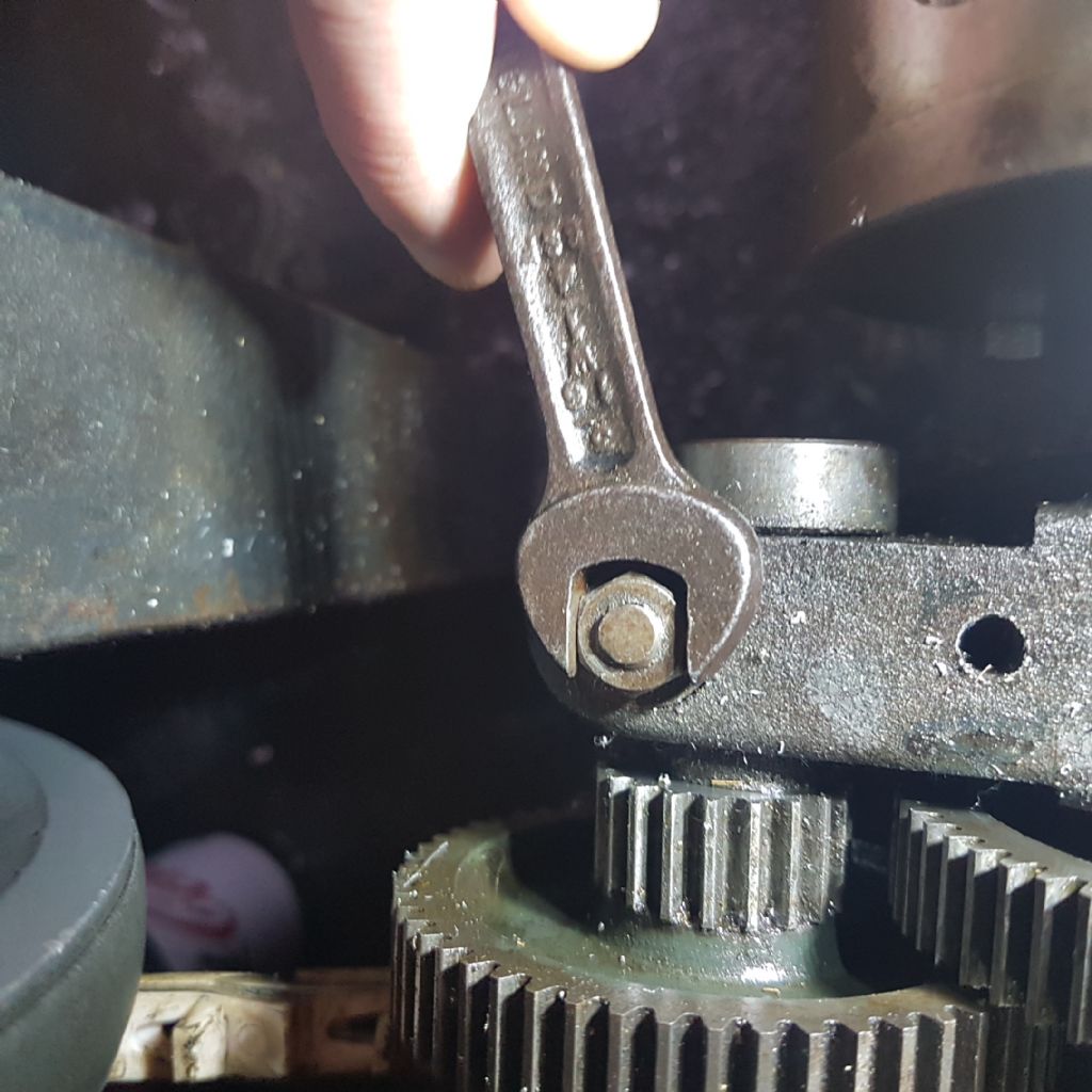

                    Then undo the 3/16" Whitworth bolt on the cam lever
                    Bring into mesh and tighten bolt again, (note position of cam in below photo).
                    This is your change gears as I seem to be causing confusion I'll clear it up. Though my point on your photo is still valid, you need to change that 18Tooth gear on the tumble reverse for a 20tooth gear, so your tumble reverse does not effect the gear ratio.

                      Jon I’m confused with the 18t wheel, as it’s in the middle of the gear train surely it doesn’t change the ratios?

                        You do know which photo I'm on about don't you in your album. You have labelled them up with the tooth count, but on the tumble reverse you have a 20tooth gear on one side of the gear, and 18tooth on the other. I have a spare tumble reverse from an ML7 and was planning to fit it at some point it has two 20tooth gears this way the gear ratios will be maintained in either direction of operation.

                          Right ok I was under the impression that if you had a gear train and the first and last were say 25t each, then it didn’t matter how many gears were in between or there size. It would still give a 1:1 ratio?

                            You are correct so long as there is not a reduction, and all the gears in between are just idler gears. But how you have it set up now if you decide to use a reduction gear train for screw cutting or fine feeds, then you'l be going quicker one way than the other.

                              I'm sorry but you are confusing the situation. The two tumbler reverse gears are idlers and have no effect on the gearing ratio, regard them as a belt linking two pulleys, it can be of any length The sizes in Martyn's reverser are correct, you would not be able to fit a 20t in place of the 18T.
                              Martyn's album picture shows a 20T gear linked to his erroneously labelled 26 tooth gear; which is in fact 25 teeth as we know know; that 20T gear is the MANDREL gear and forms the first gear in the drive chain down to the leadscrew.
                              Your pictures of the back gear clamp bolt to grip the eccentric were helpful, I had forgotten the exact arrangement there
