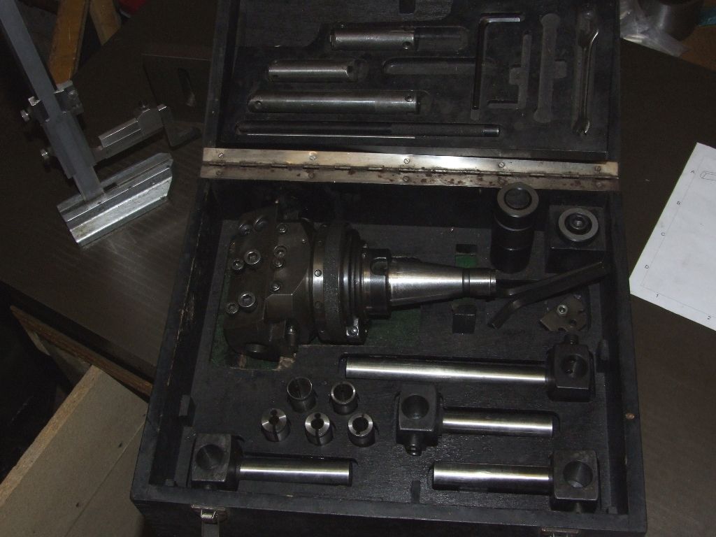

                                              Much simpler to just buy one and then you can use it straight away wink 2:
                                              For the cognoscenti it's a Wohlhaupter UPA4 boring and facing head on an INT40 taper with 12 feedrates, auto feed knock off and auto return.
                                              Cheque book engineering at its finest. thumbs up

                                                Just a budget one then Andrew, though you may have a D'andreawink 2
                                                #205602
                                                Anonymous
                                                  You have to take what comes along on the secondhand market; beggars can't be choosers. sad Mind you it did cost more than the horizontal mill on which it is used. crying 2
                                                  Andrew
                                                  #205603
                                                    I know a man with one for sale if you are feeling flush though only on a MT3
                                                    #205616
                                                    Bazyle
                                                      @bazyle
                                                      That'll be a UPA3 then which is more suitable for most model engineers. Strange that despite the cost Wohlhaupter make nice slots for the attachments but can't be bothered to make the wooden box actually support the head properly.
