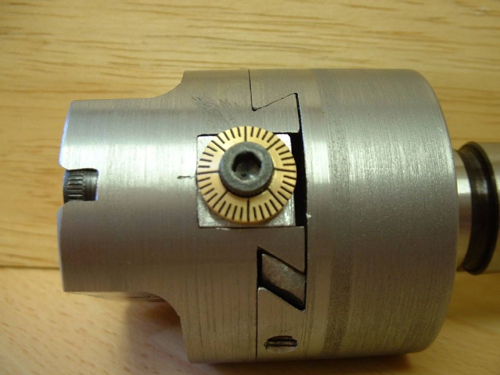

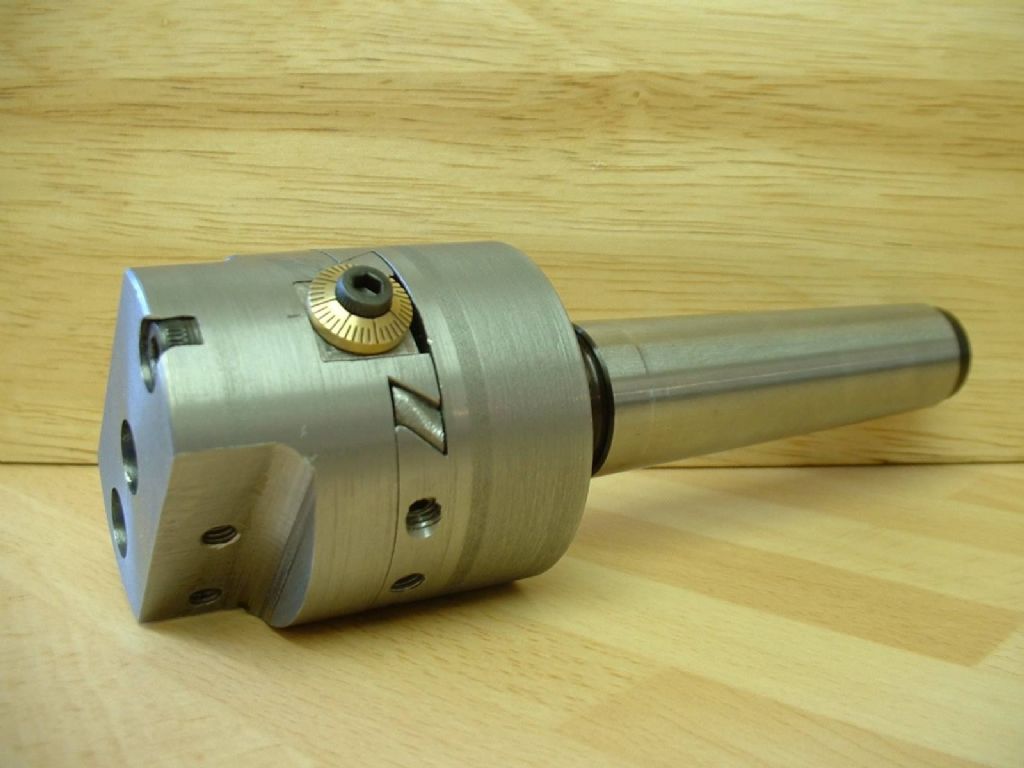

                                          I made one out of a length of 2" bar, so pretty small, but it works up to 3" plus and I've been pretty happy with it. the expensive parts were an MT3 arbour and a set of boring tools. No auto feed.
                                          never shared it before because I'm embarrassed that the hold for that damn screwhead broke out

                                            Posted by Neil Wyatt on 22/09/2015 17:34:05:
                                            Never shared it before because I'm embarrassed that the hold for that damn screw head broke out
                                            Bring it round, I'll weld it up. wink

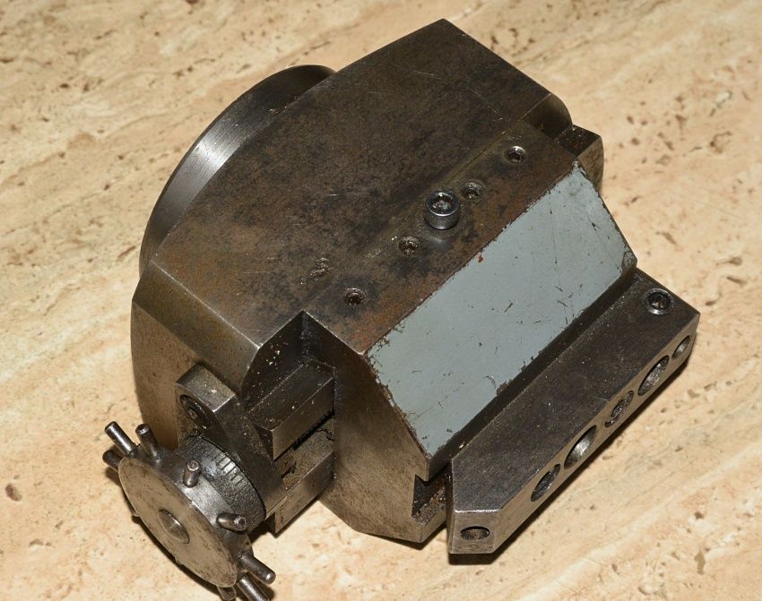

                                              This is the ME one.
                                              The pins are struck by a see saw like attachment with a pin on each end. It misses them when the see saw is level and has click locks to hold it in place when it isn't. I haven't used it for some time and should have rubbed some oil on it before taking the shot. The slight tarnish looks much worse than it is.
                                              The idea of the tool holder part is to allow it to be changed for say larger bores or what ever.
                                              The one in MEW had a collar round it that was simply grasped when facing was needed and could be locked up out of the way when not in use. I don't think mild steel is really a good idea for that sort of use but if needs must.
                                              I'd guess more recent ones don't use the hand to grasp it but lots did.

                                                Enough!
                                                  @enough
                                                  I'd have broken it right out and swore blind (if anyone commented) that it was intended to be that way.
                                                  #205379
                                                    That's what you get for using those nasty Metric Cap-Heads devil
                                                    #205389
                                                    Bruce Edney
                                                      @bruceedney59949
                                                      Do you have drawings you would be willing to share Neil? Or is the design a MEW or ME project?
