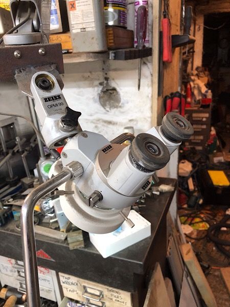

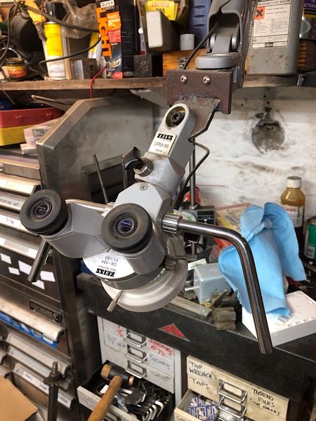

          I use a Zeiss operating theatre stereo microscope in my workshop mounted on a boom for the small things i do
          it works great
          I think that using a digital device means looking at a screen rather than live at your work /tool interface and there always seems to be latency problems with electronics

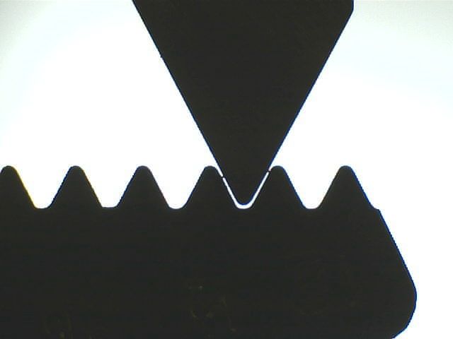

              The image here is of a 12 tpi whitworth thread gauge and ground
              form tool ,the USB microscope was from maplins so probably
              not so great as a precision instrument,but would you really want to use
              something more expensive in such a dirty enviroment.
              The image shows two places where dirt or swarf is bridging between
              the tool and gauge and this is after demagnitising and a good air blast
              i guess this is just static attraction and would be worse in a machining
              situation.
              The closer in you get to the job the more distortion you see in the image
              in this photo ,look at either end of the gauge .
              The obvious thing to do as you already have a microscope is give it a try
              and let us all know how you get on.

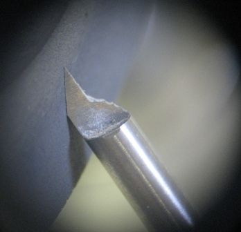

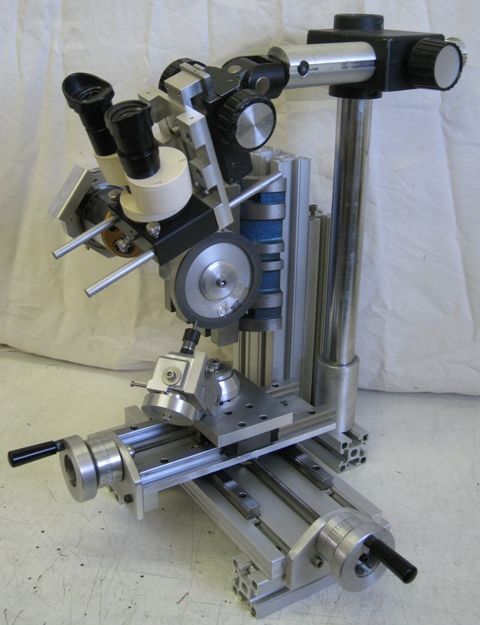

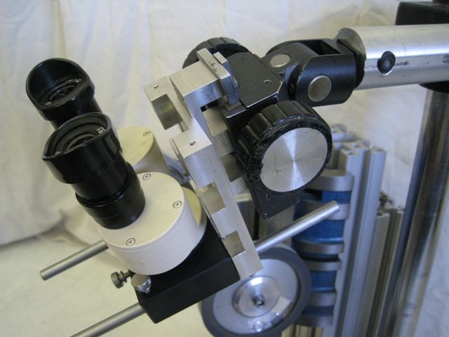

                      I tried, both on the lathe and on a small cutter grinder shaping very fine engraving tips. I did not manage well with the digital camera/microscope method. Using such a device requires that you select a type that does not have any image latency – most of the IP ( network type) camera have a good few hundred milliseconds latency which makes eye-hand coordination difficult and tedious – it is possible, but there is no room to maneuver and 'oops' reactions are interesting.
                      There are USB based cameras that have for practical purposes no latency, but there are three issues with any digital solution I find intolerable.
                      The image resolution is one – you should try for the highest pixel count you can – at least HD standard, NOT VGA…With low resolutions I found the specular artifacts drove me insane, with rapid onset of eye strain and headache.
                      The second is the difficulty in becoming accustomed to the misdirection between hand position and motion, and eye sightline. One is so accustomed to the hands on the handwheel in your peripheral vision, it takes a while to adapt. Not impossible, but when you only do a few jobs like this, I found it was like starting from scratch each time.
                      And last, for me the worst compromise – lack of depth of view – no 3D feeling – with a constant attempt to now and then 'look' around the corner to see the tool contact point better, etc.
                      I ditched all these – I did try no less than 5 systems, from VGA through to a 34Mpixel camera..- and settled for a decent 'analogue' Binocular Microscope.
                      This has its problems as well – it is always in the way when you want to take a visual of the workspace. You need a really decent support or suspension arm that is sturdy,vibration free, and easily manipulated with the ability to quickly swing it out of the way, and index it back in place.. But the viewing experience, with much improved mental and eye fatigue resistance, is in my opinion well worth it.
                      Photo of engraving tip through the microscope – hard to photograph!

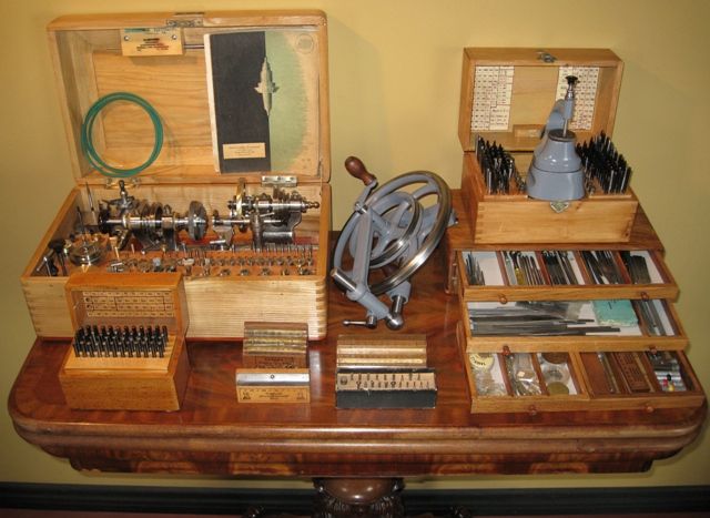

                      For interest, My late Father-in-Law – a German Watchmaker, used the little lathe pictured below to do what you are doing Chris – he used to do so by clamping various magnification jewellers Loupe to his eye, bend down low over the lathe and get on with it…

                                  Ian Parkin
                                    @ianparkin39383

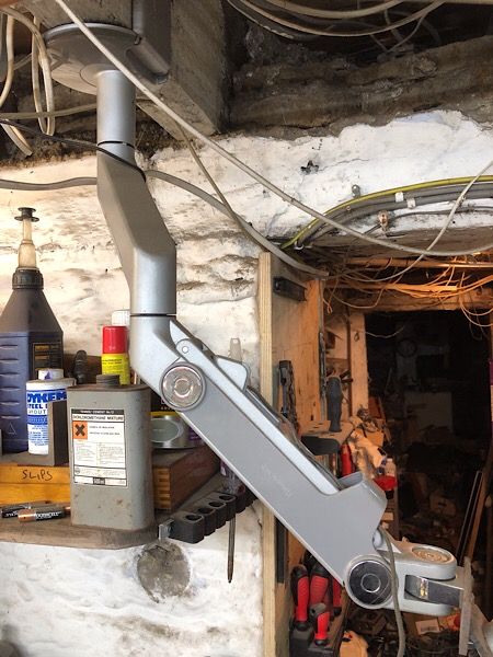

                                    This my scope mounted on a monitor stand clamped to the ceiling joists its easily moved to wherever i need it
                                    as i recall this was <£20 on eBay and stays where its put
                                    This scope has a working distance of 7 inches from the ring light and fills the frame with my fingernail
                                    Edited By Ian Parkin on 06/09/2019 12:28:02

                                        Posted by Ian Parkin on 06/09/2019 12:26:31:
                                        Great idea to adapt the TV boom Ian . How wibbly wobbly is it in use?
                                        Chris
                                        #427777
                                        Ian Parkin
                                          @ianparkin39383
                                          Well as i said it stays where its put
                                          its sprung and counterbalanced if you knock it it moves but it swings every which way and lifts up or down and stays where you want it
                                          I think this one was Very expensive new designed for a large heavy monitor on a desk
                                          Edited By Ian Parkin on 06/09/2019 12:41:46

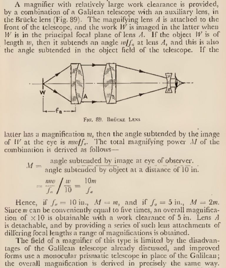

                                                … I was suggesting that you adapt the general concept of an 'overhead gantry' [as used with both horological and ornamental lathes] to mount your microscope.
                                                #427785
                                                BW
                                                  @bw
                                                  Are these things useful for us shed dwellers or do you have to crouch dangerously close to the spinning workpiece to get it focussed ?
                                                  Bill
                                                  #427788
                                                  BW
                                                    @bw
                                                    …… and this chap seems to have done a good job relevant to the original question.
                                                    #427791
                                                      Posted by BW on 06/09/2019 13:27:17:
                                                      I'm not sure about those ones, Bill
                                                      But the exepensive ones that Surgeons and Dentists use are based on this optical principle:
                                                      and allow them to work comfortably.
                                                      Note: In the Surgical Loupes, the supplementary lens is chosen to optimise the working distance [which is equal to its focal length] … Dentists typically work closer than Cardiac Surgeons.
                                                      Edited By Michael Gilligan on 06/09/2019 13:55:44
