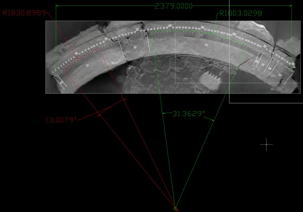

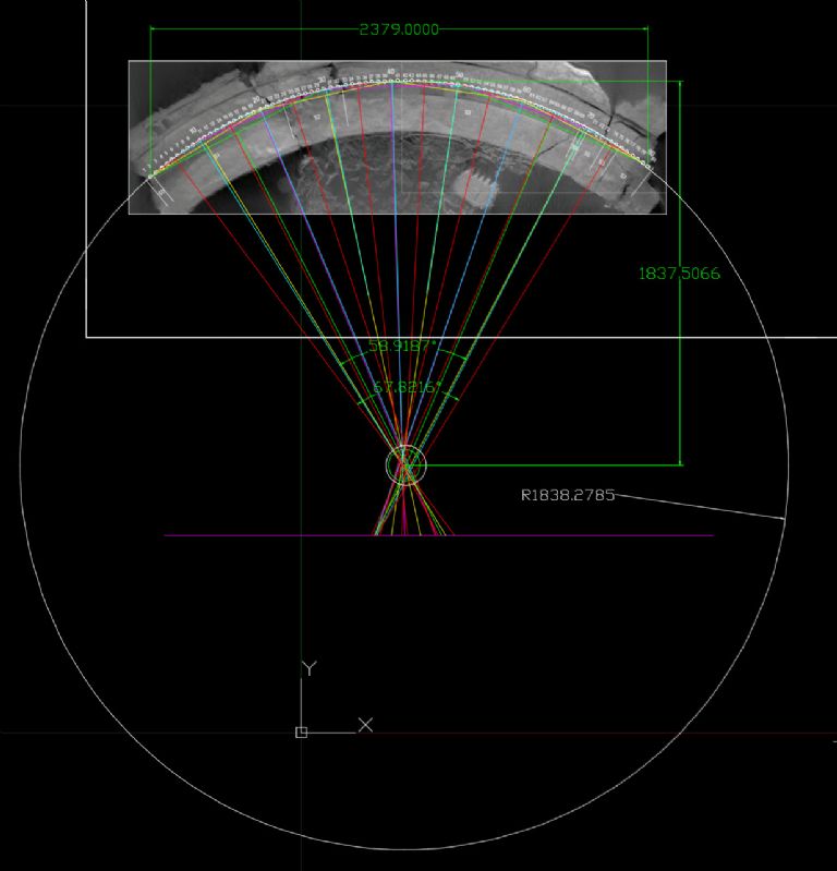

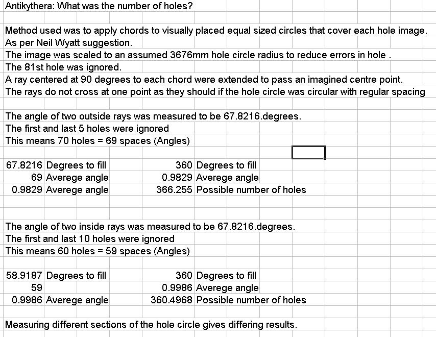

Hi All
Yes I am still around double Vaxed and healthy! I must however admit I will be happy to see the end of 2021.
Thought I would have a think on the problem and try to resolve it with CAD.
These are my findings, also in my Album.
Somewhere between 360 and 366 segments
Maybe this could be refined a little but with a distorted part it would still be a guess.
I hope I got the calculations correct.

Your results differ greatly from mine; but I think this only goes to prove how difficult [near impossible] this exercise really is. … ‘non-trivial’ doesn’t even begin to describe it.

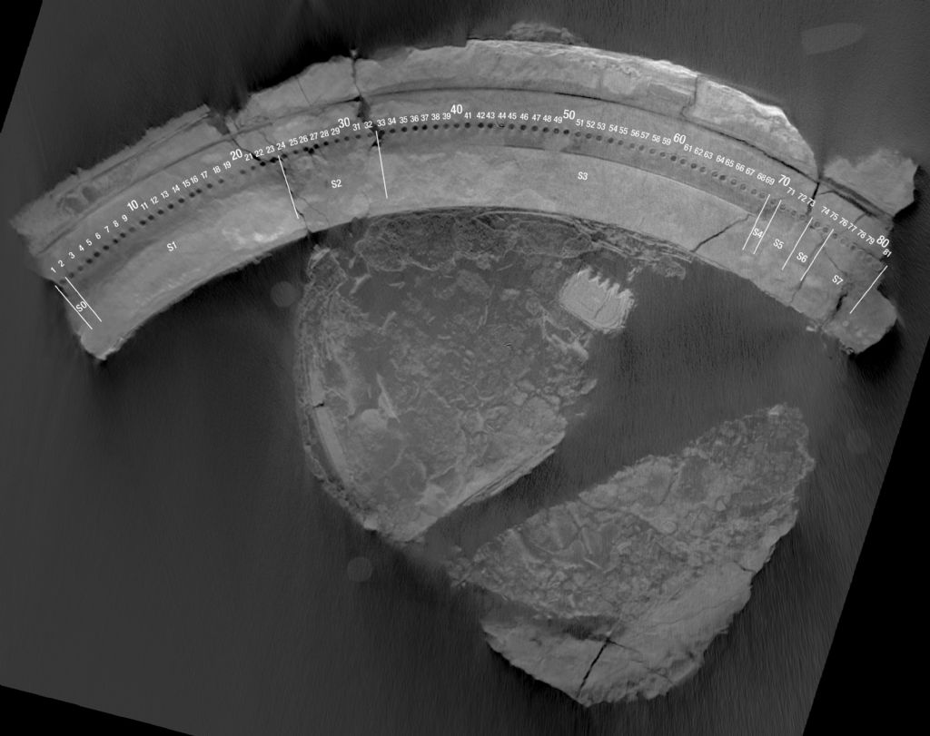

IMAGE. The image mostly being used in this thread is of poor quality and suffers from being a composite (as some have noted), being low print resolution, and not accounting for parallax error. The original scans were high-resolution (0.05 mm) X-ray computed tomography (CT) imaging and performed in 2005. I note an assumption in the thread that there must be better images of the Mechanism by now, but there are not. The AMRP and the National Archaeological Museum are, understandably, very protective of the Mechanism's fragile remains. In fact, when the images were made in 2005, the CT machines (quite large) had to be shipped to the Mechanism rather than vice versa.
The CT scans are a set of data points in three dimensions so need to be rendered. When rendering, one can select the plane of view and get a stack of images representing the Z axis for that rendering. Each image in the stack, therefore, has an X and Y axis. We were very fortunate to obtain two sets of renderings from our co-author, Andrew Ramsey, who personally lead the imaging portion in 2005 and captured the original data. (Interestingly, after 2,000 years, Andrew was the first person to see the ephemera engravings in the images of the Mechanism.) Our first set of renderings (about 1900 image layers, about 18 GB) was used to measure the plane of the channel in which the holes are drilled. From this we gave Andrew the specific plane to render to align the channel to the viewing plane, thus minimizing parallax error. Without Andrew's guidance and assistance, we could have not achieved a level of accuracy sufficient to draw a statistical conclusion.
I see a more recent post using our image but I'd again caution against that as though it is planar, it is a lower-resolution publishable version and a composite. You'll get closer measurements to ours than using the other image, but not close enough to, in my view, warrant the time. Our data are freely available and can save you a lot of time. =

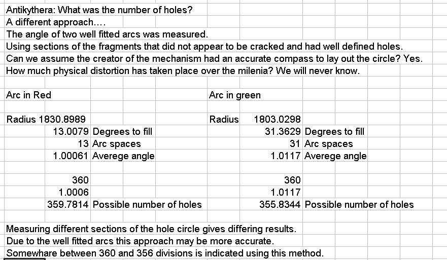

Hi All
Using the second set of observations I made shown in green I calculated 355,83deg. This used the larger fragment with no visible cracking. I guess this larger fragment offers the best approximation accuracy available.
The method used was to visually place small circles over the “points” then apply an arc over the circles using eyeball best fit analysis.
Can we assume the points were holes? If they are holes I would be very interested to know if the “silt” mentioned previously by Drewt contained iron, particularly at the bottom of the holes? Maybe this would suggest pins protruding that might suggest a pin gear.
Getting back to the method. I would like to try it on the best available known image. If available online I would appreciate a link. I will repeat my test using this image.
I am somewhat confused by the apparent inaccuracy of some of the points, I firmly believe that a person capable of constructing this mechanism will have been capable of better hole placement.
Maybe we should ignore certain outliers from the calculations. Local corrosion might possibly have moved the apparent hole in the substrate.
Additionally, there is the possibility of larger (not visible) cracks deforming the substrate.
I look forward to a retest on a better image if found.

Attached is our Figure 2, a composite that is planar to the channel and decent (but not full) resolution. For imaging, the next step up from this is the rendered CT files. 8.9 MB per image, hundreds of images just to cover the holes' depth.
John,
It's for sure not iron and there are pretty good explanations of how/why the holes would have been used. Chris, for example, describes a very plausible use in the BHI article, part #2. In discussing the Mechanism with Andrew Ramsey, who took the CT scans, he felt there was even very little bronze left (much less if it was iron) as the metal has been chemically substituted over the centuries. There are a couple of papers about this process along with tests on bronze in seawater. This is not an area I know a lot about, but it's pretty clear the channel was designed to have the calendar ring ride in it and the holes were for alignment. Chris provides, in my view, an excellent explanation as a possibility.
I have attached, to the previous post, the best available single image. Feel free to use it but it is copyrighted material so citing the BHI article would be required if it was used to publish. Beyond this image, as noted in that post, the next step up in quality is a big one with hundreds of 8.9 MB images, each a 0.05 mm slice of the Mechanism.
