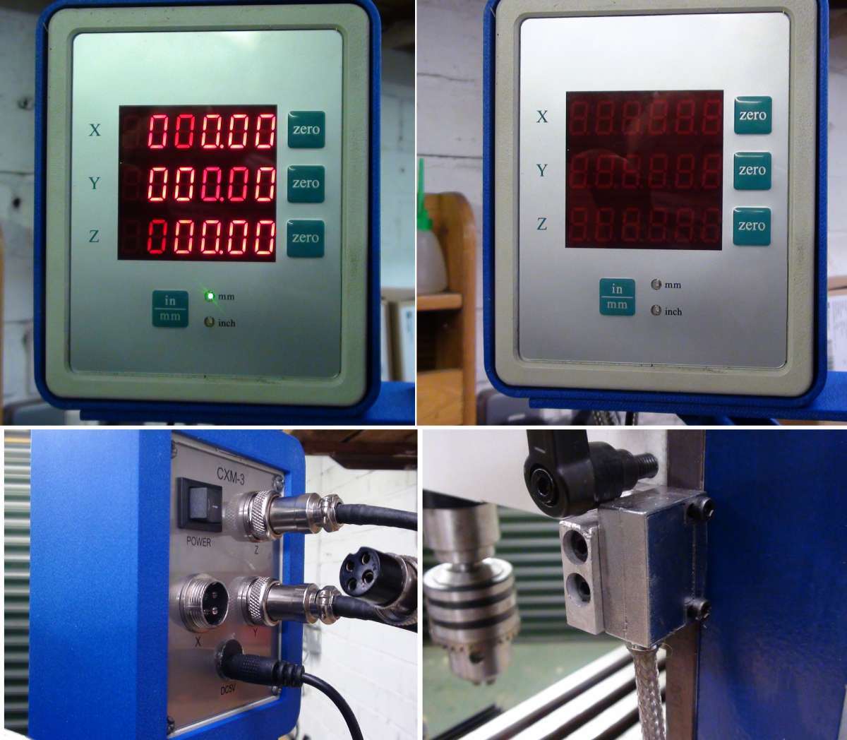

      After many months of soul-searching and cogitation, I have recently scratched my itch to acquire a mill.  Having down-sized my workshop a couple of years ago, I have purchased an Amadeal XJ12-300 Mini Mill with R8 spindle, gas strut-assisted head lift and fitted with a DRO.  It arrived last Wednesday, as did a new bench to keep it off the garage floor.  On Friday, with help from another forum member and a next-door neighbour it was lifted onto the bench.
      Now, at last, to my question.  The DRO system as fitted “does exactly what it says on the tin”, in as much as it measures movement of the head and table in three axes and displays that motion on the screen. That’s all it does.  No ½ distance calculator, no PCD function or any of the other bells and whistles that higher end displays feature.  No moans from me about the system as supplied – I knew what I was ordering and got what I paid for and am happy to work with it for the time being.  I should add that the scales are magnetic and therefore of small dimensions and ideal for the size of mill, but the leads terminate with 4-pin aviation-style plugs, not the normal 9-pin D-plugs.
      Soon, I want to replace the display with something more “fancy” and as I see it, I have a few alternative routes to follow:
      1)  just replace the display with one like the Ditron D80 and rewire the existing plugs into 9-pin D-plugs, or
      2)  buy a complete kit from cousin Ali and his Express team and discard the existing system (possibly utilise it on the lathe), or
      3)  get myself a ready-built TouchDRO from Yuri and add an Android tablet?
      If simply changing the plug terminations to 9-pin ones and attaching to a new display will work, I favour route 1.  I would rather avoid route 2, if possible on the grounds of cost and added complication.  Route 3 appeals for many reasons including its wide user base.  It’s not a cheap item and I’d have to purchase an Android tablet – but they are readily available on various auction sites.
      Does anybody know, or have a good inkling, if the TTL 4-wire output from the fitted scales will connect to and work with either a new whizzed-up display, or the TouchDRO interface?

        Can you post pictures of the display, scales and connectors?

          Thank you for your offer of assistance.  Below is a montage of the photos requested. The read heads themselves are approximately 30mm x 23mm x 13mm.  The only maker’s reference that I can find is on the back of the display – “CXM-3”.  Googling that only brings up a Czech web site which appears to market them with no technical info that I could find.  And a USA pdf showing how to connect all the leads to the display, as if that wasn’t obvious. Any other queries ask and I will try to answer them.
          DRO pics

            As you say, those connectors are unusual for dro scales. I suppose no matter what you do, you will have to do some testing to identify the ground and 5v pins. The other two pins will be the A and B signal pins. If I understand correctly, these will be a square wave signal offset by 90degrees.
            This is a link to a page on the TouchDRO website explaining the connections:
            https://www.touchdro.com/resources/scales/glass/glass-scale-pinout.html
            You should be able to make adaptors for a Ditron or other readout with this information.
            I made my two TouchDRO adapters a few years ago using an Arduino on veroboard. For the first one, I used cheap digital calipers. For the second one I had bought some scales with individual readouts from Arceurotrade but found the display too small, so made an adapter to use TouchDRO and a very cheap Android tablet.
            Looking at the TouchDRO website now, you can buy a ready built unit or diy kit or build your own from scratch.
            I suppose it depends how much you want to spend!
            Stuart

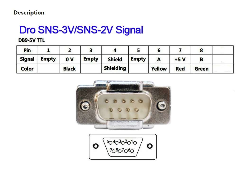

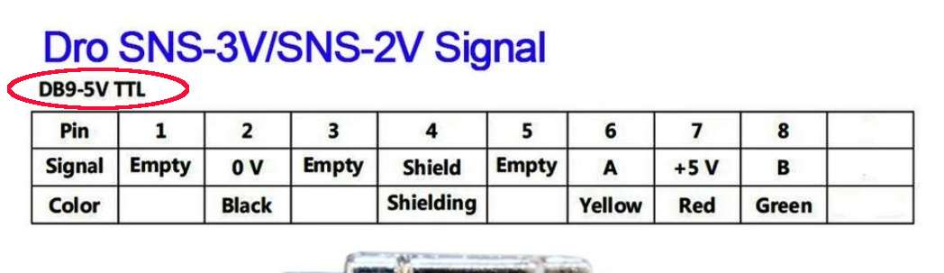

                        Just a quick update to this posting.  While perusing the Aliexpress web site a couple of days ago, I noticed a DRO display on offer for less than £40 , so I thought I’d take a punt.  This is the unit and the pinout diagram:
                        DRO display - package contents  DRO display - pinout details
                        I’ll maybe order a couple of suitable connectors and make up a cable to link this display to one of my existing sensors and see what happens. I’ll post the results on here later. (When the smoke has cleared!)
