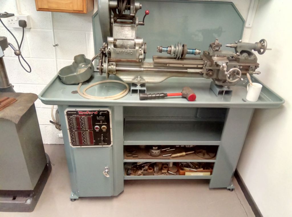

      I recently purchased a Myford Industrial cabinet (version for a Long bed), however when I retrieved my 1948 ML7 from my parents house to put on it it became apparent that it's worn out and needs quite a bit spent on it. Therefore I am considering buying another lathe as it's probably more cost effective than reconditioning it.
      As Super 7's are beyond my budget at the moment does anyone have any experience of fitting other makes of bench lathes ideally with a larger swing on to this cabinet?
      Could do with obtaining an understanding what has worked for someone previously, I am 6' tall so can cope with it being a bit higher. Otherwise I will needs to consider selling on the cabinet but I am reluctant as I have repainted it.

          Height is not a problem. Just fit raising blocks in the form of heavy-wall square tubing between cabinet and lathe as needed. Or blocks under the feet of the cabinet.
          Length of a Myford longbed should accommodate any of the Chinese lathes with a similar swing and centre distance. Their sellers' websites usually have all the specs posted. The popular Sieg SC4 should drop on there with room to spare at 1 metre overall length. You might even be able to go a bit bigger if you shop around.

                            When you get a lathe to fit the cabinet, you will know how thick the raising blocks will need to be for comfort. You have two choices, raise the cabinet, or raise the lathe on the cabinet, the latter would need metal blocks drilled to fit both parts. Or a bit of both. I got the Smart & Brown at the museum lifted up by Rod using the forklift and a 40mm thick prefabricated wood plinth put underneath, it hasn't budged since, despite not being bolted down. The Tom Senior mill is also on a wooden plinth, but is bolted down.

                              When you make tour raising blocks from box section, consider mounting the lathe on studs with a load of nuts.
                              The first nut is inside the cabinet, the second nut is inside, on the bottom of the box section. The third nut is inside the, at the top of the section. The fourth nut is outside the box section. The sixth nut is above the fifth one, with the foot of the lathe resting on it. The seventh nut is above the the foot of the lathe.
                              In this way, the box section is firmly clamped to the cabinet. The upper two nuts clamp the stud to the box section, and carry the weight of the lathe, minimising risk of the box section distorting. The nuts above and below the foot of the lathe allow the lathe to be adjusted to remove any twist from the bed.
                              This should ensure that you do not turn any tapers, inadvertently!
                              Basically, my 300Kg lathe is supported by six 1/2 UNF setscews, in this way, without problems!

                                Below is a picture of the cabinet with the ML7 on it.
                                The flat area of the tray is 4'4" * 17" In this space I have 5' * 2'8" that could be used if some of the lathe were to overhang. The person I bought it of did say they had had a Raglen on it but I am not sure I would get on with one.
                                As can also be seen I begun to investigating reconditioning it. When turning my test piece to finish setting the leveling jacks at the back it was 0.1 mm out over 125 mm there was also chatter and 0.1 mm movement in the headstock. So I abandoned the leveling and blued up the bearings with a view to scraping them. Also got a quote for a new hardened spindle and bronze bearings at £325 if it does now work. As its a 1948 machine and could also do with a bed regrind I started to explore the options of what else would fit on the stand, possibly a larger machine.

                                  Whatever you mount on the stand, do allow space behind the Headstock for material passed through the Mandrel to hang out the back. without fouling the other machine
                                  Also allow just enough room to remove the Tailstock, if you ever need to do so for any reason. It would be pretty galling, having once levelled the machine to have to undo all that work because the Tailstock needed removing for some reason!

                                    Have you measured the actual bed wear? Myford allows up to five thou on the top of the way before it's considered worn out.
                                    And three thou on the vertical rear face of the front way, the one that takes most load. However, you can get around this on a 1948 model by doing a wide guide conversion, as described in detail in the current issue of MEW. Its a simple job.And no need for a regrind.
                                    Headstock bearings might just need a couple of layers peeling off the shim packs that go between the bearing halves.
