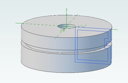

                      #327012
                      Anonymous
                        Posted by duncan webster on 13/11/2017 09:51:00:
                        Andrew, I doubt you can make a bronze piston 1.25" OD * 1/4" ID * 0.5 thick, with a rim thick enough for an o-ring groove that would be lighter than a solid ally one.
                        I don't know, you haven't given enough information for a proper design. smile
                        Andrew
                        #327019
                          You could just about do it with 1mm wall top and bottom and 0.8mm on the verticals, I would think that being a lot smaller than Andrew's the stiffening webs would not be required and would need to be silver soldered together rather than threaded. 25g all up weight for bronze and same for solid 6061
                          Blue line shows the section.
                          Edited By JasonB on 13/11/2017 20:56:41
                          #327119
                          duncan webster 1
                            @duncanwebster1
                            Following the advice given I've had a rethink. The original drawing shows one off 1/8" section o-ring, so I can reduce the piston to ~5/16 thick, then put a groove in both sides 7/8" OD, 3/8" ID 7/64" deep. This gets the mass down by factor ~2.5, that will do for me. I'll put packers on the covers to take up the extra clearance volume. I'd rather not take the risk of seized piston. I'll use the ally to make some new crossheads.
                            Edited By duncan webster on 14/11/2017 14:04:50
