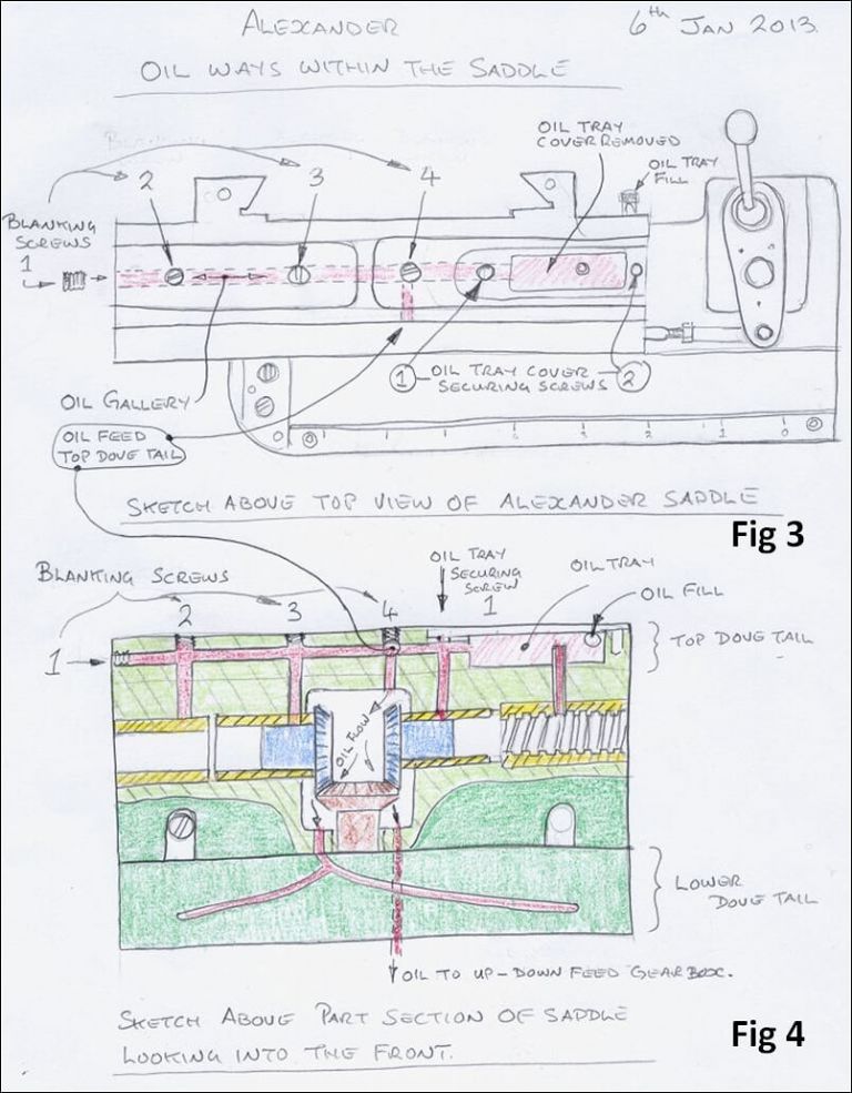

                    Well done. I would advise you to put new oil wicks in any place you can and thoroughly clean out everything first . The wicks in mine were totally blocked with gunk and all hardened so no oil gets through.
                    There are wicks all over the place . The all mechanism connected to the joystick lever in mine was particularly bad for dirt and tiny metal particles.
                    The wick channels are not exactly like the Deckel FP1.
                    Edited By mark smith 20 on 24/12/2019 00:14:04
                    #443069
                    David Broadbent
                      @davidbroadbent33226
                      What a cracking sketch! Thankyou for that. I am particularly interested in the oil way that has some effect on the sightglass behind the saddle. I have been unable to make any impression on the sightglass irrespective of oil sent down the oil cap so had already decided to give the whole thing a birthday before it goes back together. Regarding wicks – from where can they be bought?
                      The whole thing has gone to my head really. I am not the polishing kind of chap – preferring functionality over bling, but your pictures of a seriously well restored machine – and the fact that my workshop currently looks like an explosion in an Alexander factory, it would be the ideal time to give everything a clean and a paint….
                      Have a good Christmas – hostilities will resume shortly thereafter!

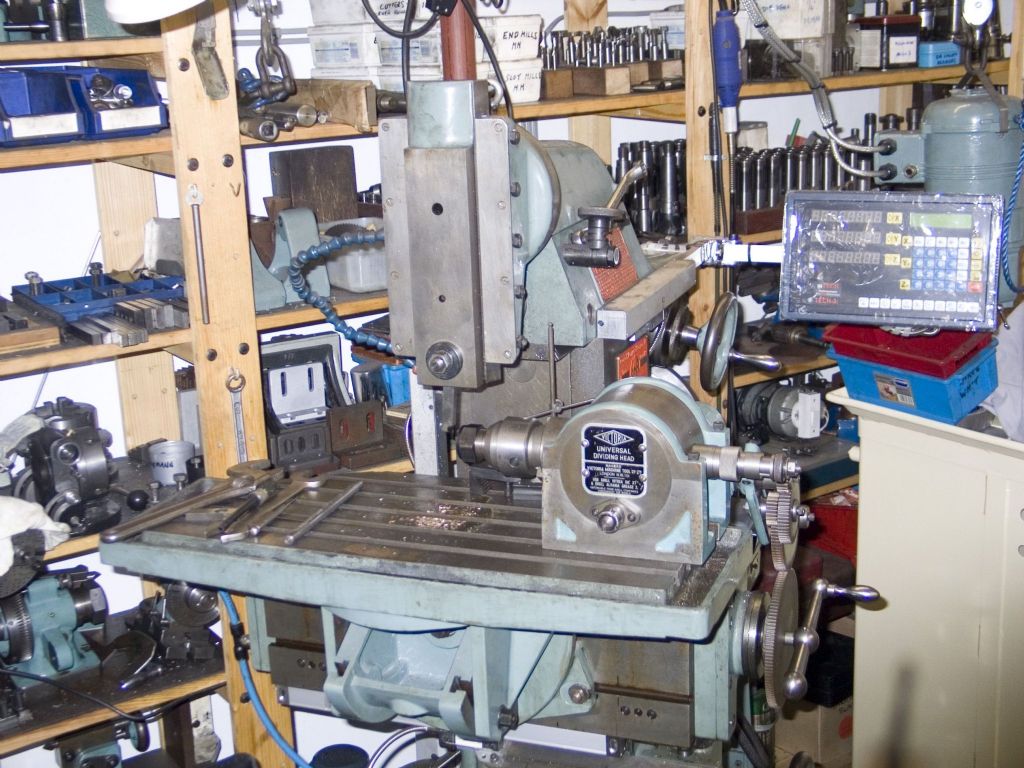

                        You have probably already found some photo's of my Alexander, but here is one for some inspiration. The machine was my late fathers and he rigged it up to use for gear cutting using the Sunderland principle.
                        A few more in my albums
                        This is one of my set ups for shaping a 3 lobe spiral claw coupling for the barring engine on Agnes.
                        Phil

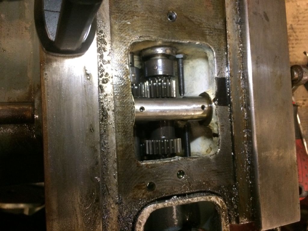

                                    I have now discovered the second vertical dog clutch. Progress is slow at the moment with lots of house guests etc limiting the time one can spend in the garage. Having found it however it also seems as though the detent lever that selects up or down is somehow astray? It sits against the threaded stop in one direction (DOWN) but stops well short of the other? I think its the UP selection which is currently not engaging the lower dog clutch. I need to explore further as I suspect it may be a result of the siezed bevel gear causing excessive and repeated load in one direction only?
                                    #443868
                                    David Broadbent
                                      I have now managed to steal an hour away from Grandfatherly duties to get oily. I think I have discovered the second problem I have with the mill. Although when I first got it going, it would power up and down quite easily, but that facility ceased. Now as I examine it I can see why. When the hand control selects DOWN, the upper dog is engaged . However, the detent device is only in the mid position, confirmed by the mechanism being equidistant from both threaded end stops. When the lever is knocked back to neutral, the upper dog is disengaged, but the detent device is then hard up against the lower threaded stop – so there is no ability to select UP and engage the lower dogclutch.
                                      The cause appears to be that the shaft has somehow moved down the machine! There is a gap of about 4mm between the upper dog and the machine casting, whereas the lower dog has almost disappeared from view – perhaps flush with the machine casting at the lower end. How it can have done this is baffling as both dogs appeared to be pinned to the shaft, it shows no sign of wanting to move any further – and the bevel gear at the very top of the shaft is still in deep mesh with its cross slide counterparts! Seems like this shaft is the next thing to have to remove form the carriage!
                                      I will add a couple of relevant pics to the growing gallery and await your comments.
                                      #443871
                                      David Broadbent
                                        I think this is the most telling shot – the 4mm gap above the upper dog clutch.
                                        #443899
                                        David Broadbent
                                          I thought I would continue tinkering and started to strip out the motor drive shaft, first by knocking the pins out of the dog clutches and then from the bevel gear at the top of the nut to try and fix the problem. The dog clutch pin moved nicely but the bevel gear one is solid. Reluctant to hit anything too hard until all possible alternatives are exhausted I cast about a bit for other opportunities. Out of curiosity I took a copper mallet and tapped the botton of the motor shaft – and it moved! A couple more taps and the 4mm gap in the photo had disappeared! (I hadn't removed the dog clutch pins at his point, just tapped them about a mm loose) Immediately I could get UP neutral and DOWN on the select lever and everything thing was meshing and spinning wonderfully. Remarkably the bevel gear had not moved at all! It clearly has a taper pin holding it on the end of the shaft, but it appears that this pin must run in some kind of slot?
                                          I tapped all pins back in as they had been and the whole system works fine! Presumably the pin has failed that secures the bevel on to the drive shaft, presumably due to the motor drive trying to raise the table but the rusted bevel stopping any upward movement – so the drive shaft was pulled down instead and sheared that upper bevel pin?
                                          I think I now need to apply myself to drilling out the upper bevel pin (now it is in roughly the correct location on the shaft) , and try and get the shaft out of the machine to replace the taper pin? This is not going to be easy, but it's the sort of thing that would work really nicely until the nachine was boxed back up again – only to allow the bevel to freewheel merrily the first time the power drive was engaged!
                                          Can anyone confirm with me that all I need to do in order to withdraw the shaft is to remove the pins in the top bevel gear, upper and lower dog clutches and the shaft should then just pull down out of the carriage?
                                          Never a dull moment.
                                              Exactly how do you know the bevel pin is in the correct position, to drill it out, if you cannot see it? Roughly is not near enough. I would suggest you move the bevel sufficiently before simply tapping out the broken pin from the shaft, thereby avoiding drilling into the shaft. Removal of the bevel drive (no longer pinned to the shaft) will allow the broken pin to be tapped out without any drilling
                                              I don’t think I have ever come across a tapered pin running in a slot, so a new one on me.
                                              #443969
                                              Phil P
                                                @philp

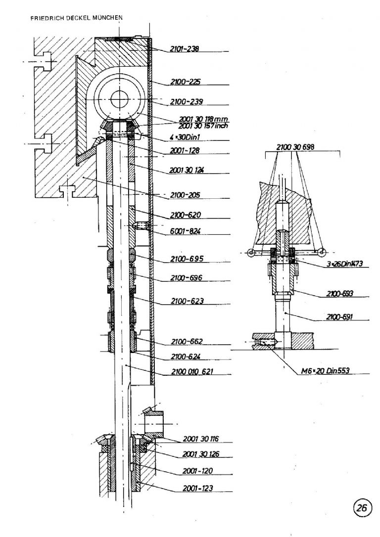

                                                A cross section of the Deckel FP1 is the same as an Alexander.
                                                I think if the shaft had dropped a few millimetres, that would mean it was already coming adrift from the bevel gear.
                                                So if the pin has indeed already sheared the shaft will probably drop out of the bevel gear fairly easily once the other pins are removed, after which you can remove the remains of the pin as described by NDIY above.
                                                Phil

                                                  Well the shaft actually moved quite well after a tap, so I was hugely relieved and quite optimistic about getting it out of the bevel without much further effort. The problem of course is that you cannot actually get behind it with a drift to tap the shaft back down again! I wasn't actually being serious by the way when I suggested that the bevel gear pin must be running in a slot to allow for such movement on the shaft.
                                                  My outline plan was to knock out the pin in the upper dog clutch and then hope the shaft can be persuaded to slide down through the detent mechanism on its way to freedom? The diagram you have posted seems to confirm this?
                                                  The job will be tackled in the morning – before the next wave of family turn up for the New Year celebration!
                                                  #443988
                                                  not done it yet
                                                    @notdoneityet
                                                    Really?
                                                    #444042
                                                    David Broadbent
                                                      Yippee! The shaft was extracted this morning and remains of taper pins also safely extracted. All I need now is a new taper pin to replace the old one and I can start the reassembly. The Deckel handbook identifies the pin as a "4 x 30 Din 1" which would probably not be far away but would be a different taper than an Imperial pin? Measuring the holes in the bevel gear seems to suggest 11/64" x 1 1/8" as the nearest fractional imperial size, so it looks like a job for the old Raglan – unless anyone knows where such a thing might be bought in quantities of less than 100?
                                                      Thanks again for all the help and advice given on this forum,
