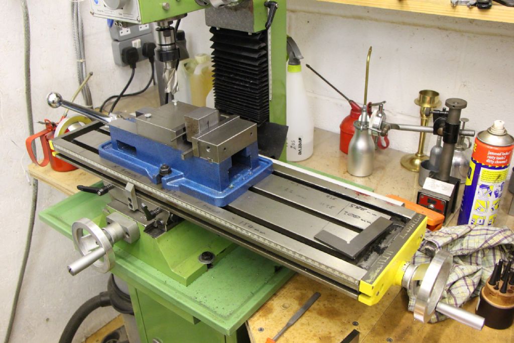

        Tony Marshall
          @tonymarshall12301
          Addendum to previous post – the old (smaller) vice is a Warco 5478. The pic below shows the new vice in its final resting place. Swivel base removed – just too bulky. As an added bonus the mounting points suit the table slot spacing!
          Good luck,
          Tony

            Posted by Tony Marshall on 21/01/2017 12:13:07:
            Good luck,
            Tony
            I never use the swivel function on mine either! very nicely done too. Looks right at home on that Mill.

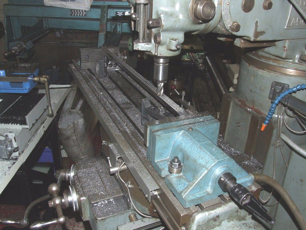

                    Commercial two part vices are fairly cheap, although I bought mine secondhand. Actually I bought two for £60 and sold one set for £30. I've used mine once:
                    A disadvantage of the commercial ones is that you need a large mill; it only just fitted on the Bridgeport. Another, more serious issue, is that if you overtighten you end up distorting the mill table in bending.
                    Andrew

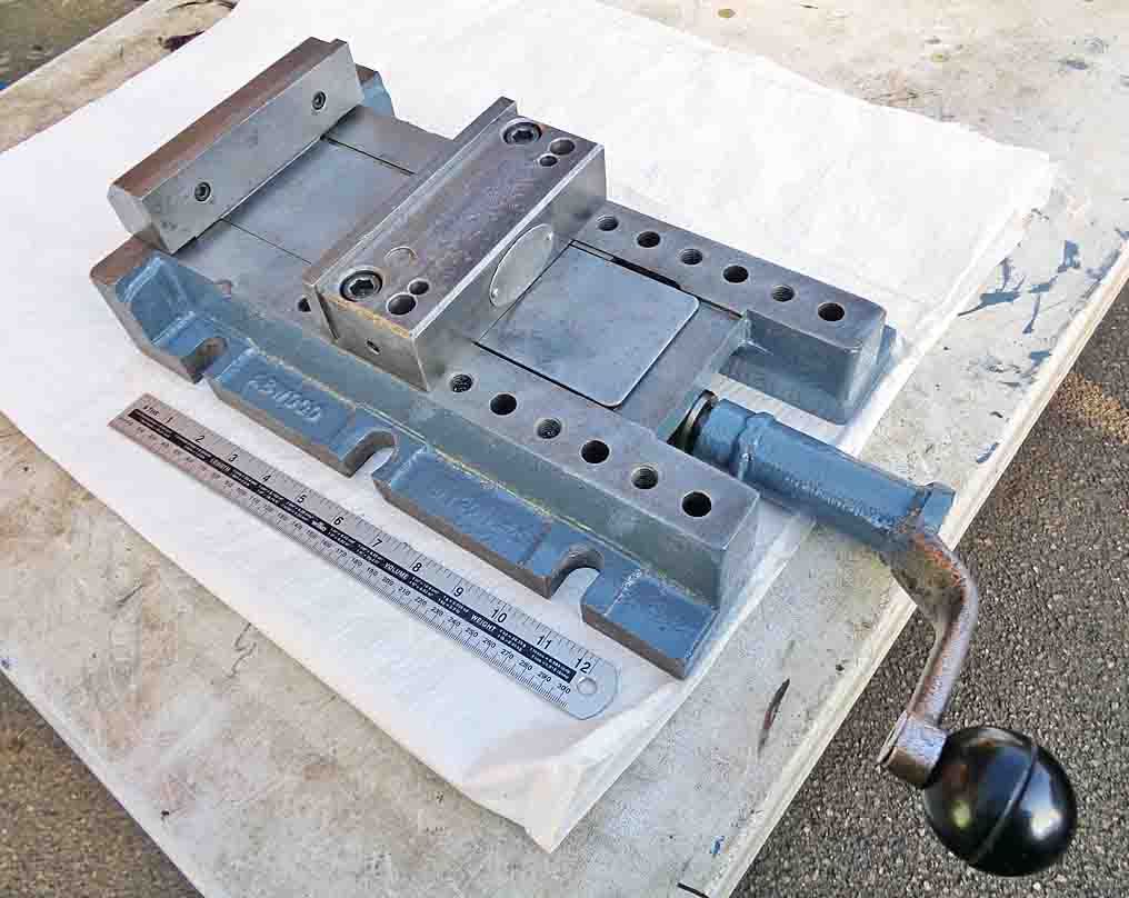

                                            I never got round to using the vice as I sold the mill so have put it up for sale in the classified
                                            #286768
                                            Martin King 2
                                              @martinking2
                                              6" ABWOOD ?
